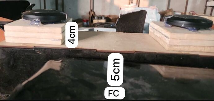

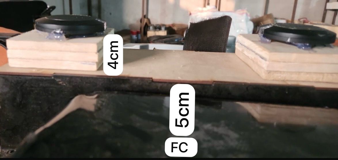

Yes can gps
Yes we have out boot delay already as mentioned by you previously here.
Tommorow we are testing with gps being slight more above than previous position more away from FC and Wiring hopefully that might sought out the gps 1/2 still configuring msgs if not then will try to put gps in can1 instead of can2 port
New position of gps (4cm is typo it’s 2.5cm)
