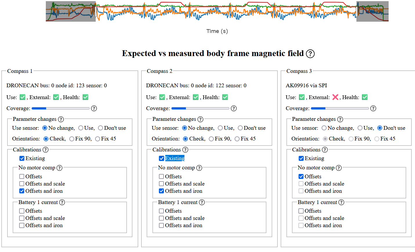

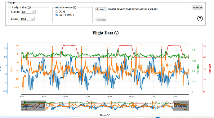

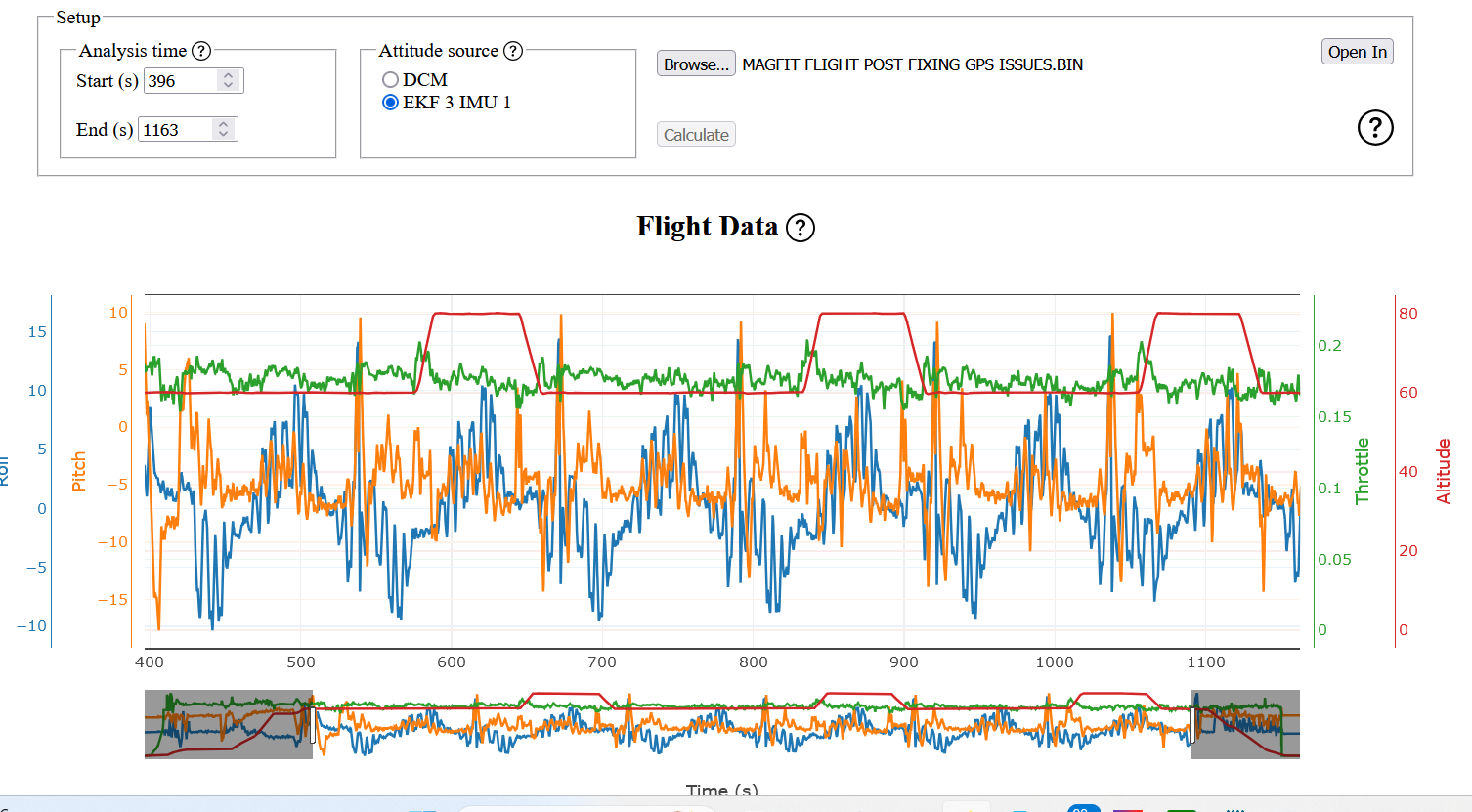

We did this fresh magfit flight after solving our gps and compass inconsistent issues. With the logbitmask you mentioned and made more sense
Have a look at the results if they are good then we can proceed to step 26 quick autotune in the ardupilot Methodic configurator.
Log - MAGFIT FLIGHT POST FIXING GPS ISSUES.BIN - Google Drive

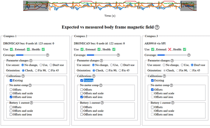

That gives a good magfit now.
Use offsets+iron, no motor comp.

but why are our values coming different @xfacta

The values are not identical but near enough. I used the whole log, however you selected just the Auto part of the log.
Use your values, and I agree with disabling the internal compass.
Great great so shall use these settings and start tomorrow again from post magfit results
