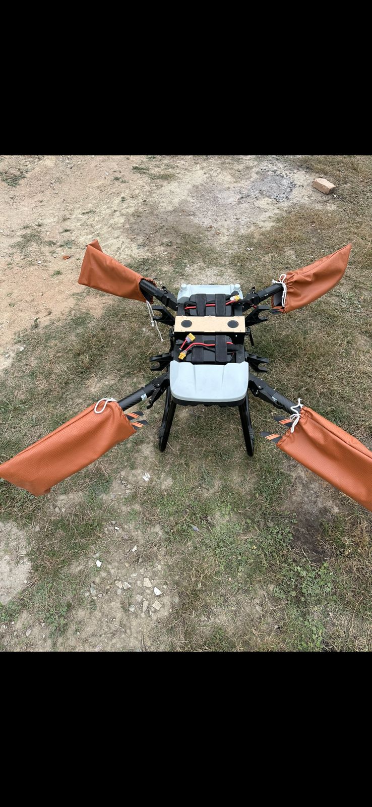

Quadcopter yaw during takeoff on ground(Solved)
So we did multiple tests because we were getting gps 1/2 still configuring.

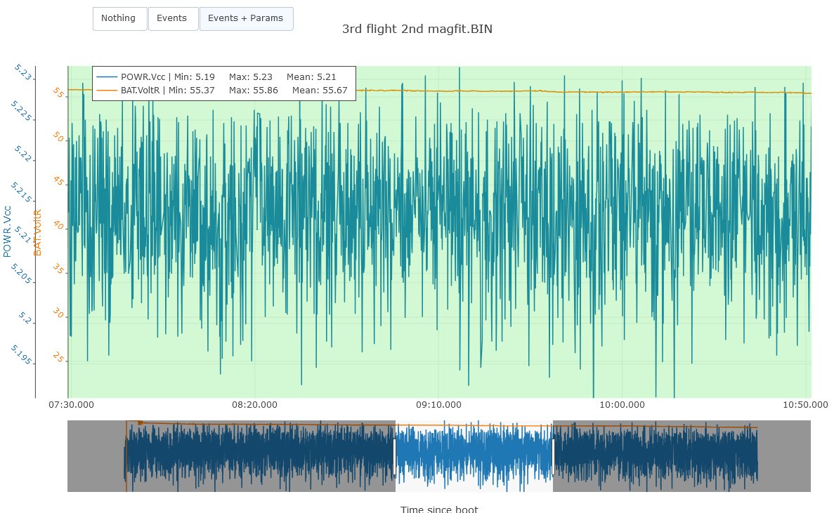

Test 1-
Volt meter reading from can splitter with both here 4 gps attached voltage ranging from 4.8-4.95( led lights blinking )
Test 2
Volt meter reading from can splitter with both here 4 gps attached voltage almost Static 4.90-4.94v ( led static no blinking )
Test 3
Volt meter reading from can splitter with both HERE3 gps attached, voltage is around 5v and above
Test 4
Powering can splitter externally from mauch giving 5.35v input to the splitter Volt meter reading from can splitter with both here 4 gps attached voltage ranging from 5.21.24v
Should I power the can splitter externally because here4 gps getting good constant power supply in this case.

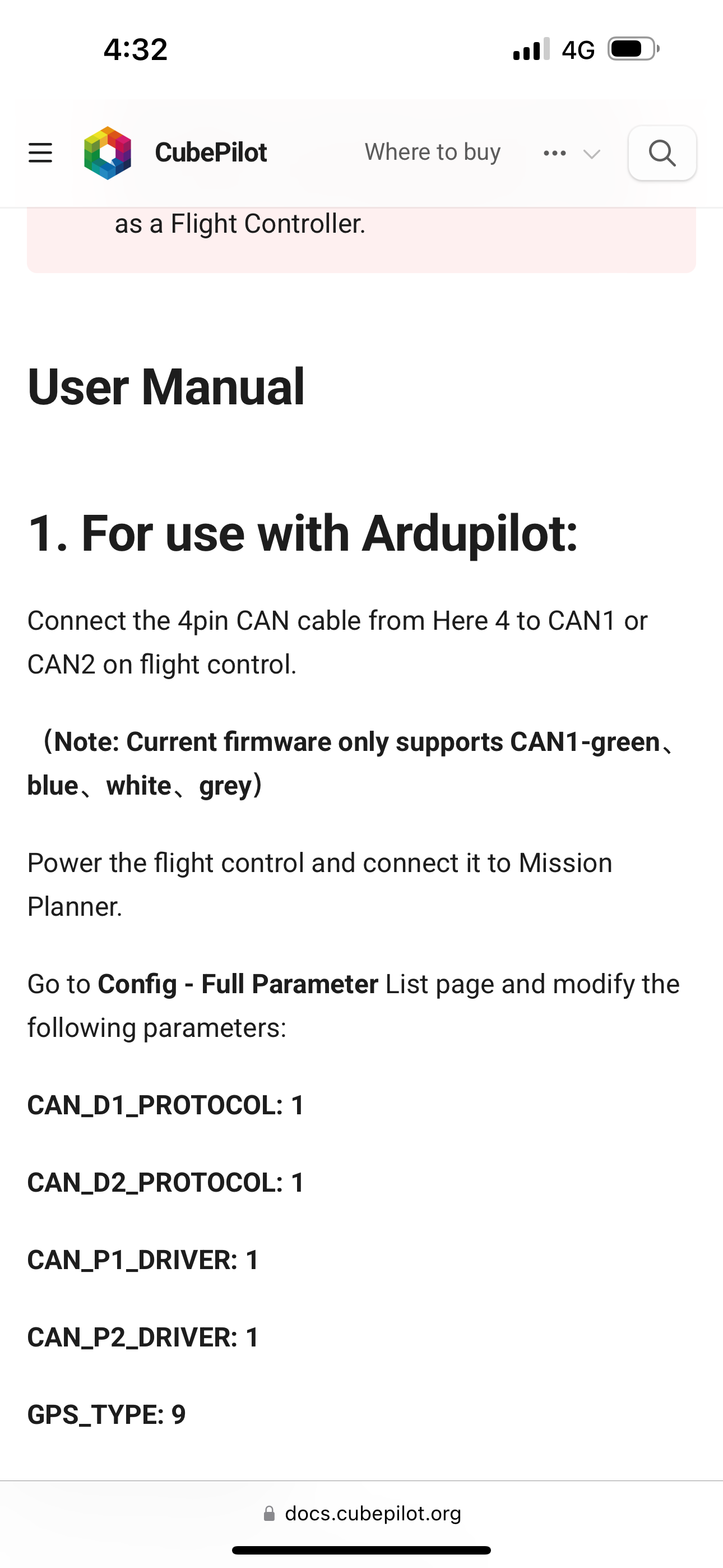

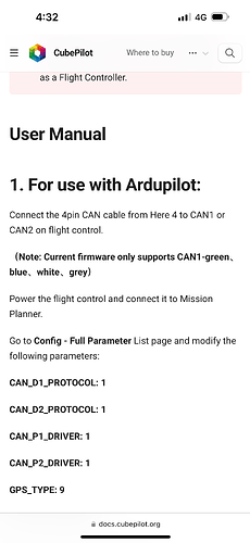

I jsut came across this it says can1 arducopter supported but ours is on can 2 port
It works on CAN2 but you can only do updates via CAN1
Oh ok, so should I give the can splitter external power ?
That would be best, because the CAN, GPS and Telem2 ports (and most things you can think of) are all powered together from one source with a 1.5A (or 1A ?) current limit. Telem1 has an isolated source capable of 1.5A.
Ok so I will power the can splitter externally for gps
So we have given external power 5.35v to the the can splitter.
Now gps 1/2 still configuring errors have stopped
Good work :slight_smile:
In previous GPS tests they proved to be sensitive to that supply voltage.

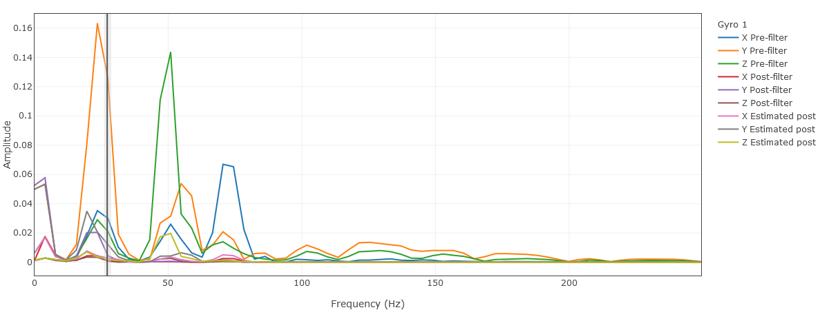

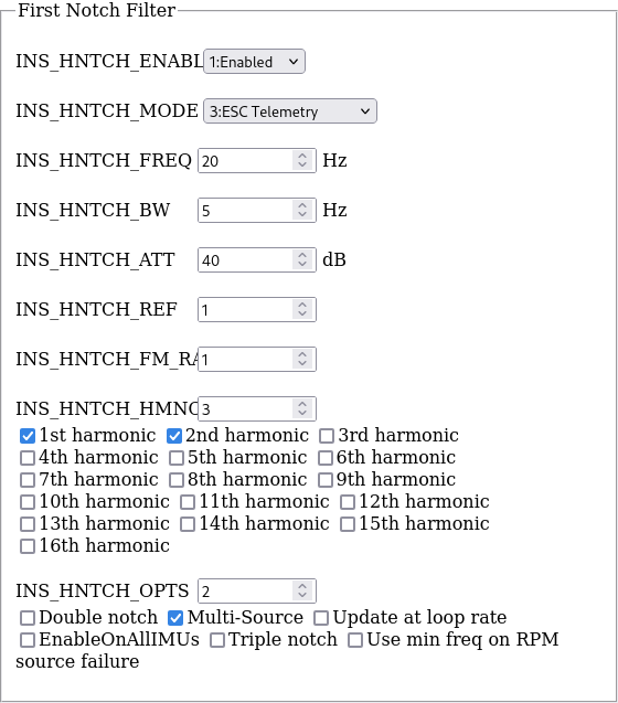

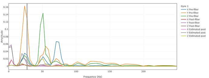

@amilcarlucas @xfacta So I just released i have set my harmonic notch filters based on throttle.
Now that i have can esc telem shouldn’t i set the notch filters using esc telem.
shouldn’t i set this
INS_GYRO_FILTER,20
INS_HNTCH_FREQ,21
INS_HNTCH_BW,15
INS_HNTCH_ATT,40
INS_HNTCH_REF,1
INS_HNTCH_FM_RAT,0.5
INS_HNTCH_HMNCS,1
INS_HNTCH_OPTS,0
INS_HNTCH_ENABLE,1
INS_HNTCH_MODE,3
log- notch filter first flight .bin - Google Drive
INSTEAD OF THIS (BELOW)
Present settings
INS_GYRO_FILTER,15
INS_HNTCH_FREQ,21
INS_HNTCH_BW,12
INS_HNTCH_ATT,40
INS_HNTCH_REF,0.125018
INS_HNTCH_HMNCS,3
INS_HNTCH_OPTS,1
INS_HNTCH_ENABLE,1
INS_HNTCH_MODE,1
From that log, use these settings:
Ok tom we are flying the drone, will set these and start again.
INS_GYRO_FILTER,20
INS_HNTCH_FREQ,20
INS_HNTCH_BW,5
INS_HNTCH_ATT,40
INS_HNTCH_REF,1
INS_HNTCH_FM_RAT,1
INS_HNTCH_HMNCS,3
INS_HNTCH_OPTS,2
INS_HNTCH_ENABLE,1
INS_HNTCH_MODE,3

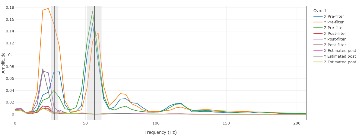

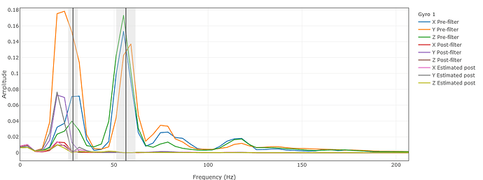

So we did test flying today and started from file 18 notch filter setup from the ardupilot methodic configurator
our final prams for filter seeings are below
INS_GYRO_FILTER,15
INS_HNTCH_FREQ,20
INS_HNTCH_BW,5
INS_HNTCH_ATT,40
INS_HNTCH_REF,1
INS_HNTCH_FM_RAT,1
INS_HNTCH_HMNCS,3
INS_HNTCH_OPTS,2
INS_HNTCH_ENABLE,1
INS_HNTCH_MODE,3
There after we did the steps and reached quicktune and was done successfully (no altitude oscillations this time)

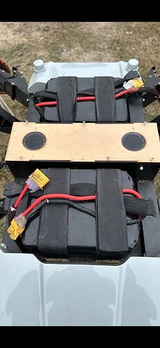

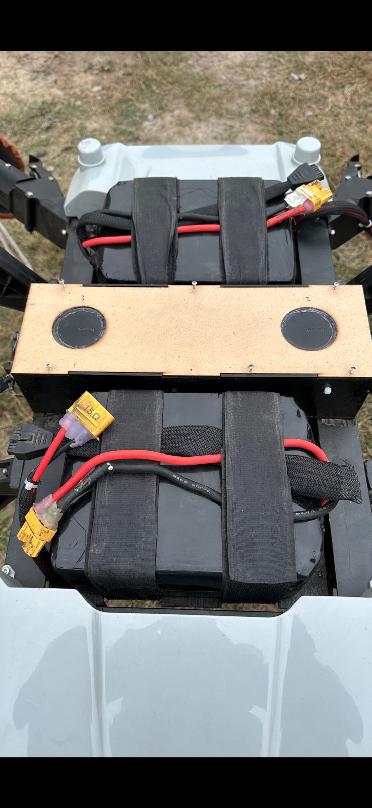

FYI - our GPS is 5cm above the autopilot and no wiring touching the gps but air unit reciever is about 3cm below gps1, and wiring goign to FC below gps almost 5cm away.
I am increasing the height of GPS units by another 5cm above the FC(5+5=10cm) and wiring
raising the gps another 5cm

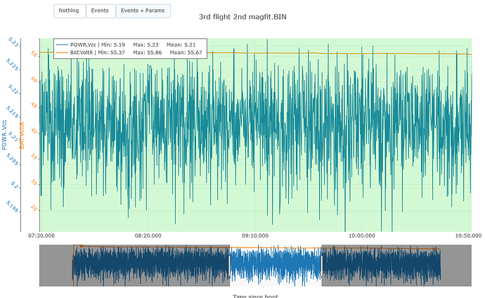

Did you already solve your 5V voltage fluctuations?
its above 5v,
