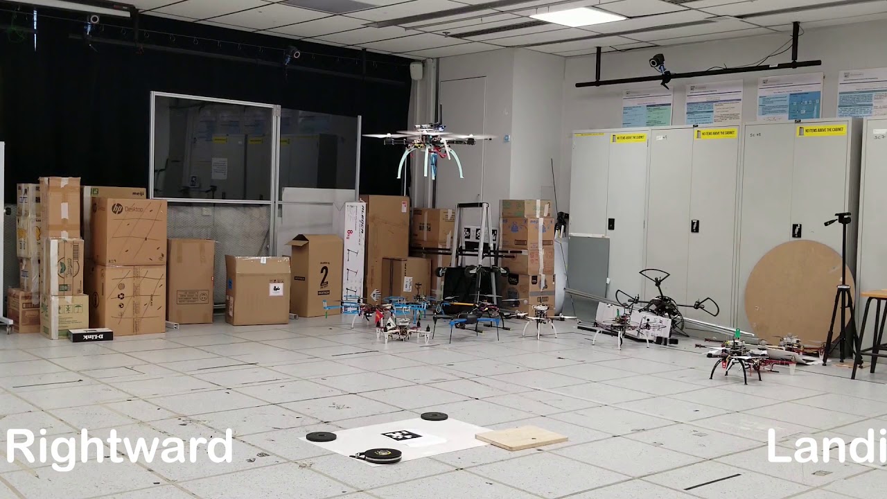

- For downfacing configuration of the Realsense T265, there is a problem with inconsistent yaw angle between runs. The temporary fix is to tilt the nose up a little, so that the camera is not facing flat down, when the script starts. Once the FCU starts receiving vision messages, the vehicle can be put flat on the ground.
- Take-off and hover above the target.
- When target is detected (see above about verifying that ArduPilot is receiving
landing_target
data), you can switch the vehicle toLAND
. - If everything is working properly, the copter should move towards, then land on the tag.
- As usual, be prepared to retake control if there are sudden unexpected movements (Change mode to Stabilize, AltHold or Loiter).
- If all is well, some successful tests can be seen below:
