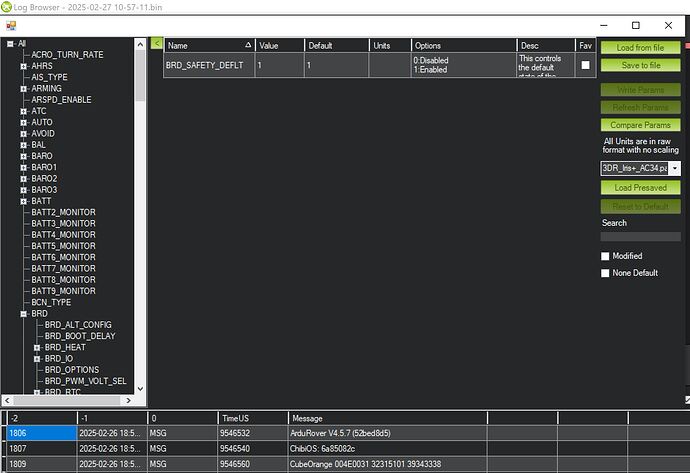

Set log_disarm,1 Restart it and post a link to the log created.
Here’s the log - thanks
The parameter exists in that log. Not sure what’s going on with your connection to Mission Planner. I always recommend updating MP to the latest beta release (on the HELP tab). Maybe that will help.
Not sure what to tell you here. These are the parameters extracted from that file with Mission Planner. The parameters is there.

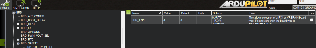

I reinstalled mission planner and set parameters to default with 4.5.7 still no BRD_SAFETY_DEFLT

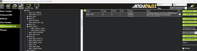

But I think its a software issue. BRD_TYPE was defaulted to 3 when I setup the CubeOrange and Mission Planner . But when I changed BRD_TYPE to 0 (Auto) refreshed parameters and wrote them , and then set BRD_TYPE from 0 back to 3 I get BRD_SAFETY_DEFLT and it perists after a number of reboots etc
Default setup BRD_TYPE 3 missing BRD_SAFETY_DEFL
Setting the board to BRD_TYPE 0 I get BRD_SAFETY_DEFLT
Then back to BRD_TYPE 3 we have BRD_SAFETY_DEFL and it sticks around after reboots
