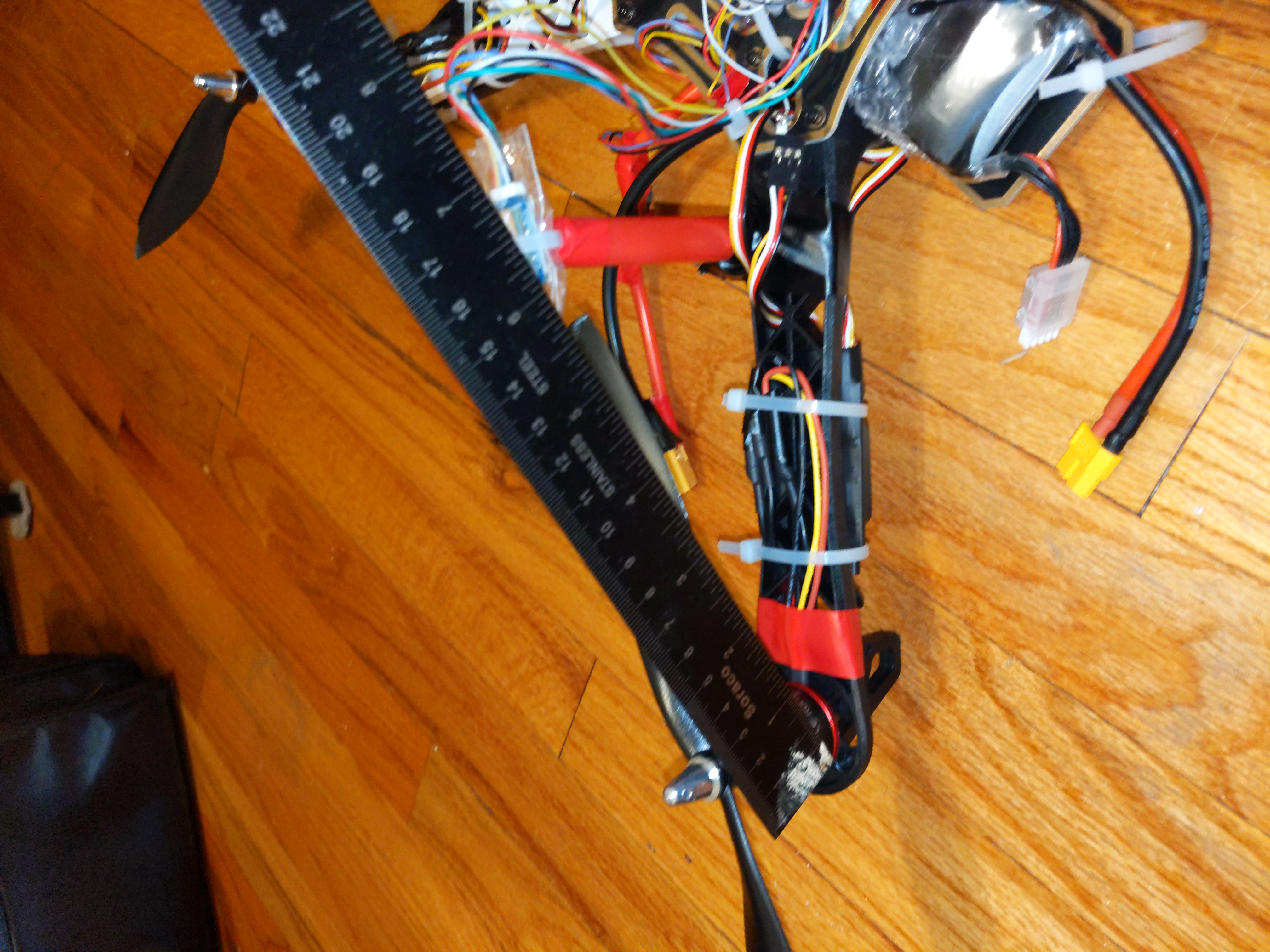

I’m having a pretty bad issue with my drone. Whenever I take it out, usually it will arm and fly for one flight, no matter how long(5sec-5min). Then, when I land it will not arm again and will give the message:
[19:27:56.355] Critical: PreArm: Check mag field (xy diff:118>100)
The first number(in this instance 118) does vary a bit, the highest I’ve seen is 158. This issue just started, and I’m not sure why or what caused it. Nothing really changed with my build. My specs are:
  • 30a ESCs
  • 3s 5ah LiPo
  • Matek H743-Slim
  • Matek M10Q 5883
Attached are some photos of the setup. I’ve checked for motor/compass interference before, and noticed practically none. I’ve tried re-calibrating the compass so many times, but it either serves as a one-flight fix, or just doesn’t work at all.

If you try calibrate your compass, compass vs motor interference calibration still had the same problem. The9/10 your compass position is too near interference source
Yeah I agree. The compass is 6 inches from motor and 5 inches from ESC. I’ll buy a proper motor mount instead of using this plastic boba straw and a zip tie lol.
By any chance you are using matek compass and gnss? Those are incredibly prone to this error
yes i was. solved by buying a proper gps holder instead of the makeshift one i was using that was too close to the motors. thank you!
