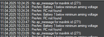

Please tell me what this message means.: No ap_message for mavlink id (271) .Which error needs to be fixed?
Known issue for 1MB-flash boards. Fix is in dev and is marked for backport to 4.6
GCS_Common: fix missing #if for CAMERA_FOV_STATUS by robertlong13 · Pull Request #29339 · ArduPilot/ardupilot
Hi everyone. Have a same problem, use ArduCopter 4.7.0-dev (f328a659) on SpeedybeeF4V3 and to ground station sending No ap_message for mavlink id (271) .
PreArm checking in log, because to screenshot use only 5v connection. With battery the same problem

It’s still the camera FOV message. I saw a post from (I think) Randy the other day saying it’s on the 4.6 issue list that they’re going to stop it from spamming. A lot of us are getting it.

The 271 message is a pain. The devs know about it. I’ve read it’s on the list to be fixed. But it’s just spam, so depending on your GCS/Telemetry set up, it can be ignored.
Thanks for the reports. @peterbarker has resolved this issue and the fix will go out with Copter-4.6.0-beta7 within the next week or so. I can’t say exactly when 4.6.0 will become the stable release but hopefully within a month
