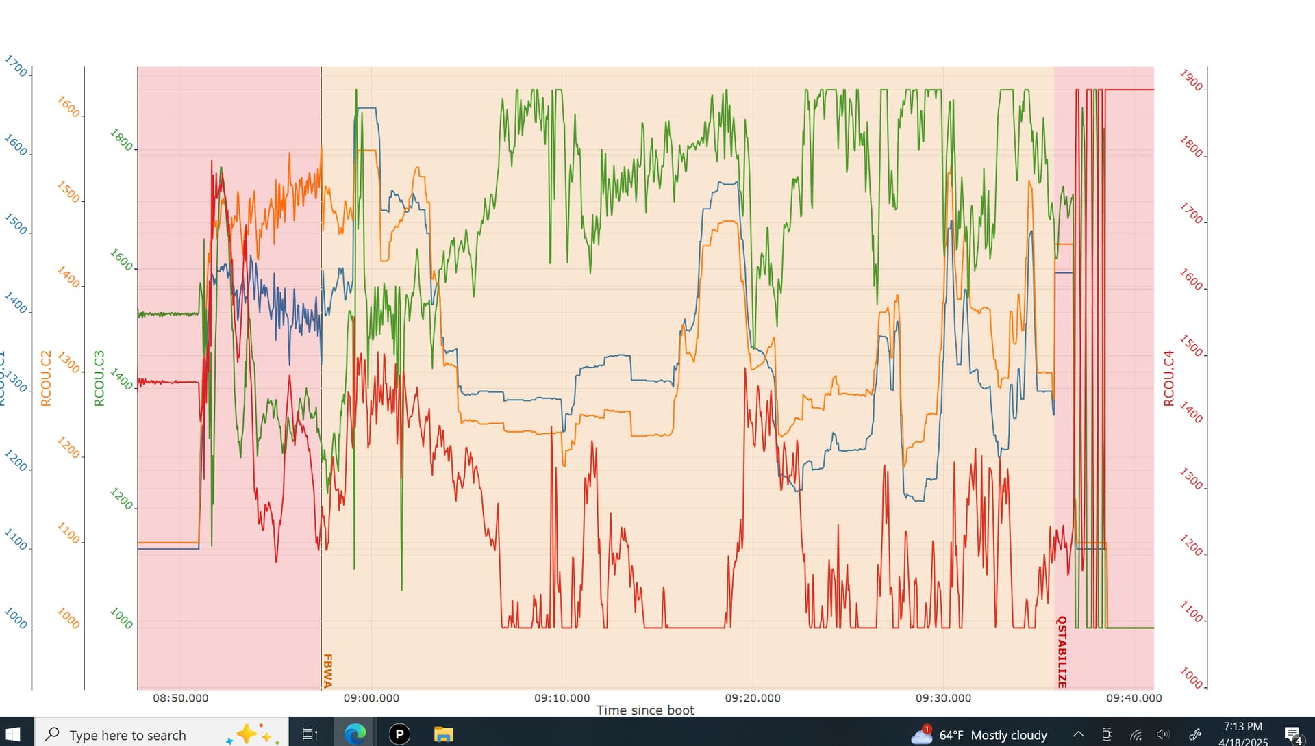

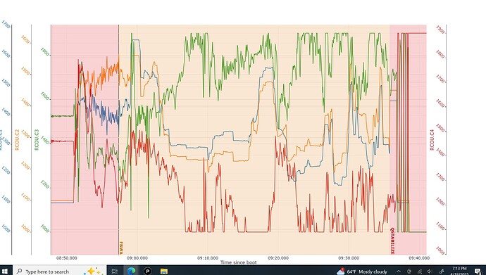

I tried a transition flight today (and still forgot to calibrate the compass). Had some significant oscillations in FBWA and it seems I need at least half throttle to maintain control in QSTABILIZE, but overall, I thought the flight went alright for flying on the defaults. The aircraft’s back in one piece, so that’s always a win. If anyone is willing to take a look at the log, it’s linked below. I didn’t see log dropouts in this flight, which was nice! I’m not sure what would’ve changed to account for that.
Tailsitter VTOL 1st FBWA flight.bin
That looks like a ton of fun. Try lowering PTCH_RATE_SMAX to 130 (or lower) and see if that helps with the oscillations.
Are those the Rotorgeeks motors with 5" props?
Thanks @Allister I’ll do that and try another flight tomorrow. These are just some smaller 1408 2400kv motors from another project/class with 4023 props on them. That would be fun to build a bigger one with the RotorGeeks motors at some point! I still have my eye on Henry’s AeroScout tri-VTOL conversion blog post from a while back that I want to try since we use Aeroscouts in classes here as well.
I tried what you suggested, @Allister, and reduced the PTCH_RATE_SMAX to 125, which did seem to help a bit during the flight, and also appears to show improvment in the log when graphing things like is done on this wiki page - Limit Cycle Detection — Plane documentation . At this point, I’m wondering if I should also work on reducing the fixed wing PIDS to get it more flyable in FBWA in order to start some tuning. I have been looking at this page - Tailsitter VTOL Tuning — Plane documentation which seems more related to tuning a tailsitter while in “quad” mode, but based on the documentation, I should work through the steps on this page - Roll, Pitch and Yaw Controller Tuning — Plane documentation

Back at it with another test today (finally)! I discovered that my center of gravity was way off for the airframe and so corrected that by adding a small “battery pod” on the nose of the wing. I also swapped to 5in*3blade props instead of 4in to help with the CG and I was hoping to also have it help with an issue I’m seeing in VTOL/hovering flight.
I want to work on the VTOL tune now, but it is very difficult to descend from altitude with the aircraft (like after a FW → VTOL transition) as things currently are. From what I observe, the aircraft is very sensitive to low throttle in VTOL mode, and when I lower throttle too much, it begins to tumble through the air, essentially not getting enough air over the control surfaces to keep itself under control, if I’m understanding things right. I think this would also make VTOL tuning difficult.

Today I tried to use QHOVER to help control the throttle a bit and assist with the descent problem I’ve been having, but it didn’t seem to work. I’m in over my head here, but at the suggestion earlier of checking out the eXplora project and my general thoughts here are that I need much larger elevon control surfaces in order to maintain control of the aircraft at the lower throttle settings needed for descent.
I am trying to avoid adding tilts to the motors to avoid that extra complexity. If anyone else has any other ideas, that would be fantastic. I’m essentially trying to see how viable this physical airframe is before I get to tuning, so if there’s a software fix for the behavior I’m observing, that would be great, but my gut feeling is that I need to alter the physical aircraft structure to get better behavior on the “defaults”. Frankly I’m amazed at how well this flies on the defaults - a really great job done by all the developers and those who have tested/flown before me.

Well, I went a built a v2 of the aircraft with larger elevons to see if that would help with control in a hover. Granted, it was a bit breezy on the day I was testing, but I still had a really hard time trying to get it to hover consistently. Was wondering if anyone had any inputs on this other than the practical fact that tailsitters are hard to fly in breeze/wing and or that my tailsitter happens to be quite light weight which really makes it twitchy. I’ve attached a log if anyone has any insight. Thanks!
Tailsitter VTOL v2 Flights.bin
My VTOL looks very similar to the one in this video physically - so I’m banging my head against the wall trying to figure out why it’s so difficult to fly (I know the one in the video is using a different flight control system). https://www.youtube.com/watch?v=RabFZzRyZo8&pp=ygUVdGFtaW5nIHRoZSB0YWlsc2l0dGVy
@dpapworth, your drone is extremely underpowered. You are getting the classic motor saturation problem.
