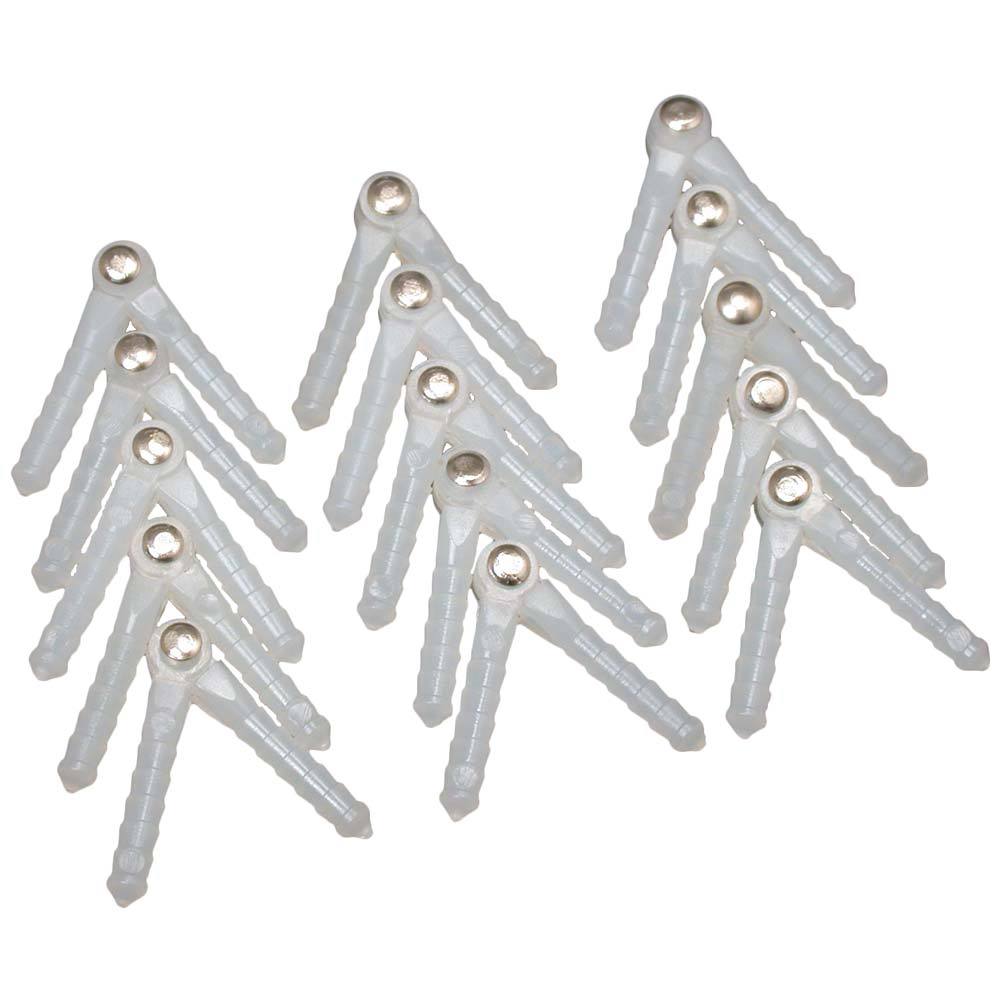

Well it looks like the Fighter and Striver have taken over for 2021. So just a little update on the Nimbus- COVID lockdown has seen her parked up for teh last 3 months, but an end is in sight. Today I decided on my next upgrade hinging the ailerons, they are known for being stiff and only the portion near the servo rod get full through. So with the new hinges I intend to with my 2nd battery turn off Q-Assist and do a full FW auto tune. I’m excited to get back out there.
This was all inspired by my Nimbus Kit form banggood that arrived the other day, securely packed with plenty of bubble wrap and packing tape. The Ailerons and Elevators would not move so need to be cut. From there I guess I had the option of tape or hinges, and hinges won I used these hinges and all appears well so far with 5 across the Ailerons and 3 for the elevators.
