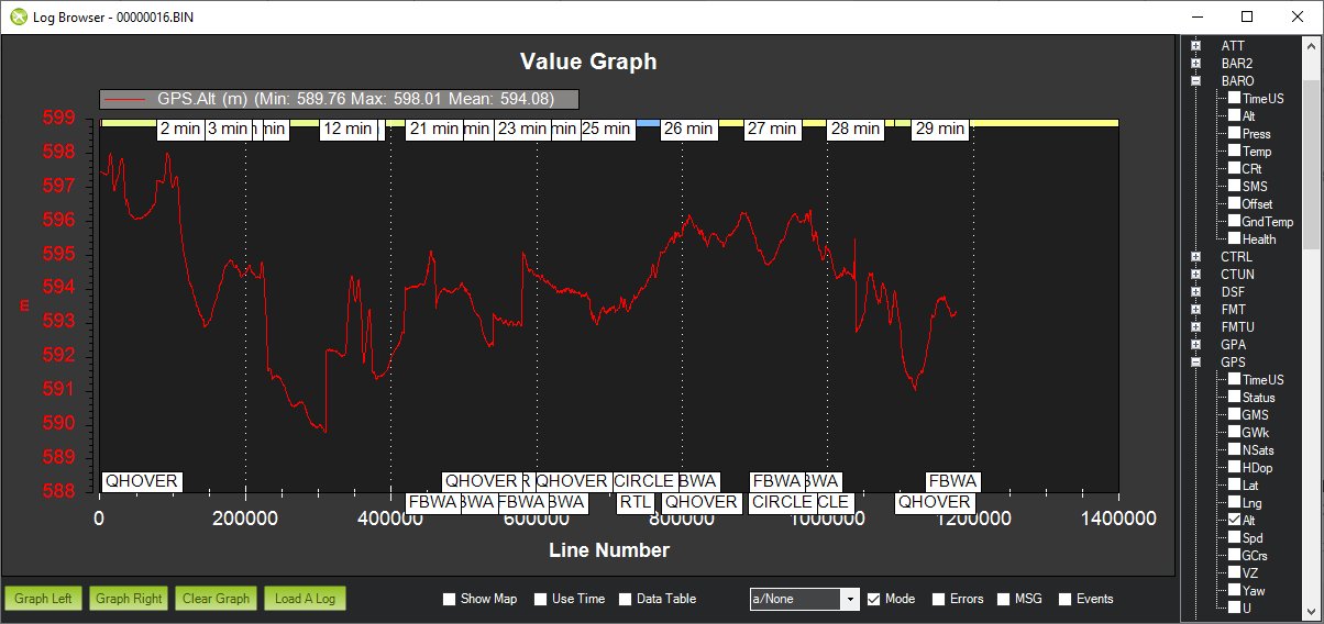

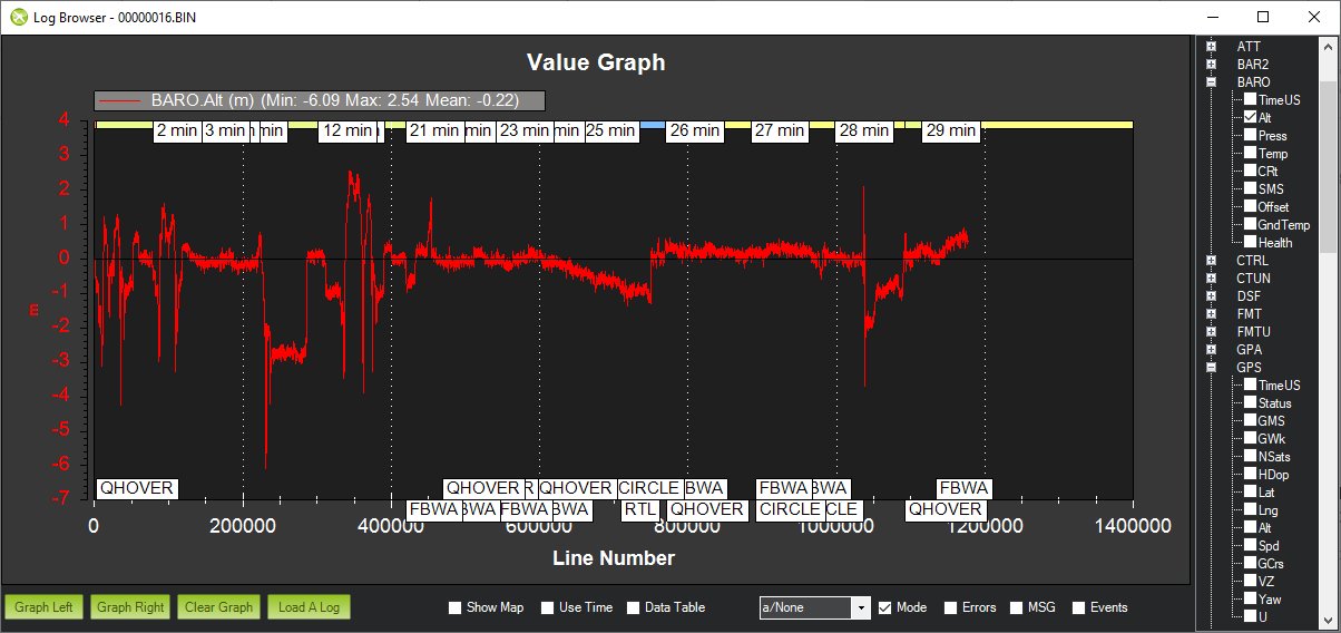

I have a strange behavior of my quad plane, It is losing its altitude after 2 meters. The same configuration is worked in the quad plane. now we did quadpalne with front 2 motor tilt. In this, it losing altitude. When we are observing in logs, VTOL is looks like is under power. but the same hardware is successful in a quad plane without Tiltrotor.
i am attaching the log below please give me any suggestions.

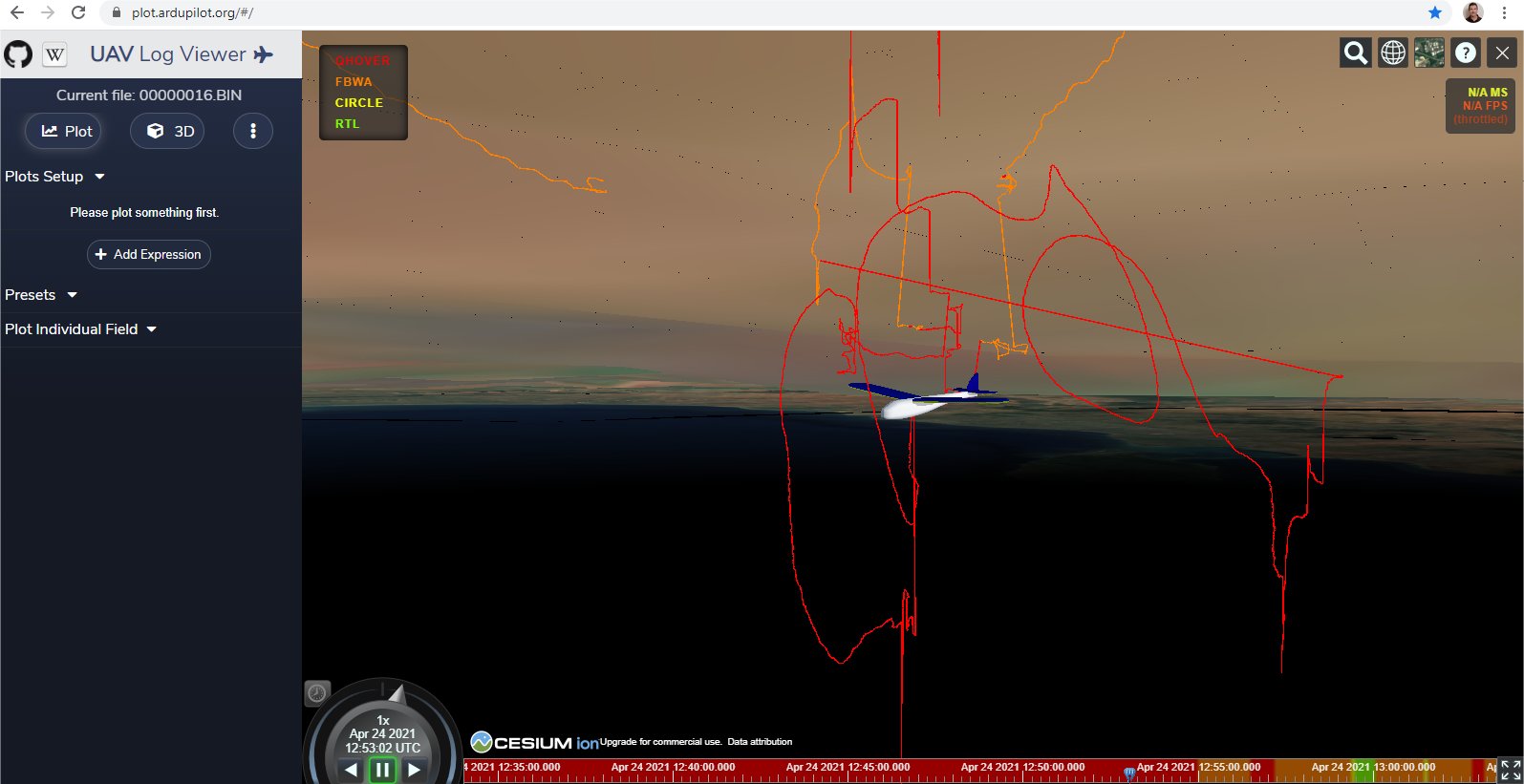

Hi Swarna,
I looked at your log and cannot make sense of it. Even the UAV Log Viewer had issues trying to follow the telemetry log. The BARO and GPS graphs are not proper. Perhaps someone else can make sense of this log.
Good luck!
