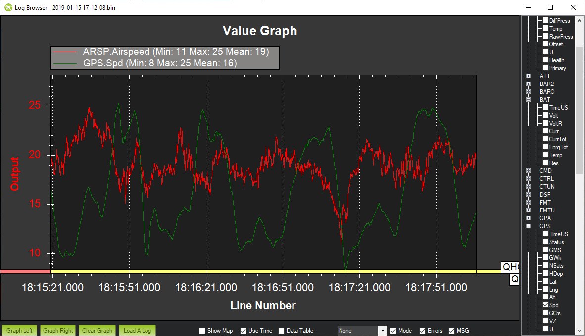

I have seen that wobble before on my FireFLY6. Try reducing the Q_ASSIST_SPEED setting by 1 or 2. The original FireFLY6 firmware never had the wobble because it just brute-forced the transition. It looked much smoother. The APM firmware uses air speed to more intelligently determine when it should complete the transition. I believe that the wobble is during this final period when the plane isn’t going fast enough to trigger the full transition. If you are using an Air Speed sensor, graph the AS sensor speed vs. GPS speed and see what the difference is.

Here are some graphs from Bobby Mosher’s flight. The hover current is around 25amps and the forward flight current about 14amps. I am not sure what Power Module he is using. I believe his power system is the XUAV conversion kit.

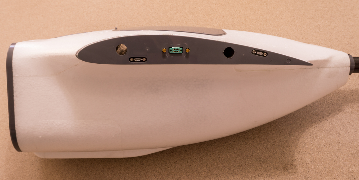

I mounted my second camera on the nose plywood. The Arkbird Mini Gimbal Camera is designed for small fixed-wing FPV planes so it doesn’t offset the balance by much. The 2K camera and gimbal weigh only 80g (2.8oz). I can swap it from plane to plane easily as it uses a common 6-pin Pixhawk serial port connector. The Nimbus 1800 nose connection system makes for easy wiring to the fuselage. I have groupings for AS Sensor, 12v, Video, and PWM control to the X8R receiver. My ImmersionRC 600mw 5.8GHz transmitter is below the plane where the mapping camera resides.
The last image shows the camera mounted on my Bix3 QuadPlane FPV pod.

Greg, Graham, Gordon, what final weight do you have with the video equipment in flight order?
Atico,
My Nimbus VTOL components have these weights:
  • Multistar 6s 10AH Battery with Plywood Plate = 43.6oz (1236g)
  • 1 VTOL wing = 26.5oz (751g)
  • Both tails = 3.35oz (95g)
  • Nose with AS Sensor = 3.45oz (98g)
  • Body with Landing Legs = 44.8oz (1270g)
Total weight without payload = 148.2oz (9.26lb)(4201g)(4.2kg)
Payload 1 (2K camera and gimbal) = 80g (2.8oz)
Payload 2 (GoPro H3 and 3-axis gimbal) = 75g + 186g = 261g (9.2oz)
Payload 3 (Cannon S100 Mapping Camera and Mount) = less than Payload 2
ImmersionRC 600mw, 5.8GHz Transmitter = 18g (0.6oz)
Spironet 5.8GHz.Circular Polarized Antenna = ???
