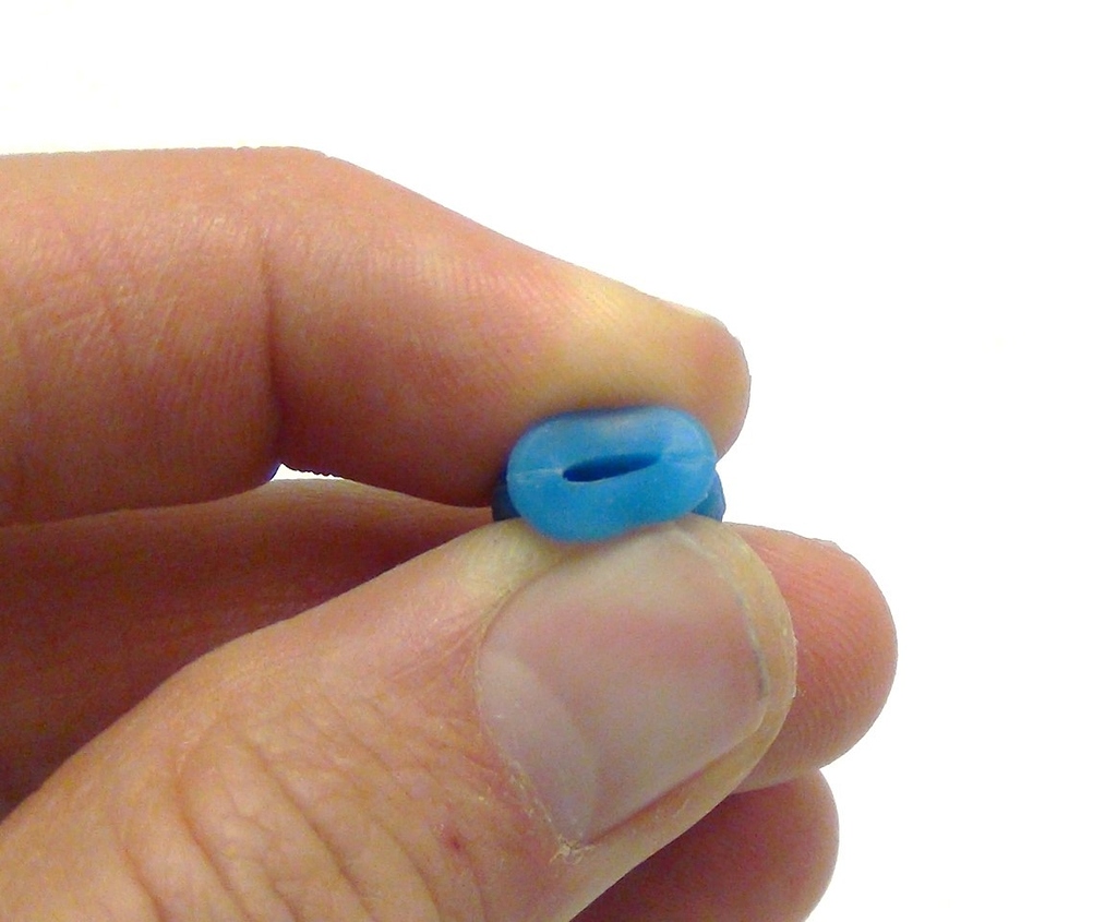

  1. In addition to what @LuisVale said about vibration isolation, I would like to add a couple of things:
I have had no problems using this style of mounts:
For rotorcraft, I have seen the most effective method for reducing vibrations is to balance your motors and propellers on a multirotor. For a helicopter, I am guessing that would probably translate to balancing the blades and adjusting the blade tracking (correct me if I am wrong here).
