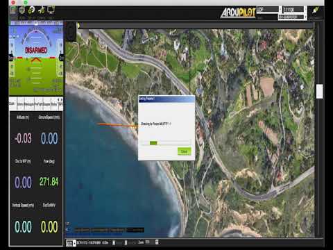

So I tried it on a Mac Mini 2014 with Mojave 10.14.6 with a SITL simulation on another window. It almost works:
So it stops with this window:
MP_MacOS_SITL2_810
and I don’t know how to go on. Occasionally it seems to go further, but I don’t know if there is a difference or luck.
Trying the MP linux version I think the same happened, and there was a way to go on, which I can’t remember.
I can’t find it in my system, and it almost works.

The SITL (…sim_vehicle.py…) simulation and MP run on the same machine (Intel Mac Mini). I see that MP connects automatically, and initially I don’t see how to avoid it. I will try TCP on different machines. All seems similar to trying MP on Linux in the past, with SITL on the Mac as here.
