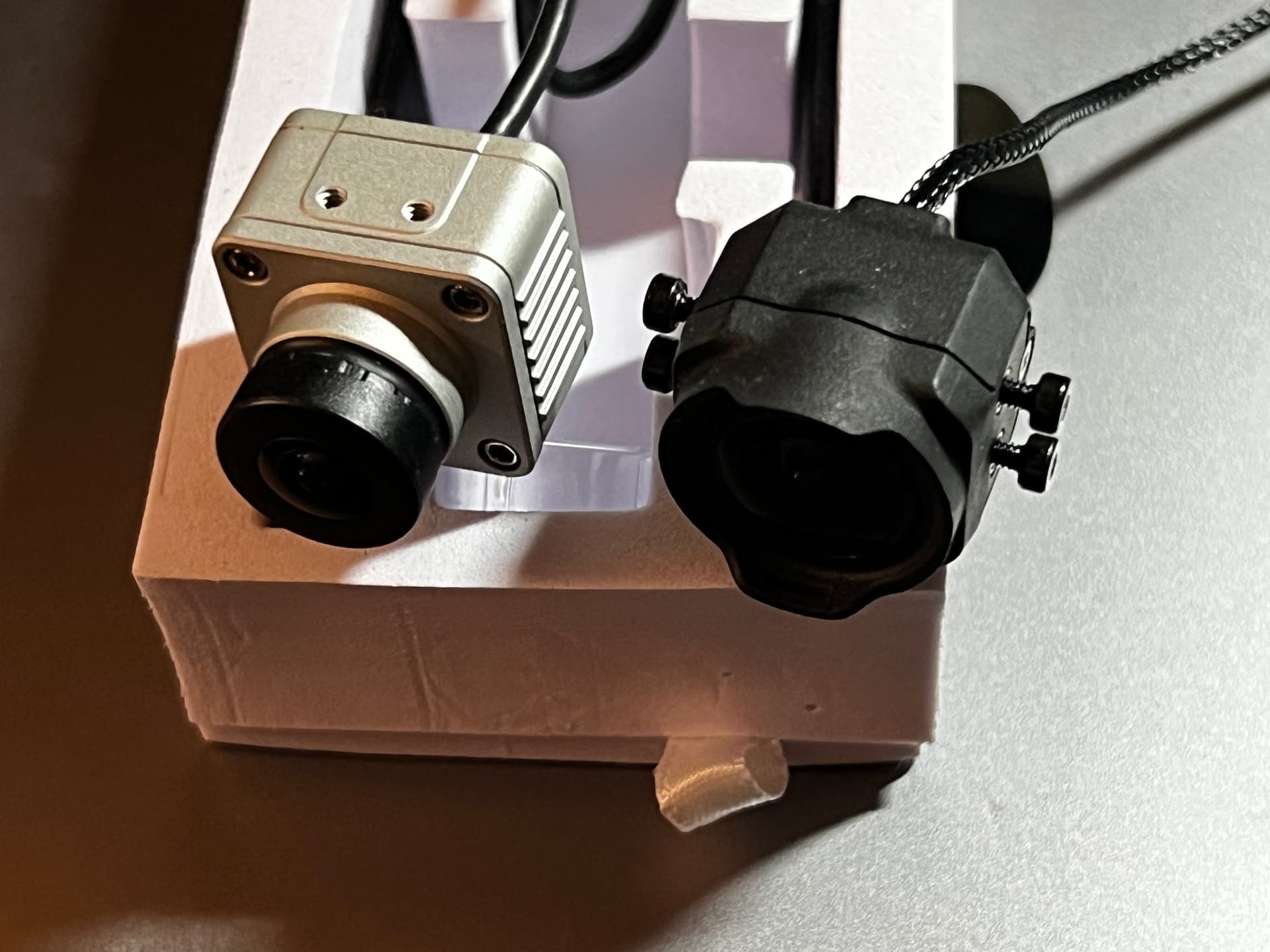

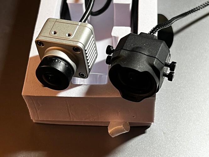

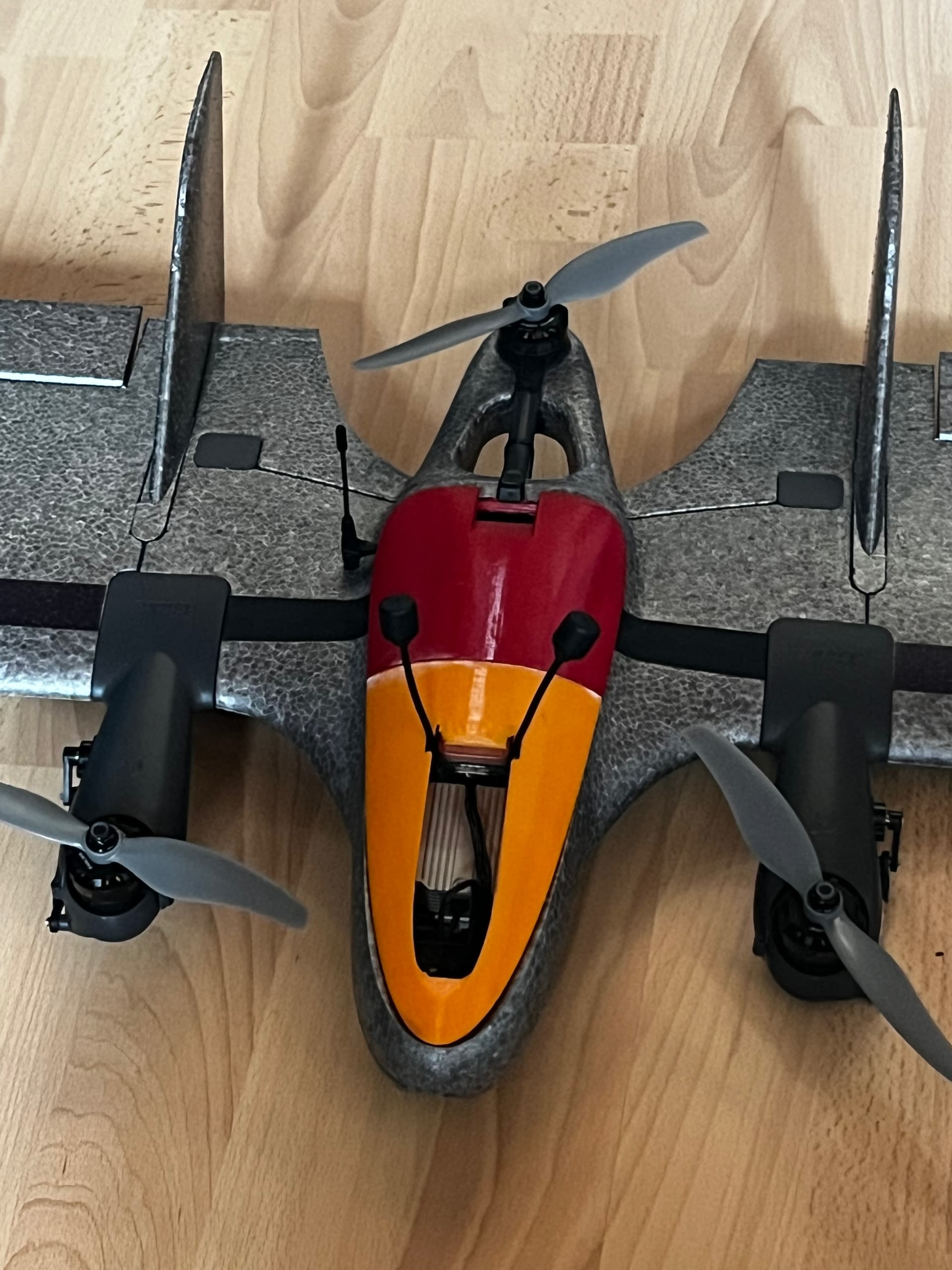

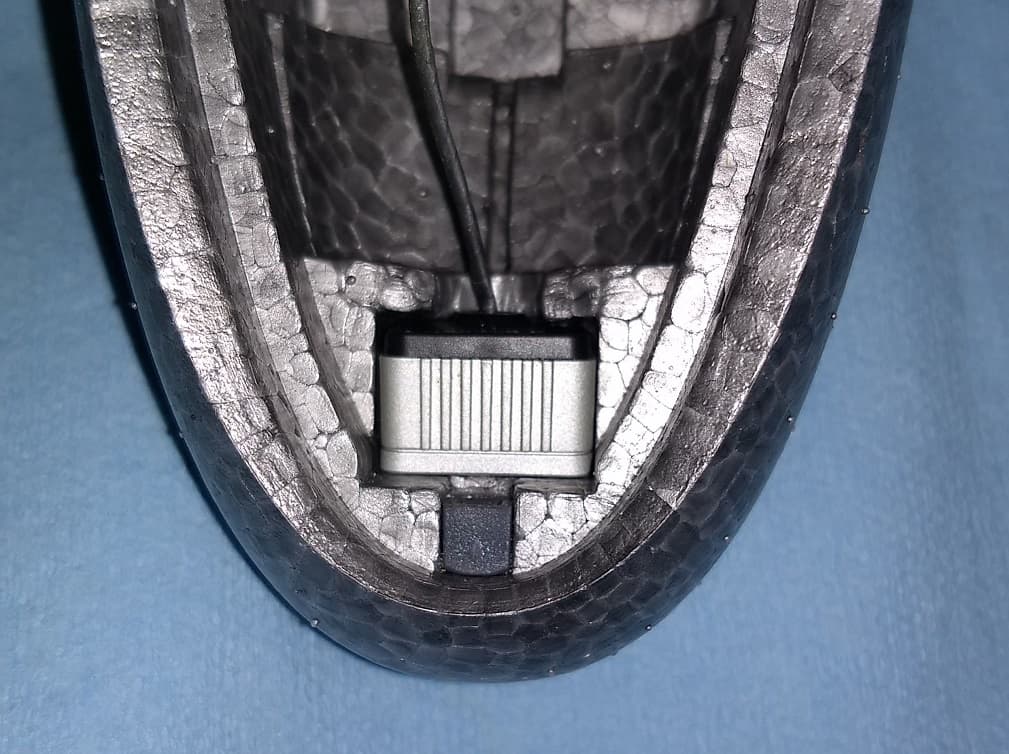

The nose requires significant modification to get any of the DJI cameras to fit.
Not really for me - didn’t have to change a lot. That would have been different for an O3 air unit.

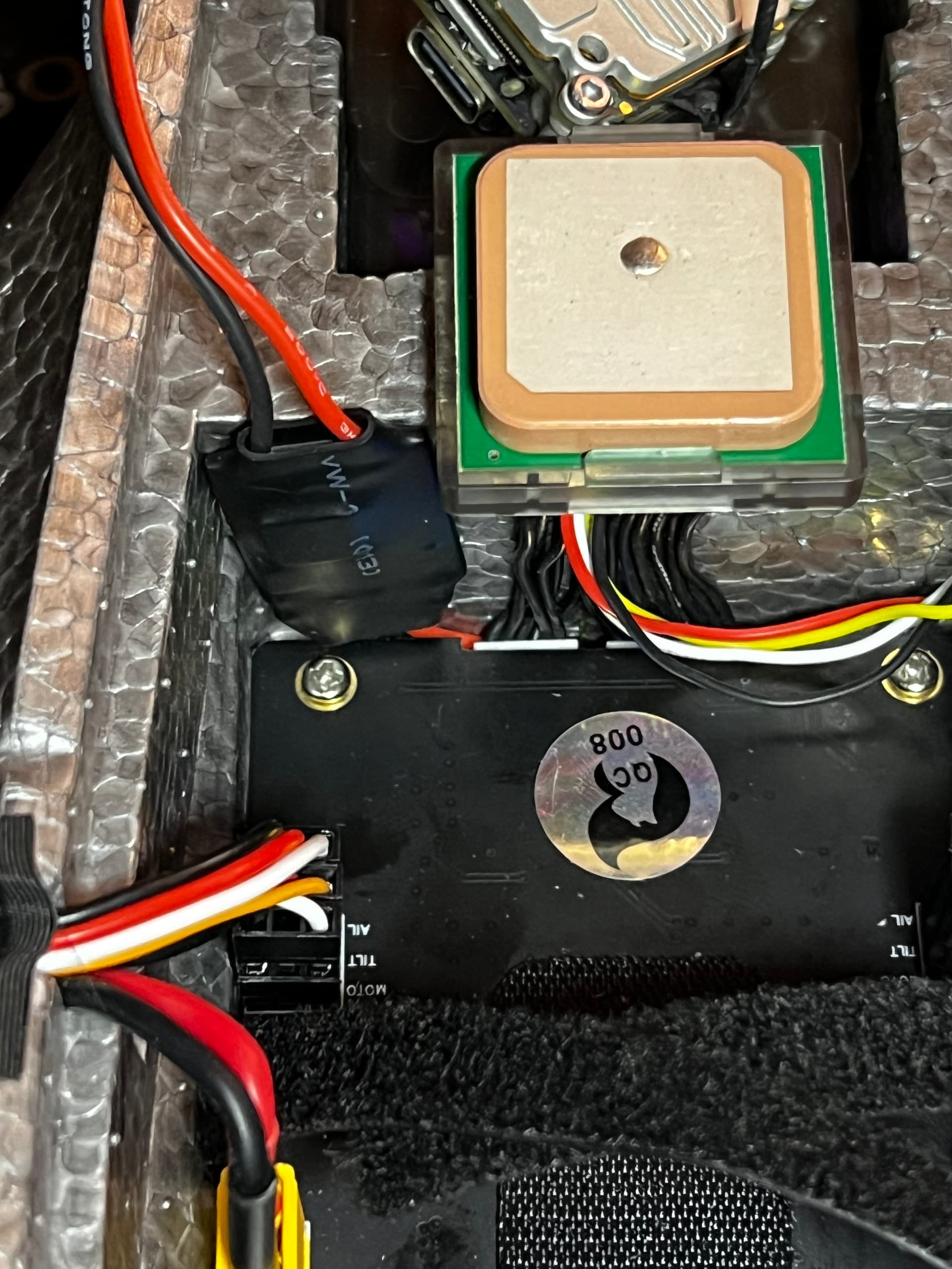

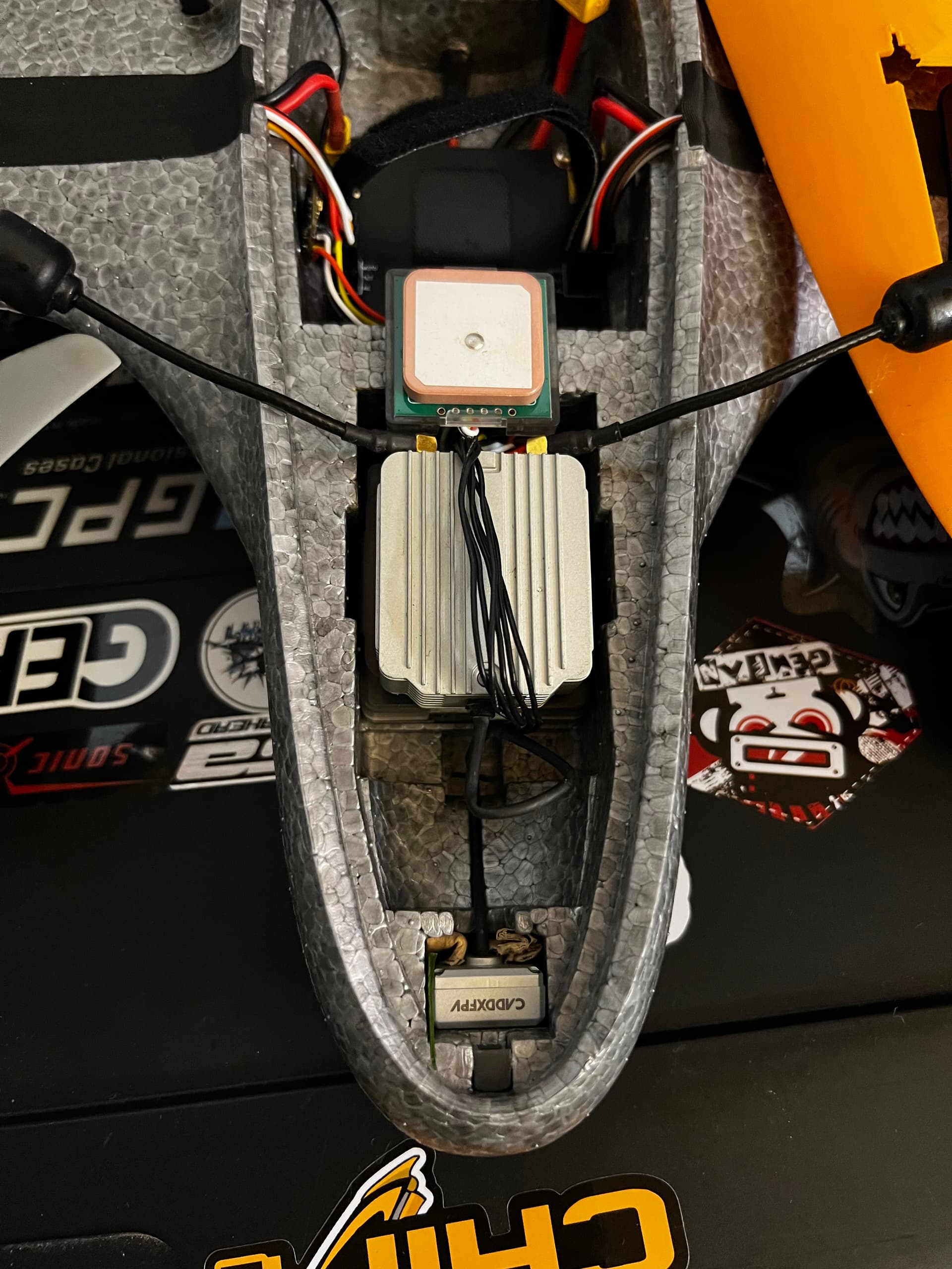

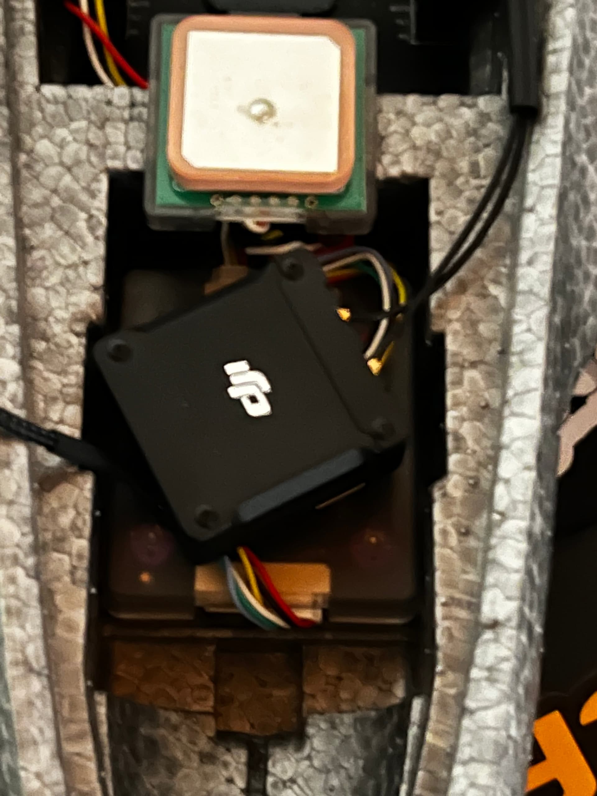

Have you had any issues with the GPS/Magnetometer that close to the Airunit?
Not with the GPS. There is no magnetometer. I might change that, but the build in gps got very quickly a GPS lock.
Wow, that looks great.

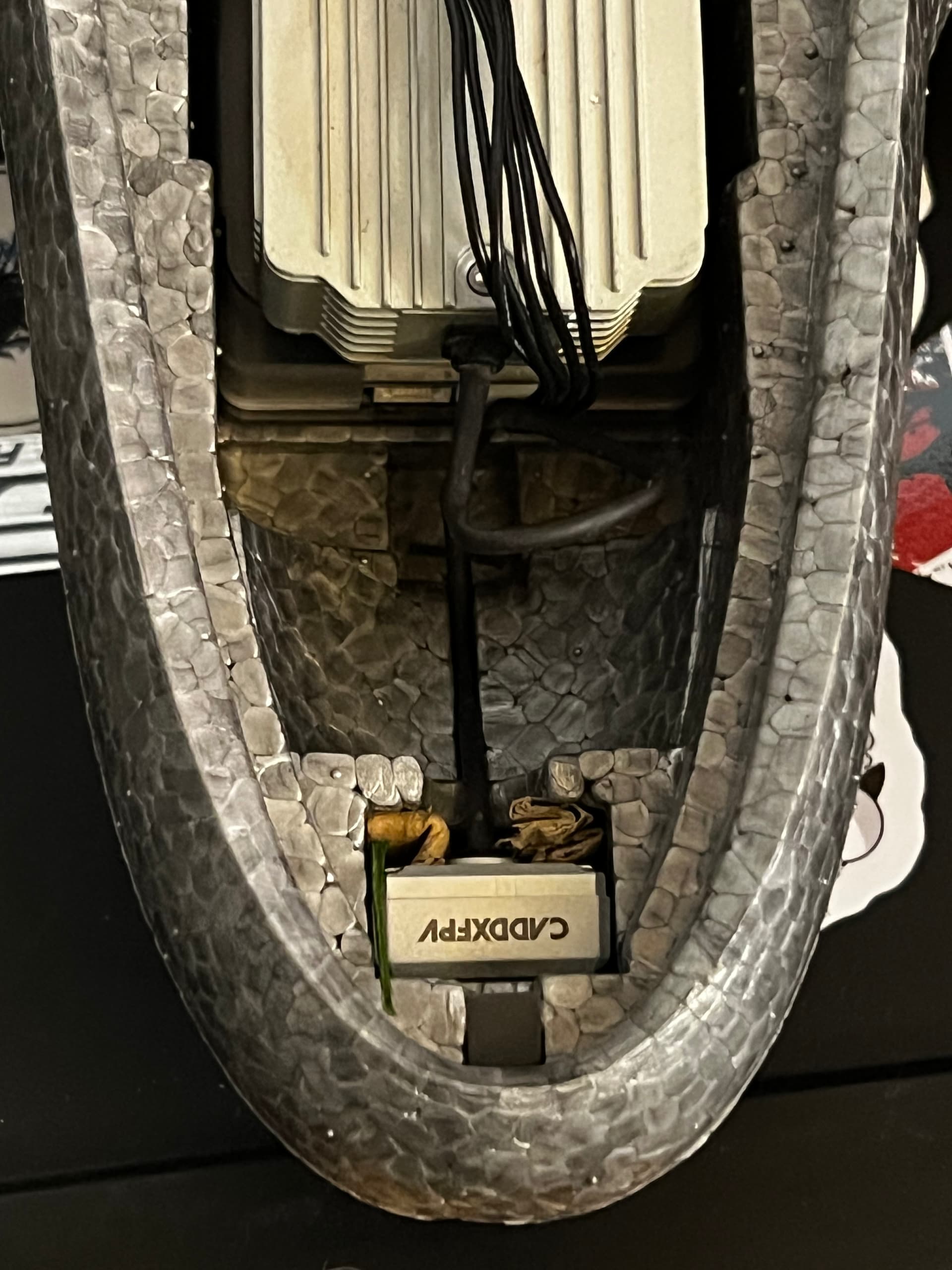

I just checked with my Air Unit and you’re right, it does fit. I just had to be a bit forceful to get it in. Thanks for setting me straight!
I’ll use the Air Unit in my second aircraft.
The O3 camera will need some adjustments, but I guess that won’t be too difficult.

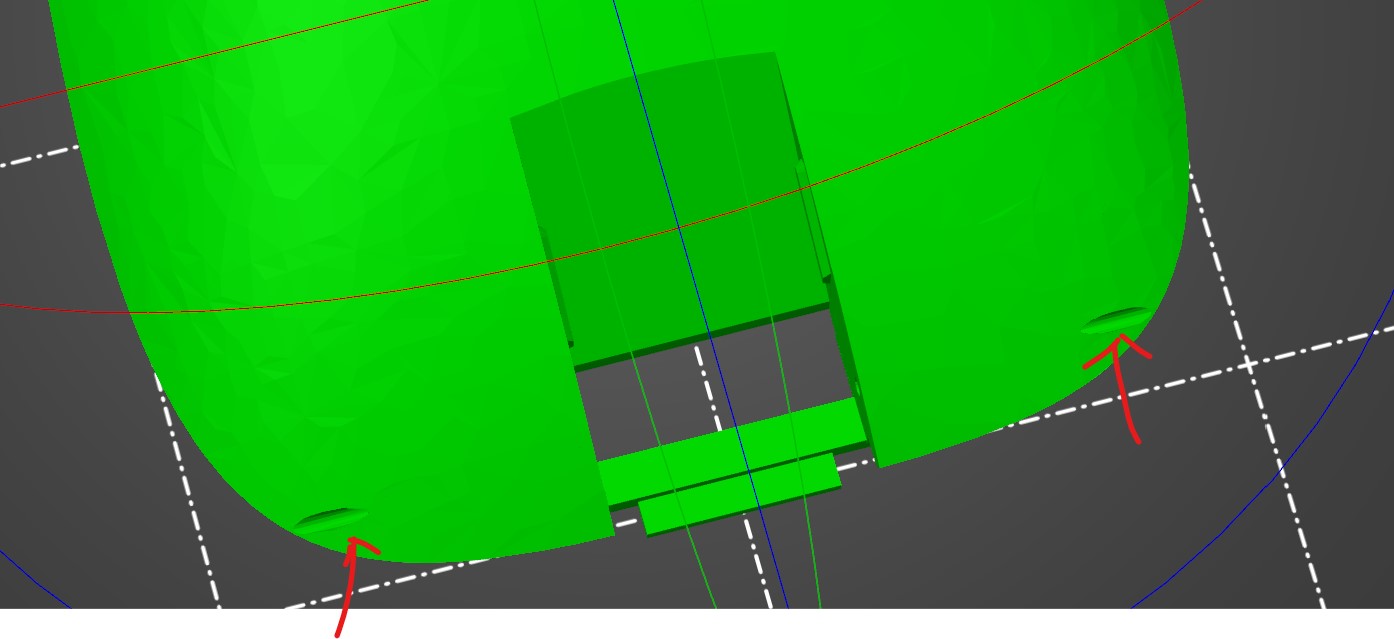

I printed this to get more battery height room. Which it has, so thanks. However, the version on thingiverse doesn’t seem to match your photo .Do you have more up to date files?
Yes, it is however just a rough version to test with the old air unit. The posted version is compatible with the vista and O3. I use currently (till I’m sure it is worth it) a full size air unit for testing. I will probably also do a more refined version for that. I will post it here again when it’s finished.

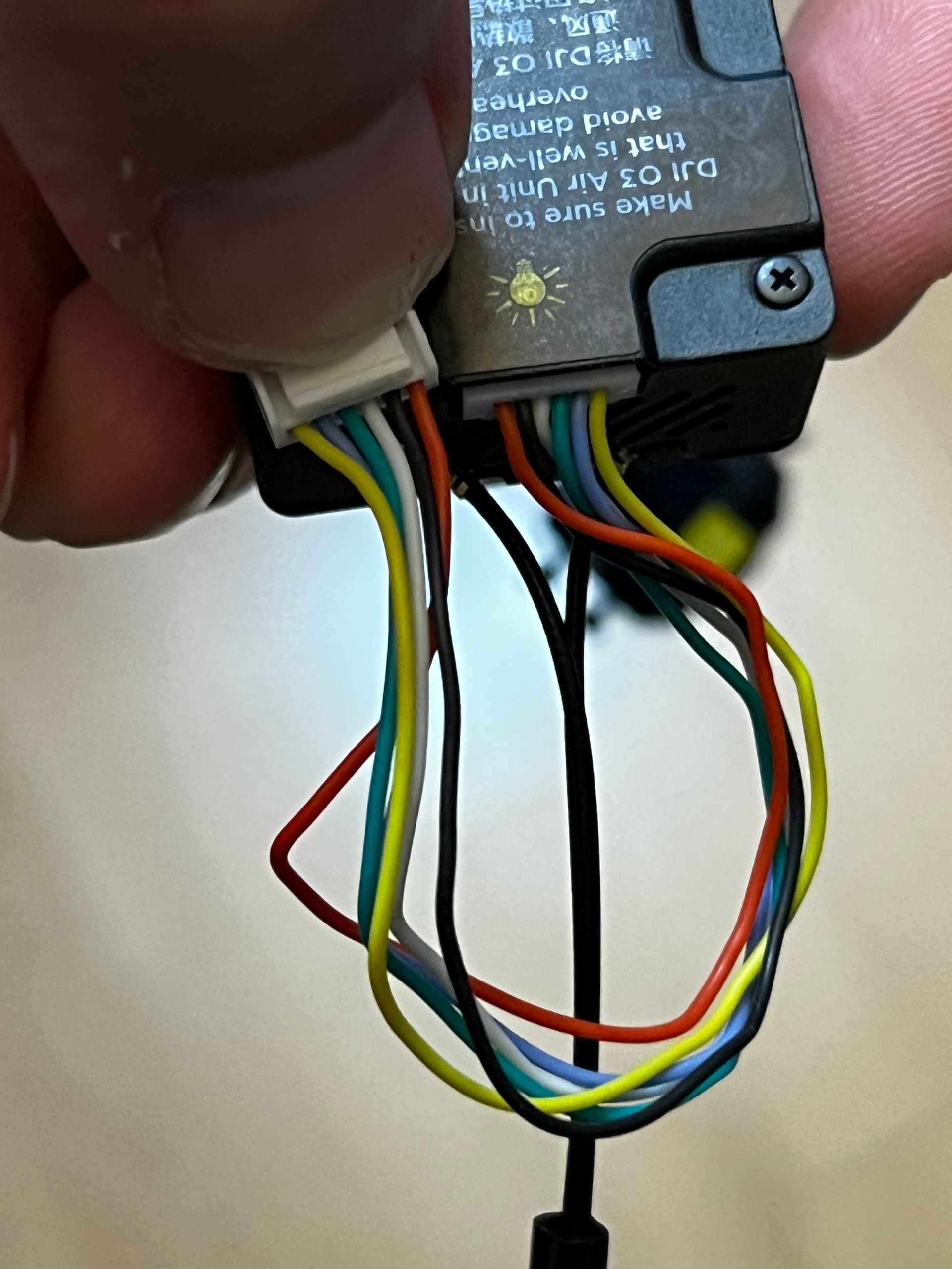

Small remark for all who want to use an O3 wit the Xiake 800: the BEC seems not to be capable of powering it. I was not able to get even the led to turn on.
I will add an external one.
Be also careful - might have fried the build in BEC for the air unit.
Even in low power mode? (The O3 will stay in lower power mode until it receives a message from the FC that the aircraft is armed.)
Make sure you have the pins right in your wires.
I’ve used the O3 with one of my Xiake FCs several times and it appears to work fine in low power mode. I haven’t tried in while armed yet.
Mine died & provides no voltage anymore. I added now a BEC (12V 2A). Now everything works fine (with a vista). Including OSD. I will switch tomorrow to an O3.
I think I connected it correctly. In addition: the O3 should then have died. I tested it afterwards, but it still works fine.
Maybe you’re right and I got it wrong. I will check it tomorrow again.

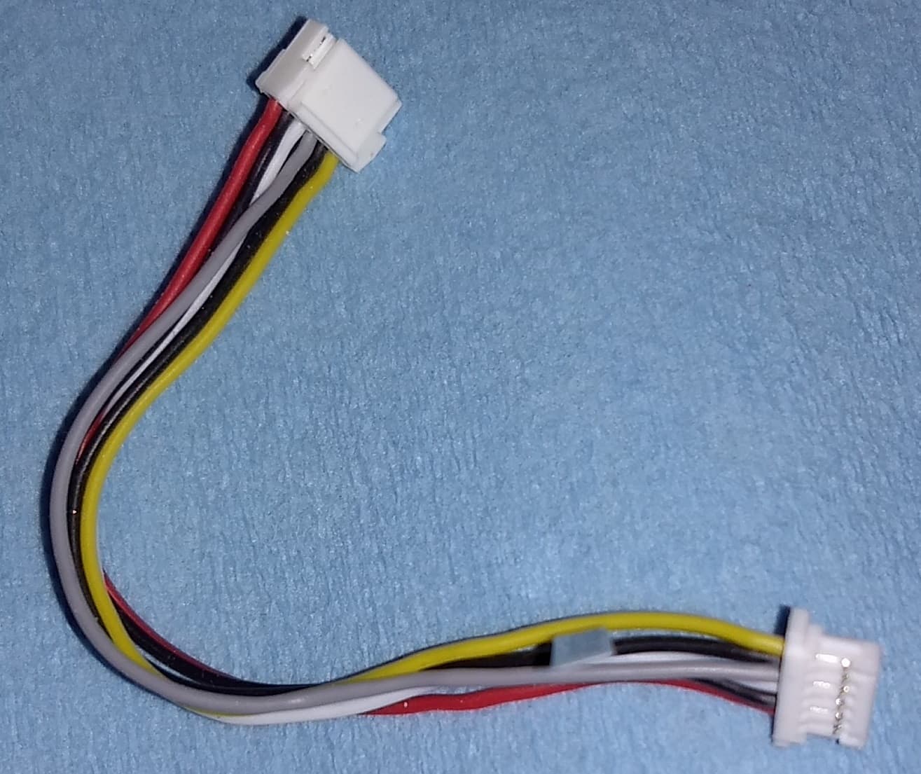

Darn it, it looks like your wire harness has the wires reversed.
I know it’s too late for you but in hopes no one else has the same problem, here are the pinouts for the O3 and Xiake flight controller.
XiakeDjiPinout2
I use the cable below. This cable came with flight controller I had previously purchased.

I tried it once again & everything works fine (also the original BEC. I will keep it for the moment & see if it is needed for the O3.

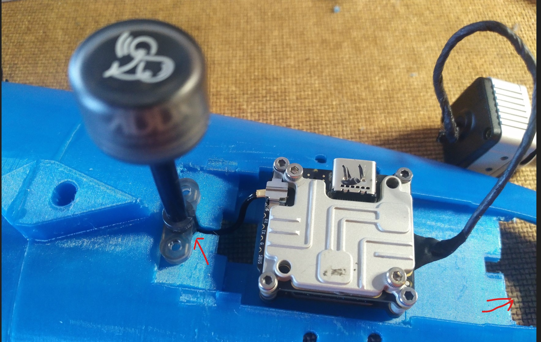

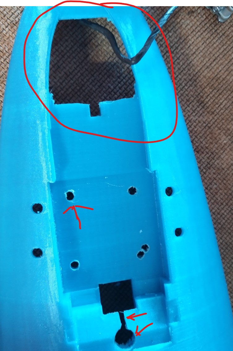

Some minor feedback on using what you posted on thingiverse with a vista. I hacked with a drill & blade but if it works out I may post a remix.
1/ The standard aerial cable is too short to make it to the aerial mount you designed. I glued in the one provided by the vista kit - see photos
2/ I tend to leave my vistas’s & camera’s in quads permanently but share one between many planes.
So.
a/ Even if I could reach the aerial mount you designed, to remove the aerial needs to be removed from the vista unit. I added a slot - see photos.
b/ The hole at the front was slightly too small to get the camera through. So, once again to remove the air unit & camera would need to be separated. I widened it with a blade.
