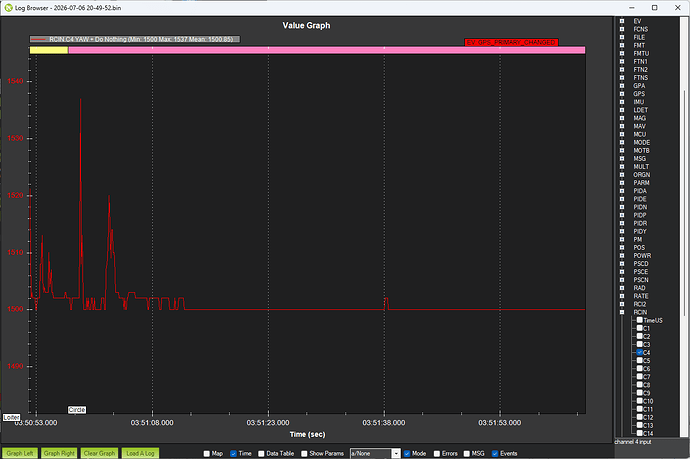

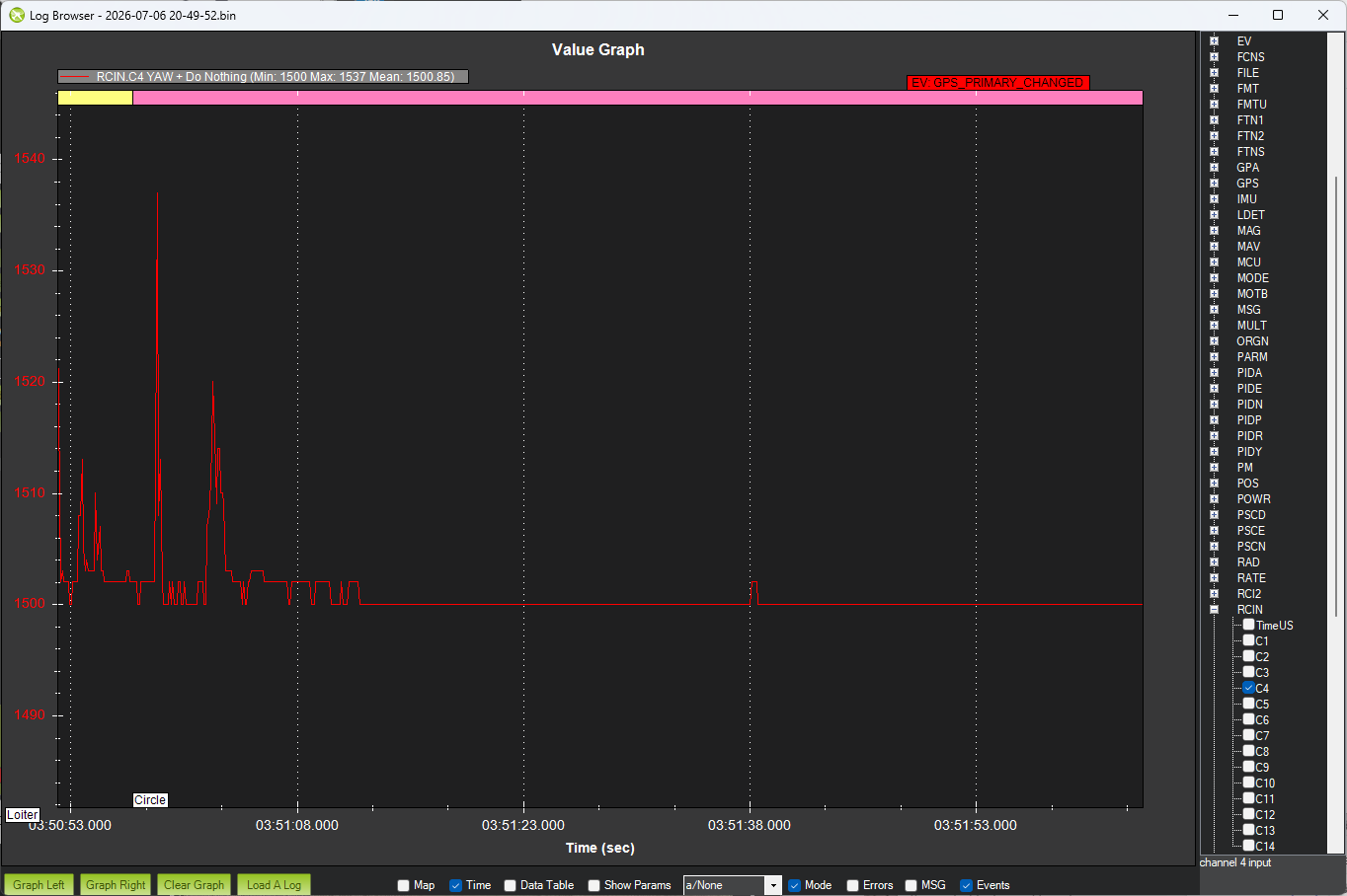

I’ve activated the CIRCLE_OPTION parameter 1, so according to the docs the copter should update the heading during circle, and it should be tangential to the circle. But it is not. It stays what it was when the copter entered the circle. Other than that, the circle is flown correctly.
The CIRCLE_OPTION is 7 here, so other parameters are also active.
The log
The ArduCopter version is 4.7.0 beta 7

Hi @maciek252,
Txs for sharing the logs. It looks like a small amount of RC yaw input appeared as the vehicle was switched into Circle mode. The RC4_TRIM = 1500 and RC4_DZ parameter is set to 20 so anything < 1480 or > 1520 would cause the vehicle’s yaw to stop rotating.
Ah thanks! Now I see, I should enter the circle mode without touching the left stick, when the loiter has already been stabilized. It must be not so simple, as I’ve tried this many times and it always behaved like this.
