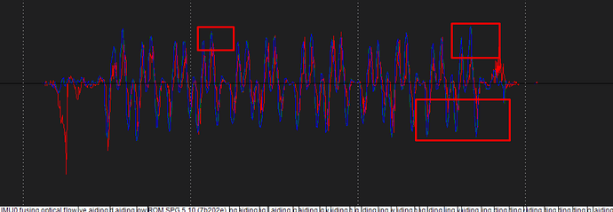

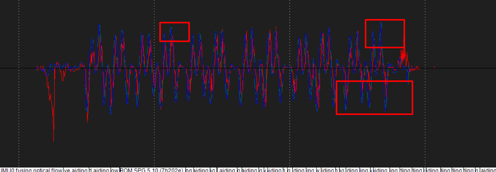

I successfully tested optical flow algorithm(locas-kanade from open cv) which was based on simple mavlink optical flow message(#100) on law altitube ~10meters,mode is loiter. Lidar was also connected,outdor range acorrding to the specification~10, so I didn’t go higher.
Basically everything was configured according to this documentation and log-based calibration, thanks @rmackay9 for detailed instructions.
Sharing some logs:
before the flight
IMU Gur.X and OF.X looks more or less precise, however there are occasional shifts at the
peaks
Then on the flight
the difference seems more significant and script apparently need lots of impovements.
However like i said testing was succesfull) the drone visually was motionless.
The couple of questions I wanted to bring up, eventhough they may seem very basic, but I’m still learing this topic…
Based on the logs If discrepancy in flight is very high does it mean that drone can stabilize just using imu + lidar data?
Can we use optical flow for navigation or its loiter only?
What should be taken into consideration when go on higer altitudes except lidar?
What are the benefits of other feature tracking algorithms?
Hi @Ketchyn,
Comparing OF.flowX and OF.bodyX is important while doing the Log based Calibration and in this situation we expect the two to be close. While the vehicle is flying though we expect them to be different because this is how the EKF calculates how much the vehicle has moved horizontally.

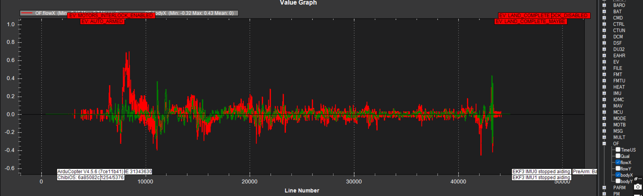

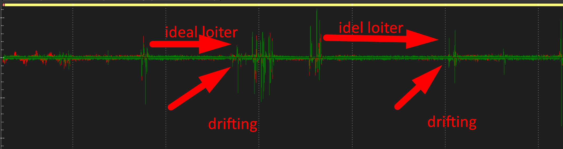

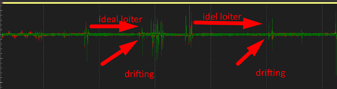

Hey Guys!
I desided to share one more test flight log here on a distance of 105 meters from the groud rather then creating new topic
Drone coud stabilize and hover perfectly but for short period of time ~2 min and then started drifting slowly on a side.
What I can see from the logs is body.x(gyro.x) larger flow.x which points to the thought of increasing scaler parameters a bit more.
One more obesrvation is gyro/flow spikes which might caused dron drift. But it Is hard to say if flow algorithm produced these spikes or its a gyro glith.
Would appriciate your thoughts @rmackay9 @snktshrma
