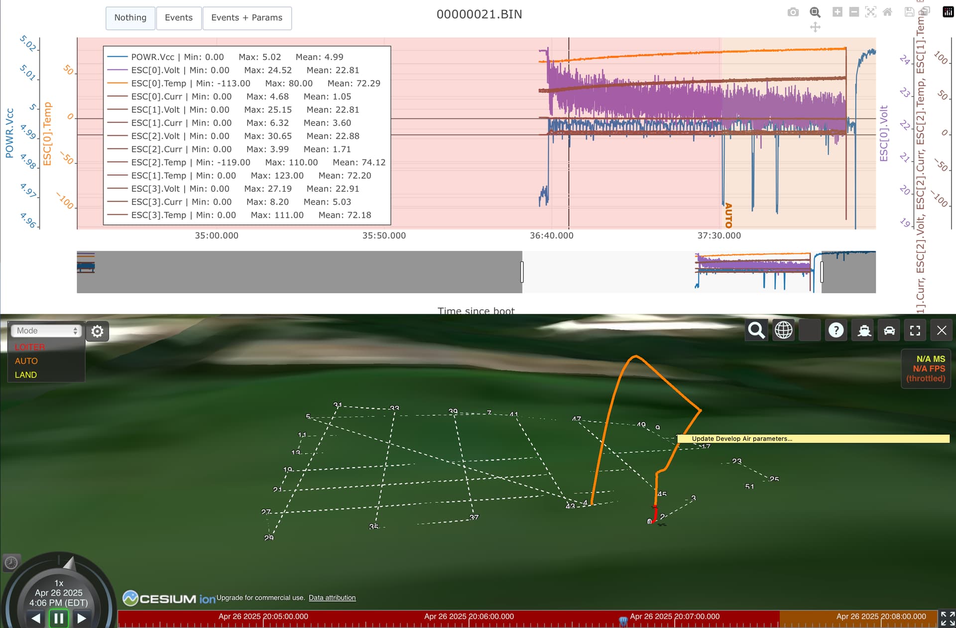

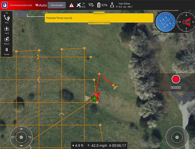

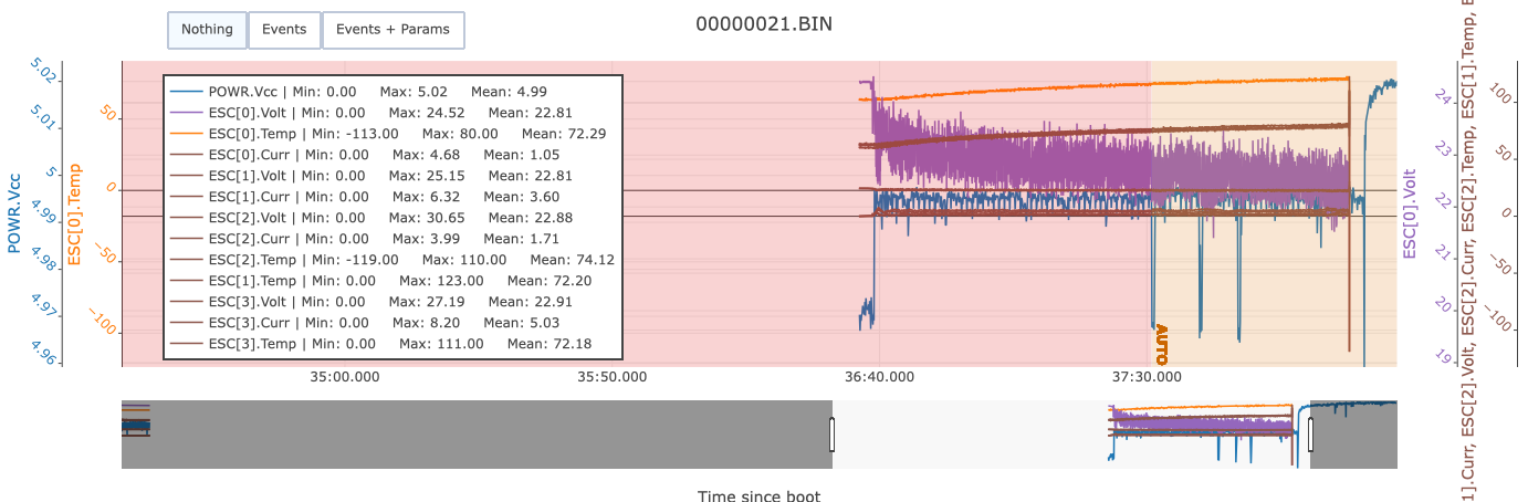

I updated a copter to 4.6 and experienced a sudden thrust loss when attempting a mapping mission with the SIYI ZT6 to test the geotagging functionality. Any help to further interpret the sudden thrust loss would be greatly appreciated. From an untrained eye, it looks like the voltage spiked higher than ideal for ESC 2 since the copter was being powered from a 6S battery, but I am not sure if this alone would be the cause the thrust loss. The temp for ESC 1 reached 123°Ç, which seems much hotter than ideal, but also not much higher than the other ESC temps. Fettec also rates this 35a ESC to operate at temps greater than 100°C.
In any case, I was able to get a parameters file from another copter with a SIYI ZT6 which produces photos with a very wrong longitude, while the latitude is correct and the altitude is as accurate as one might expect without an RTK base station or similar setup. Here are the parameters alongside a log file: HP + ZT6 Params & Log | Google Drive
Is anyone else experiencing the same issue with the longitude being incorrect or is there something wrong with how we have it setup?
After further review, it looks like a soldering joint where the BECs, power connector, and power monitor board are soldered to the main ground pad on the ESC may have made contact with the power pad. This issue aside, the incorrect longitude data issue still persists.

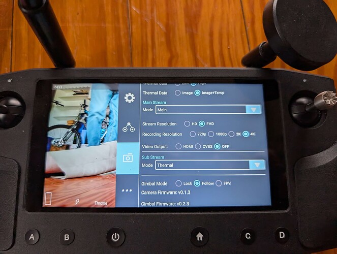

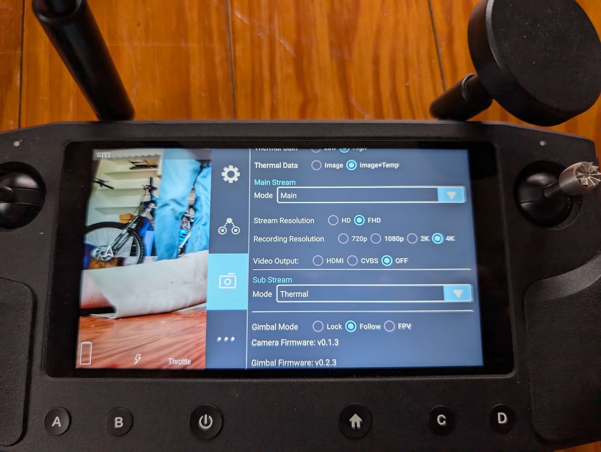

I’m quite certain that the incorrect longitude value is an issue within the camera itself. Could you tell me the firmware numbers on the camera gimbal? There should be at least two of them, one for the gimbal and one for the camera.
The ZT6 camera firmware is v0.1.3 and the gimbal firmware is v0.2.3
We last updated the firmware in February of this year. As far as I can tell, these are the latest firmware versions.
Hi @JacobTheIntern,
OK, I’ve sent a message to Siyi and hopefully we can get the fixes they sent me last year into their stable firmware
Hello! I noticed that your Camera firmware version is v0.1.3, which does not match the firmware version v0.2.3 of Gimbal firmware. You can obtain the latest Gimbal Camera firmware from the official website for upgrading. Firmware retrieval link: https://siyi.biz/siyi_file/ZT6/ZT6%20User%20Manual%20v1.2%20EN%20.pdf
Camera firmware requires the use of an SD card, please note the model of the SD card. Card swipe method reference teaching video: 云台相机卡刷相机固件教程 - Google Drive
Actually the firmware download link can be found on this Siyi page and it looks like for the camera it should be version 0.1.9 instead of 0.1.3.
