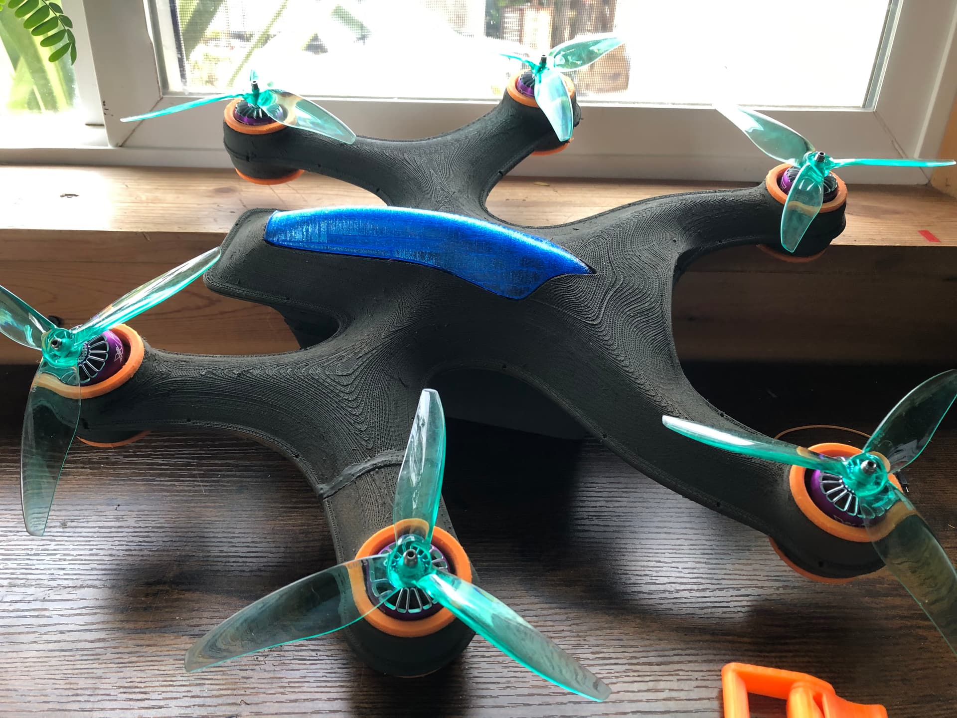

Hexa frame number 2 of five. Good flash via QGC, Compass calibration seemed to take a long ish time in Mission Planner so I getting a new GPS one on the way from mRo. Dshot driver installed fine. Motor test ok. More to come.
Installed a newish GPS and although I only had one green bar the calibration did take a little longer than normal I am getting 15 sats and the ground speed numbers look tight. Flight test went well and Dshot had a crisp feel.

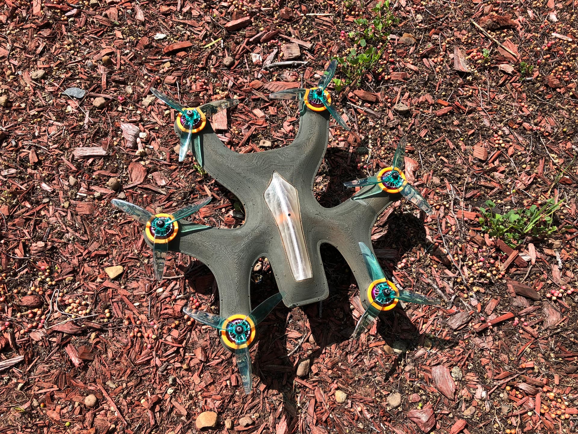

Second day of testing. Loitor flight mode. GPS does give me a error " no GPS" at times but yea I have GPS installed. the GPS is tending to drift a little. I going over some hardware checks to see it I can get a 1 m drift out. Ground effects working well. GPS break working well. GPS is mounted with 3M tape that could be a little to spongy.

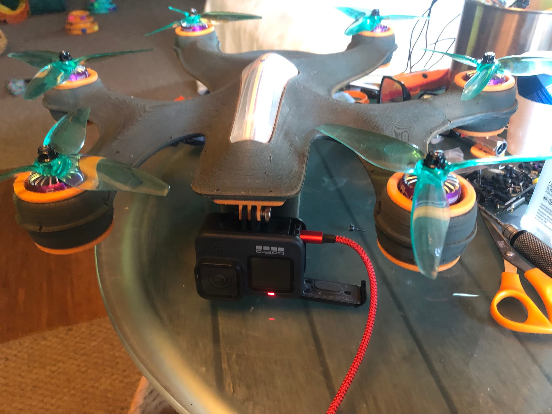

GPS seems to be failing, Yesterday used Loiter without issue. today I added a Gorpro 9 and could not get Loiter working unless it was not in the air. I will poke around. anyone seeing issues?
Note: I did a new Compass cal with the Pro attached and got two green bars.
Hi Brandon - can you send me a .bin log, via personal message if you like. I’m interested to take a look and see what’s going on. Maybe I can help / maybe I cant :slight_smile:
Hi Shawn, looks like mounting the GoPro and doing a compass cal removed the error. Just did a test flight and no issue this time.
Just got the no GPS error today but it did go away after letting the new Hexa sit on the ground after a stabilize flight.
Noteworthy was I was not able to arm in Loiter Mode until it sat on the ground. I have a new GPS coming soon. Video of the flight today first is Stabilize then Loiter flight 360 tests.
Simple camera mount:
