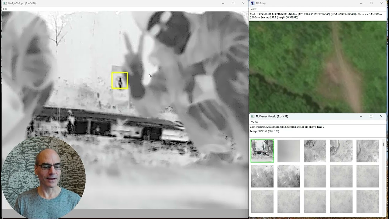

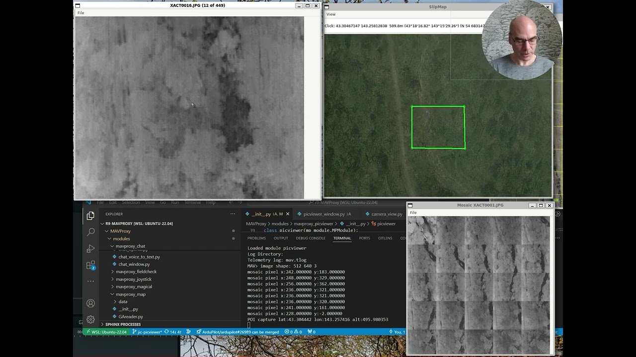

  2. We developed a new MAV Pic Viewer application to allow us to quickly review the hundreds of images we collected on each flight. Below is a video of the tool as it was being developed. It’s been improved greatly since then and will be released as part of the next MAVProxy release. The final version supports sorting the images by maximum temperature which made finding the mannequins relatively easy because they normally appeared within the first 10 images.

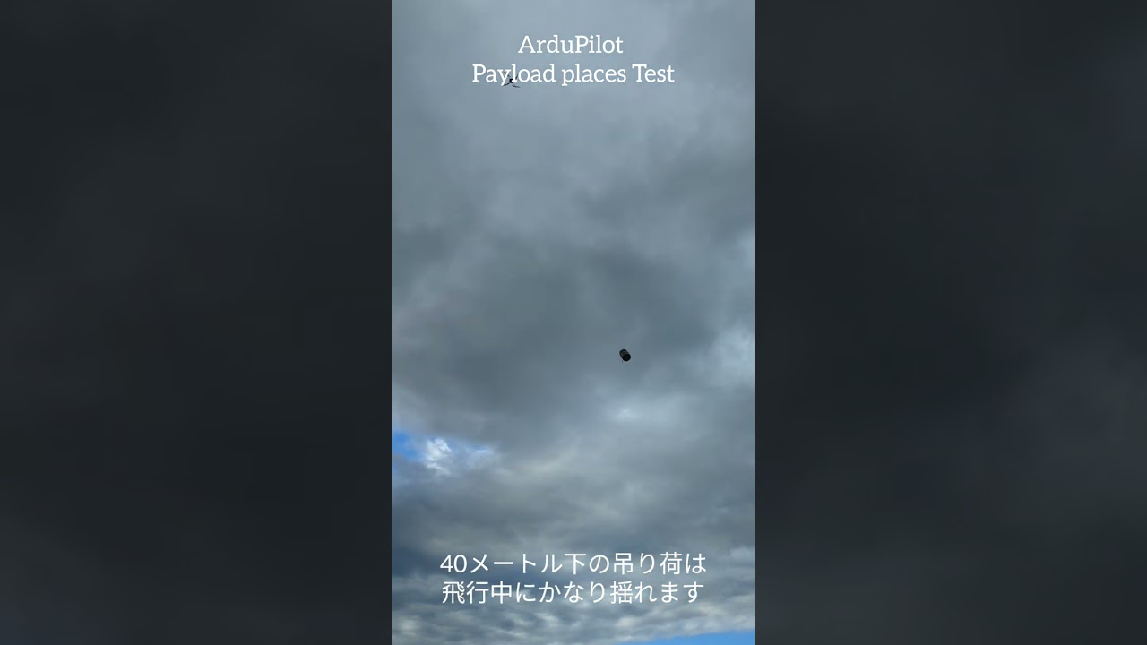

  1. Instead of using a winch we used a payload slung 40m below the delivery drone. AP4.6’s payload oscillation suppression allowed us to delivery the payload with exceptional accuracy. Here’s a video from a test done a couple of weeks before the competition. We also demonstrated this feature at the AP developer conference and so hopefully more videos of that will appear shortly

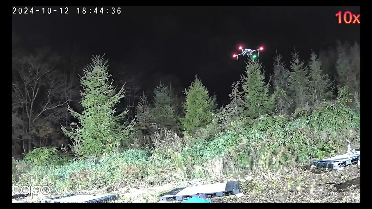

  2. Two fixed web cameras on tripods with remote control gimbals pointing at the landing pads. One was placed North of the pads and the other East. This is hardly rocket science but it saved us when the search copter twice landed next to the designed landing area. With the cameras in place it was relatively easy to use Guided and Auto mode to re-do the landing

Here’s a video from the fixed camera next to the takeoff/landing pad

MAVPicViewer is part of MAVProxy and its code is here.
Thanks for the link to another option for semi-solid state batteries!
I’m not quite sure what you mean by “automatic tracking of your drones using ONVIF” but ArduPilot supports many different camera gimbals from various manufacturers. We used the Siyi ZT6 which has a custom serial interface (that AP has a driver for). The camera stores the vehicle’s location using EXIF in each image taken and the MAVPicViewer uses this plus AP’s terrain database to calculate the lat, lon, alt of any pixel that the user clicks on within an image.
The drones were flown on long-ish autonomous missions of between 13km and 20km with the camera always pointing downwards and the vehicle always pointing North. After the vehicle returned (or sometimes on its way home) we downloaded the images and analysed them with MAVPicViewer.

By “automatic tracking of your drones using ONVIF” i ment the camera on the ground on the tripod. AFAIK its not trivial to let it follow drones in a automatic way.
Hi @julled,
Ah, so having a camera that can automatically follow the drone would be nice but at the moment the closest we have to that is Rover’s follow mode. If the Rover has access to the vehicle’s mavlink stream then it can point the camera gimbal at it.
The other option is Asif Khan’s work on visual follow-me but it requires a full autopilot and a companion computer.
Probably the easyest way would be using Antenna Tracker but with a camera instead of a antenna
Here’s an updated video of the image review tool
Hello, I am interested in your content. Especially mavpicviewer, but when I downloaded it from the link you provided, and installed it using setup.py on Ubuntu after starting mavproxy, I did not find the mavpicviewer button in the console. Could you please tell me how to install mavpicviewer?
Hi @Negan_Jeffrey,
Thanks! So, it’s stuck waiting for the next mavproxy release. I think that will likely happen within a week or so. A couple of the devs are off for a few days so it probably won’t be until next week… but soon
