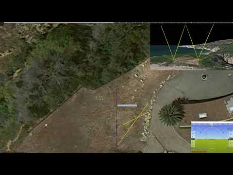

This discusion may be related to something I have not been able to do in months in the real thing and in SITL: mix in a mission waypoints referenced to Terrain (third parameter 10 (rangefinder)) and Relative (third parameter 3 (barometer)).
This mission in SITL shows it: three W’s in a vertical plane referenced Terrain/Relative/mixed. The mix is:
-High W points Relative (third parameter 3 (barometer)).
-Low W points Terrain (third parameter 10 (rangefinder)).
QGC WPL 110
0	1	0	16	0	0	0	0	33.74113111	-118.374600	44	1
1	0	3	22	0	0	0	0	33.74116111	-118.374600	1.00	1
2	0	3	201	0	0	0	0	33.74111111	-118.375	1.00	1
3	0	10	16	0	0	0	0	33.74111111	-118.37472222	4.00	1
4	0	10	16	0	0	0	0	33.74117111	-118.37472222	1.00	1
5	0	10	16	0	0	0	0	33.74124111	-118.37472222	4.00	1
6	0	10	16	0	0	0	0	33.74117111	-118.37472222	1.00	1
7	0	10	16	0	0	0	0	33.74111111	-118.37472222	4.00	1
8	0	10	16	0	0	0	0	33.74105111	-118.37472222	1.00	1
9	0	10	16	0	0	0	0	33.74099111	-118.37472222	4.00	1
10	0	10	16	0	0	0	0	33.74105111	-118.37472222	1.00	1
11	0	3	16	0	0	0	0	33.74111111	-118.37472222	20.00	1
12	0	3	16	0	0	0	0	33.74117111	-118.37472222	1.00	1
13	0	3	16	0	0	0	0	33.74124111	-118.37472222	20.00	1
14	0	3	16	0	0	0	0	33.74117111	-118.37472222	1.00	1
15	0	3	16	0	0	0	0	33.74111111	-118.37472222	20.00	1
16	0	3	16	0	0	0	0	33.74105111	-118.37472222	1.00	1
17	0	3	16	0	0	0	0	33.74099111	-118.37472222	20.00	1
18	0	3	16	0	0	0	0	33.74105111	-118.37472222	1.00	1
19	0	3	16	0	0	0	0	33.74111111	-118.37472222	20.00	1
20	0	10	16	0	0	0	0	33.74117111	-118.37472222	1.00	1
21	0	3	16	0	0	0	0	33.74124111	-118.37472222	20.00	1
22	0	10	16	0	0	0	0	33.74117111	-118.37472222	1.00	1
23	0	3	16	0	0	0	0	33.74111111	-118.37472222	20.00	1
24	0	10	16	0	0	0	0	33.74105111	-118.37472222	1.00	1
25	0	3	16	0	0	0	0	33.74099111	-118.37472222	20.00	1
26	0	10	16	0	0	0	0	33.74105111	-118.37472222	1.00	1
27	0	10	21	0	0	0	0	33.74119111	-118.374600	0.00	1
The first two W’s are followed normally. For the third, after starting on the high waypoint (third parameter 3), it happens as if it wouldn’t “know” how to go to the following low waypoint (third parameter 10, blue above), “Failsafe terrain data missing” is heard, and the vehicle does an RTL.
This is the video capture:
RTL occurs at t=155s, as appears in the video index.
I don’t know if I am missing something, or this a system limitation I can’t find documented. I have asked about this in the past, resulting the answers the Empty Set ∅.
This happens also in the real thing on all versions I have tried.
This is the SITL parameters file with relevant aparameters:
RNGFND1_MAX_CM 700
TERRAIN_ENABLE 0
Something missing? Is the mixture allowed? Explanation if not?

Looking in detail at the beginning of the third W (mixed 3/10 Relative/Terrain):
Waypoint 19 is at 20m (> RNGFND1_MAX_CM), defined Relative (third parameter 3), and is reached.
Waypoint 20 is at 1m (< RNGFND1_MAX_CM), defined Terrain (third parameter 10), and is not reached ( “ Failsafe terrain data missing ” is heard, and the vehicle does an RTL).
If you go directly to the beginning of the third W, and observe the PIP image (up right) you will see what happens immediately.
Do you mean that it cannot reach a waypoint within rangefinder range (referenced Terrain third parameter 10) from a waypoint out of rangefinder range (referenced Relative third parameter 3) by design? It is hard to accept that.
I simply want to use the rangefinder (which works accurately in the first W (all waypoints Terrain, third parameter 10)) to go from a high point to a low point close to ground accurately.

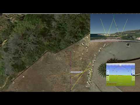

@Webillo,
Txs for the extra detail.
After the vehicle passes the waypoint at 20m (rel) and starts towards the waypoints with 1m (terrain) alt it immediately needs to know its altitude above terrain. The reason is that it does not fly a straight line from the rel waypoint to the terr waypoint, instead it flies from it’s current alt above terrain to the waypoint’s alt-above-terrain. The terrain following wiki page’s Warning section has this picture which may explain this.
You hit the nail! Thinking in terms of a “straight line” suggests the solution: before any Terrain waypoint from a Relative one insert a Relative one with same lat/lon coordinates, and height within rangefinder reach:

So this is the final video:
Note the transitions.
The PIP (up right) doesn’t show now the RTL trace.
I hope to try the real thing shortly.

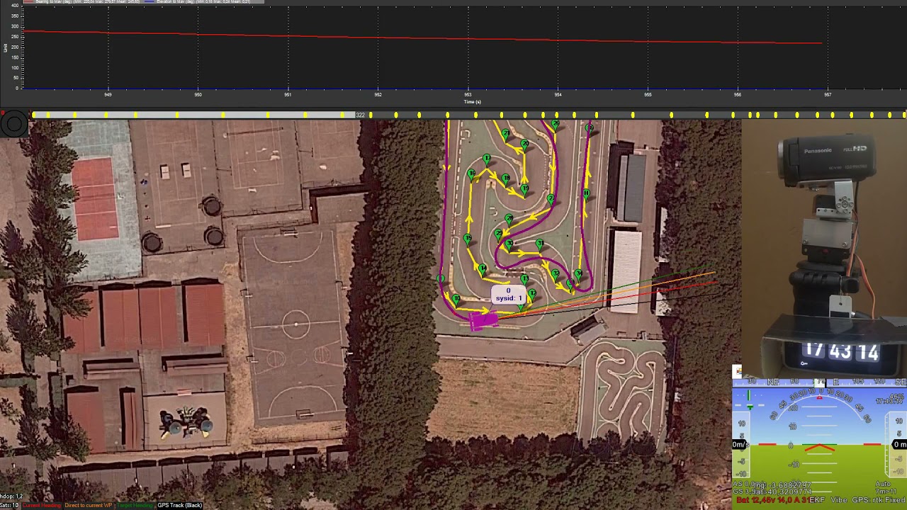

This is the real thing, with MP tracking.
Nice, and what also really stands out to me is you’ve got the antenna tracker controlling the camera. I’ve always wanted to do that.
See this. MP works decently well for this; after all, it has all the information after being informed where the tracker is.
You need:
I have pending:
  • Improve pan support.
  • Perhaps try a brushless version.
MP possible improvements:
  • Not sure when servo angles start being output, needed for adjusting offsets before flying. Ideal if just after GPS lock.
  • Pending to test rover in circuit, with tracker above it (done in SILT). I use now a Python script for informing MP that tracker is 4m above rover.
Try it: real fun.
This servo wheel and L piece (attached to the pan servo support), and having substituted the tilt servo support seen in video above
drastically improve tracker stiffness, as can be seen on this video:
There is shown an optional additional spacer around the pan servo wheel.
Next improvement will be a ball bearing on the pan servo wheel:
Here is the gimbal with ball bearing on the pan servo wheel on a rover SITL simulation (tracker up on drivers podium):
Here is the same SITL but on a tlog capture showing the angles (AZtoMAV/EleToMav):
Although the camera moves correctly, these angles are inconsistent:
  • AZtoMAV: goes to zero on the straight beside podium (should vary between 190Âș and 350Âș)
  • ELtoMAV: should be clearly under 0Âș all the time (tracker several meters above car)
