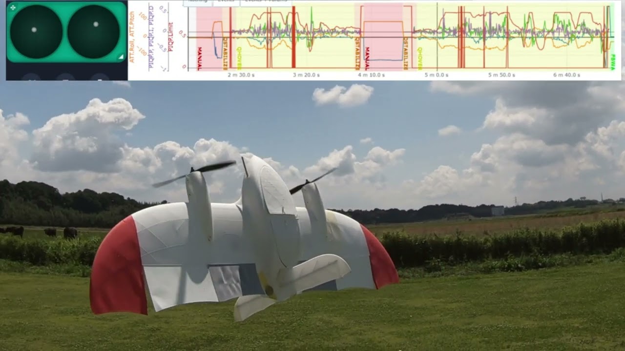

Trying high lean pitch angle in hover. Set Q_ANGLE_MAX=70, Q_TAILSIT_INPUT=3 (roll by bodyframe). Unfortunately elevon oscillates at higher lean angle, needed to limit pitch angle. Thought it may be elevon movement saturation but symptom (PIQP.Limit=1) does not match oscillation in the video. Think need further tuning tweak. Wish I can fly this beautifully like losawing’s, but miles away…
Maneuvers are mostly rudder turn, even applying reverse aileron.
It is 4.2.0, log is here.

To stop oscillations at high lean angle is just a question of tuning gain attenuation. The disk theory gain attenuation gives beautiful resut You may have to reduce (a lot) the disk load parameter and/or the min scale parameter.
Yes, rudder stick is the main command. The roll stick has to be applied in reverse direction (roll stick right to face left like a 3D plane when prop hanged) at low lean angle and in the same direction than the rudder stick at high lean angle (when the tailsitter begin to fly like a plane), This is very logical but need to be used with. You can imagine that when flying inverted this is even more compicate. :slightly_smiling_face:

Tried with lower Q_TAILSIT_DSKLD and improved. Lowered DSKLD to 5 down from 10, then 4. Unfortunately lost attitude and crashed bad, rebuilding another one.

Config #3 high lean pitch flight with lower Q_TAILSIT_DSKLD
Log is here
Attitude is lost during elevon saturated. Plane is yawing with C4 then C3 maxed, then left motor C1 kicked in, then C2. Too low to recover.
Not sure the exact cause, at least this plane’s envelop is still tight with smaller elevon. Also I think side slipping during turn can lead to this critical situation. Need to practice well, it is getting similar to 3D flying…

So much progresses since the beginning, the Eclipson VTOL is now flying pretty well.
About the crash, 1s before the plane hit the ground you had the belly of the plane in front of you and from the log you pushed yaw stick left (rcinC4 lower PWM if I am correct) so the plane rolled left as it should but relative to you it produced a right roll.
edit: when looking at stick position (overlay top left in the video) the left stick order only occur after the crash !! is it a overlay synchronization problem or my log analysis is wrong ?
About gain attenuation, maybe you will get less control surface oscillation by reducing q_tailsit_gsc_min, only tests will tell us.
To improve control, it would be interesting to test larger prop. This is something I never tested. Relative to the E-VTOL wing span, 10 inches propellers seems correct and you motors can spin them on 3s easily. From my side I dont like slow fly prop, I use this kind CW/CCW, they are more efficient, draw less amp and are very light.
They are not as good as Graupner genuine ones but good enough for tests.
Edit 2: @Satoru_Sasaki you do not use q_tailsit_rll_mx parameter so your tailsitter is allowed to roll up to angle_max and 70° is way too much. This is very likely why you crashed your plane. I suggest 40° for q_tailsit_rll_mx , 50° is an absolute max.
