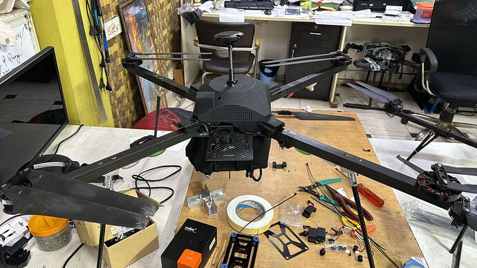

my quacopter is 1mx1m using mn6007 t motors antigravity and 60A tmotor flame esc with pixhawk orange cube with here 4 and siyi mk32 air unit and tx. i am getting this error " gps1 failing to configuring this gps" very frequently like almost every 20 seconds whenever the drone is on ground and when its ready to arm i immediately arm it and fly then i dont get any error in gps but once triggered rtl it goes into land mode dont know why? and also my drone is very unstable is flies like it might crash. cant handle wind properly like i can hear twitching sound in motors but after performing quicktune through lua script it has been improved but i have vibrations especially on y and x but y is crossing 80 and its red and also i tried to auto tune it @Michael_Oborne it gets an error message Autotune: failing to level, please tune manually. could anyone help me with ythis as im stuck i have put a damping mount on my drone and mounted fc on it, please check logs and let me know why i am not able to completely stabalize this drone. please help me, i will also attach images of my drone .

My guess is that your vehicle does not follow these rules especially the very first one. Those arms look very long and flexible.

The arms are secured with two screws and hot glue, if I see it correctly? And the top plate is mounted to the bottom plate via the arms only? Not surprised you’re getting high vibrations.
I’d try reinforcing the arms properly and connecting the top and bottom plates separately. Something like this (X4):

yes i have now placed rubber standoffs inbetween the frame and il get this type of holding 3d printed and see whats the result
