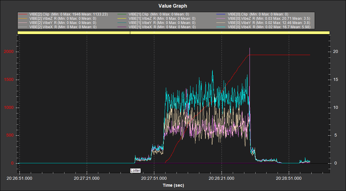

I did the flight again and switched to the older firmware as you recommended. I initially tried to takeoff in stabilized mode and had the same issue: the cockpit was tilting toward the left. So I aborted the takeoff.
After that, I tried to fly the drone in loiter mode, and with the same setup and without any changes, the drone was able to take off in loiter mode.
It’s a bit strenuous, as the mission planner recommends doing the flight in stabilized mode.
Here are the flights logs of today test: Flight logs - Google Drive
You are using old firmware thus have posted in the wrong place. Update to latest Stable.
And your craft is underpowered/overweight;
The average output here should be close to 1500µs at Hover.
Can you do a check on this?
As @dkemxr said, your drone motor and propeller combination thrust may not be sufficient for the entire drone. Usually, MOT_THST_HOVER will be 0.25 and below. besides that, the graph looks normal expected. CubeBlack, there may be a wrong configuration as a result of logged high vibration.
