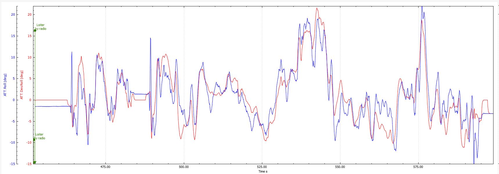

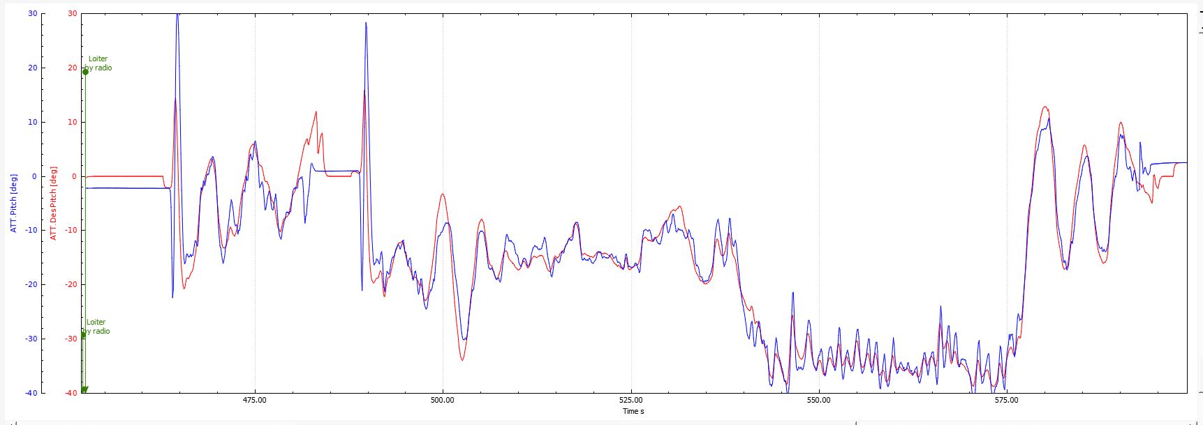

A few things I notice with this configuration. Tuning is not great. It’s not typical that the Rate I term is higher than P. Did you manually lower P? Stabilize Pitch and Roll look low also for this craft. These F450’s fly pretty well on defaults.
Roll is poor
Pitch is poor

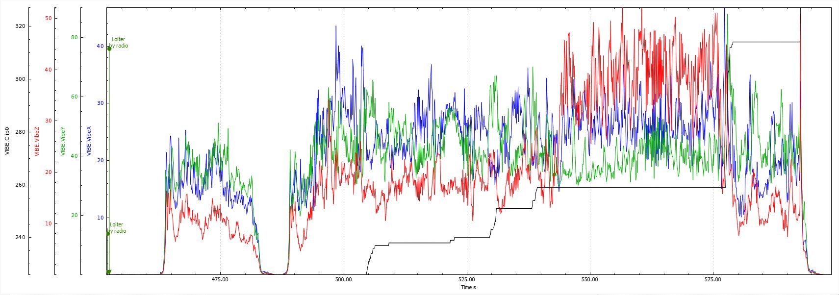

Vibe levels are very high with Clipping. How is the FC mounted? You can’t rely on the internal damping of this FC it’s minimal.

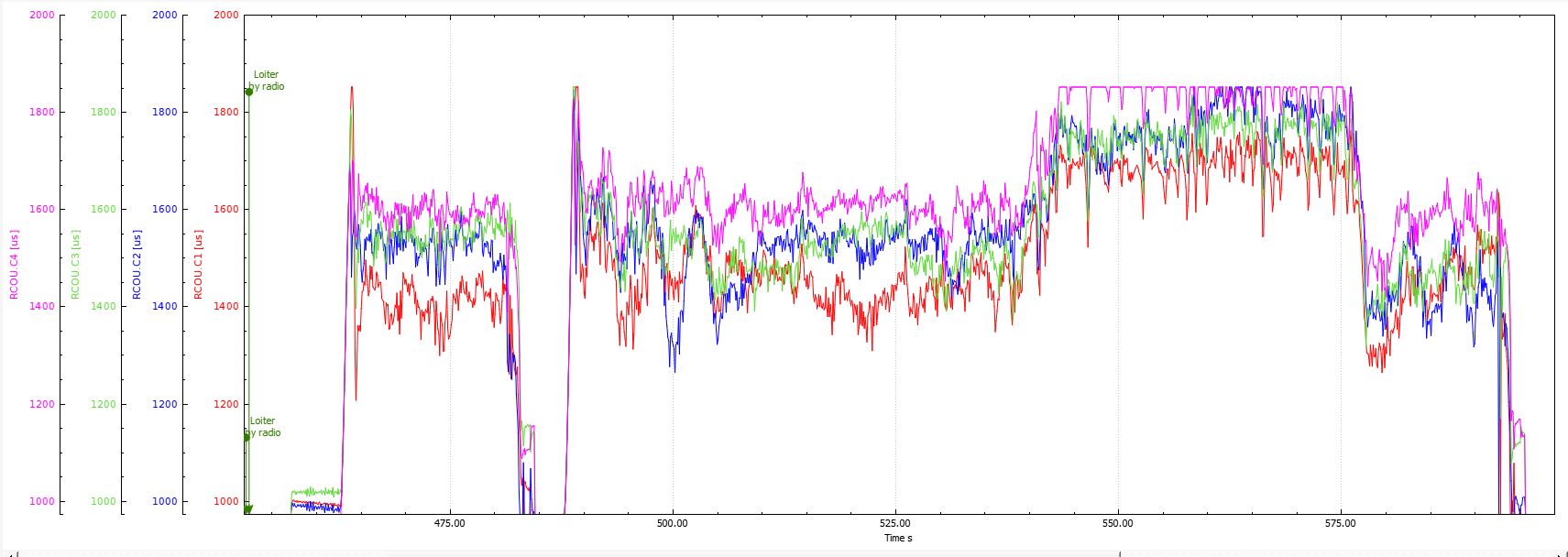

And with fast forward speed some motor outputs are commanded to max compromising stability:
You certainly don’t want to use a smaller prop the average motor output is a bit higher than you would want now with the 11" props and they are not that well balanced (motor output balance)

OK, maybe they need to be softer or the props are way out of balance. The vibe levels are too high to achieve an optimum tune. And as I said the IMU isolation foam on the Kakute F7 is not worth much. OK for Betaflight but unless you have a very rigid frame, which is the opposite of the F450 noodle, you need better isolation for Arducopter.

Vibration Compensation Failsafe occurred in log 93. And as I posted before with Fast Forward Flight your motors are commanded to max and you lose stability. That craft as configured is not capable of this. Fly fast and risk a crash.
