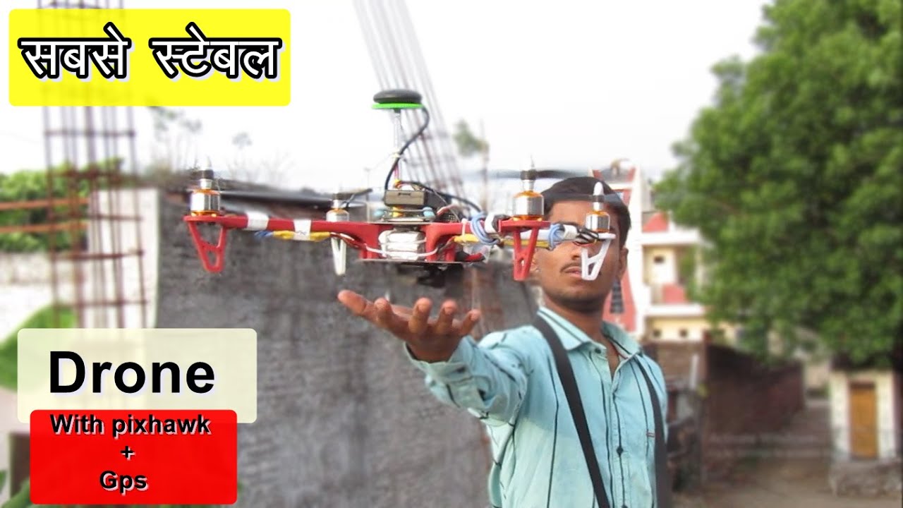

Also @dkemxr, I was wondering how these people are able to achive this kind of stabilty with all the hardware that matches mine and you have mentioned in hardware to avoid. Is this because of tuning the quad. https://www.youtube.com/watch?v=CRVceIn6xIk&t=6s
Regards
Those are probably both the same and the “carbon” is bullshit or what is coloring it black. I would go with the 1045’s.
I have not seen many, if any, achieve good performance and I have seen these craft on the forum for many years. I had this kind of craft (but not those junk motors) in 2014 and pushed it as far as it would go even with replacement G10 arms. Which just exposed how shitty the frame was. It is not worth spending the money on anything on that list IMO. And if your school is offering this stuff they are doing their students a disservice. Ask your instructors to contact some reputable manufacturers (preferably Ardupilot partner companies) and make the case for donated gear.
If you see, in this video, he is using exact same config as hardware to avoid components still the quad is super stable. Do these Pixhawk’s also matter? Like can his pixhawk be a better chinese clone than mine. Also: He is using a Pencil stand as the GPS mount
One person’s idea of Stable means nothing.
