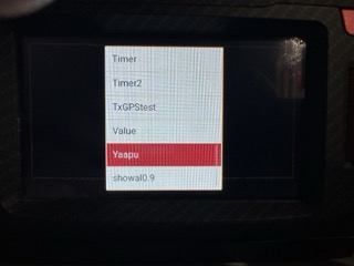

SOLVED - See that little switch in my pics called “Flight Mode”? Well, it wasn’t called out in the instructions anywhere (new stuff in EdgeTx all the time), so I didn’t turn it off - had this “full screen required” error that perplexed me for some time.
Well, turn it off too, and the Yaapu scripts load up fine…cd
