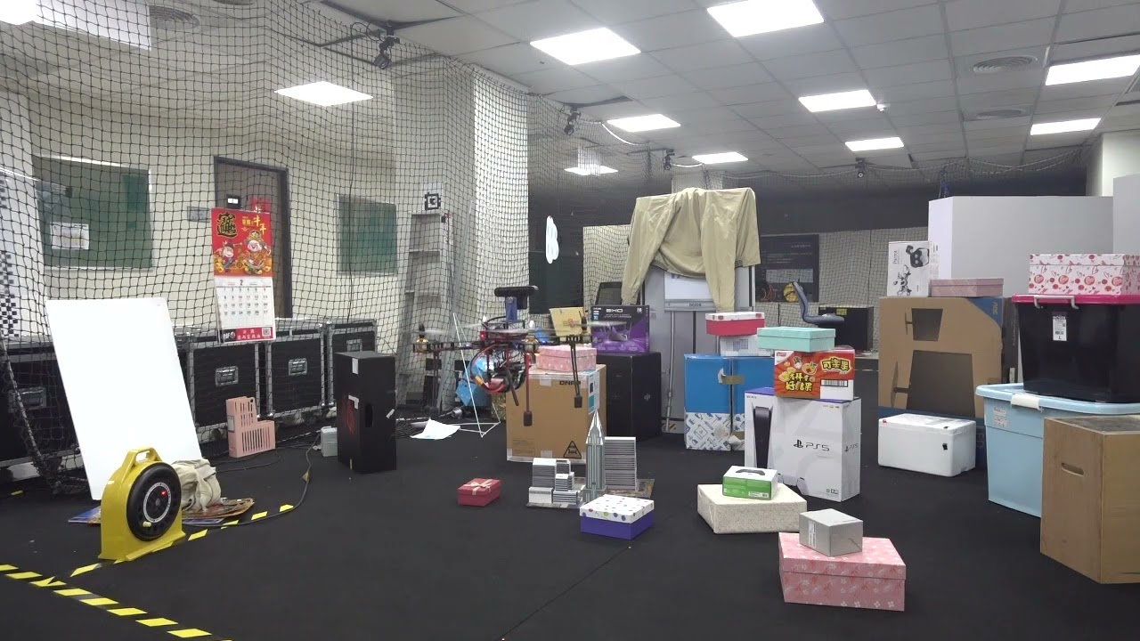

The goal of this project is to build a small, affordable and easy to setup VIO system which can be carried by small drone. Usually, powerful CPU or GPU is required for a VIO system because of image processing and feature tracking jobs. In this project, I will offload computer vision jobs to OAK-D and let Raspberry Pi focus on pose estimation. It is inspired by Sara Lucia Contreras Ojeda’s thesis “Robot pose calculation based on Visual Odometry using Optical flow and Depth map” and SLAM with OAK from Luxonis web site.
Hardware:
Luxonis OAK-D (I think OAK-D Lite is lighter and cheaper therefore more suitable, but I only got a second-hand OAK-D here)
Raspberry Pi 4
Software
ArduCopter 4.4.4 is used here
Slight modified VINS-Fusion
A small programm processing feature tracking result from OAK-D
Another small program sending VIO data to ardupilot
Hardware wiring
Software architecture
Installation
  1. install depthai-core
  2. install ROS Noetic
  3. clone & build GitHub - chobitsfan/VINS-Fusion at oak_d
  4. clone & build GitHub - chobitsfan/oak_d_vins_cpp
  5. clone & build GitHub - chobitsfan/mavlink-udp-proxy at oak_d
Ardupilot setup
SERIAL1_PROTOCOL 2
SERIAL1_BAUD 1500
EK3_SRC1_POSXY 6
EK3_SRC1_VELXY 6
EK3_SRC1_VELZ 0 (you can set it to 6 after testing result stable enough)
EK3_SRC1_POSZ 1
EK3_SRC1_YAW 6
VISO_TYPE 1
VISO_POS_M_NSE 0.5 (you can lower it after testing result good enough)
VISO_VEL_M_NSE 0.5
VISO_YAW_M_NSE 0.3
VISO_DELAY_MS 60
on Pi 4, Run
  1. roscore
  2. oak_d_vins_cpp/feature_tracker
  3. mavlink-udp-proxy/mavlink_udp
  4. rosrun vins vins_node catkin_ws/src/VINS-Fusion/config/oak_d/conf.yaml
Loiter test flight video
vins-fusion rviz
log
17 2024-2-5 PM 03-57-12.bin
