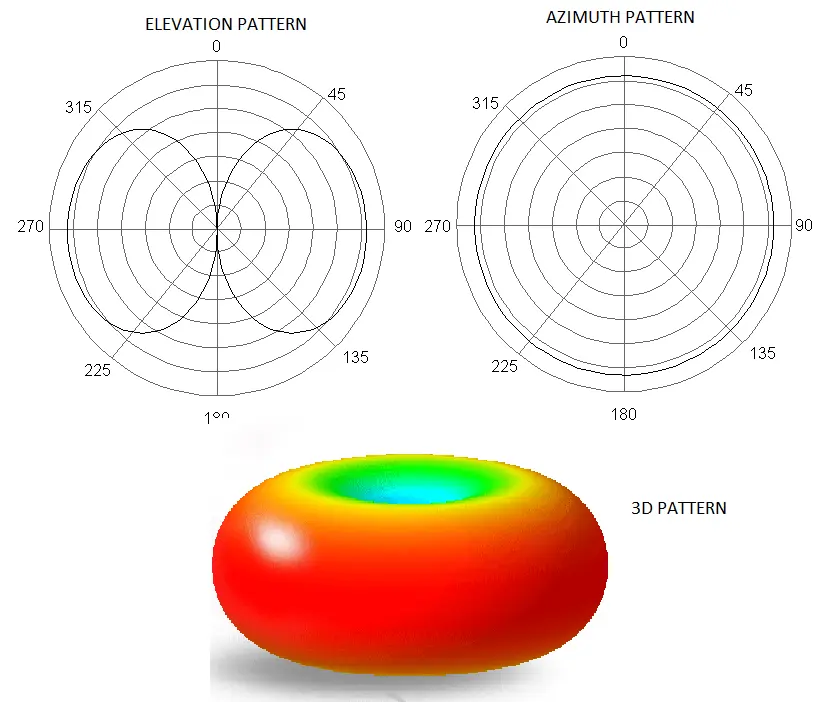

Are You sure about the flat side changing the reception?
I will try but my understanding of an omnidirectional antenna is a round horizontal donut shape.
https://www.mpantenna.com/wp-content/uploads/2019/09/omni-antenna-pattern.png.webp
Im not using the patch antennas. I found them having not as good reception.

When I seach the forum an other sources I find that the antennas should be not closer than 5cm apart and someone says one antenna is enough (which I think is not a good idea)
I am not sure what the principle behind those 2 antennas is.
Are they formimg a special desired radiation pattern by interfering each other or is one for sending and the other for reception.
I can see in archangels video that he has the gs antennas tilted im a way that they face 90 degrees offset one from another. Like so:
Not sure if this was on.purpose or by accident.
Others like joshua bardwell on youtube have videos about omni antennas and the positive effects of just this antenna position mentioned above.
I know its not siyis responsibility to teach us about antenna characteristics and all the other complex fields that have little to do with the hm30 system and more with ardupilot in general or network protocol like the lan switch topic.
Just some basic information here and there would be helpful.
So.my question to siyi about the antenna setup is:
Is this a diversity setup so both antennas interacting or send receive?
If it is required to have the antennas in a specific direction to get more than 200-500 meters this should be mentioned in the manual.
