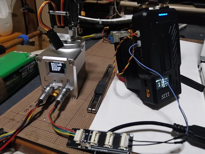

By the way, I bought an MFD mini crossbow and am currently wiring it. Is this okay?
Crossbow # 1 to HM30 UART TX pin.
The rest is between grounds.
With this, it doesn’t seem to be linked at all.
Tx on HM30 and Gnd are correct.
The pics does not show where the files are connected to the Print.
There contact 1 and 4 (Gnd) is correct.

Another idea to check.
Did you set the Baud Rate in the Tracker and HM30 to the same value?
I adjusted the baud rate.
I have set up the crossbow and HM30, but it seems that they have not been opened yet.
I don’t know what’s wrong.
As you can see in the picture, it seems that the U3RX data of the tracker has come.
Is it still necessary to set PIXHAWK?
What should I have to prepare materials to show what is wrong with me?
What do you mean with “set” Pixhawk?
The tracker needs the Telemetry data stream.
Air Unit and Flight Controller must be powered. The GPS at the Vehicle must receive Sats.
I sat the BaudRate for Telemetry in the FlightController, the Tracker (AAT) and the HM30 to 56 200.
Can you see the telemetry data on your Phone or Tablet like here with the MP for Android?:
You probably mean 57600 baud (not 56200), which is a very common baud rate for MAVLink stream.
Yes, of course, thanks for the tip.

Does QGC work?
It could be the flight controller firmware compatibility issue.
Yes if I connect to QCS it work normally.
In the crossbow instruction manual,
”Crossbow AAT needs both these 2 MAVLink messages to track.
MAVLINK_MSG_ID_GPS_RAW_INT
MAVLINK_MSG_ID_GLOBAL_POSITION_INT ”
However, I can’t find this command in my Pixhawk in the first place.
My Pixhawk may be strange.
Also, my HM30 does not have the PINK circle column in the picture below.
Actually, my HM30 has not upgraded the firmware.
I have a lot of experience with upgrade bugs in the past.
Do I still need an upgrade?
I don’t know where to store the Siri Assistant.
What about my second question? :anguished:
“Can you see the telemetry data on your Phone or Tablet like here with the MP for Android?”
If you can see the infos of the vehicel, you are shure that the telemetry works.
And then the necessary data for the tracker are normally inclouded.
If not, the params for Serial… are not set as described in the tracker manual.
