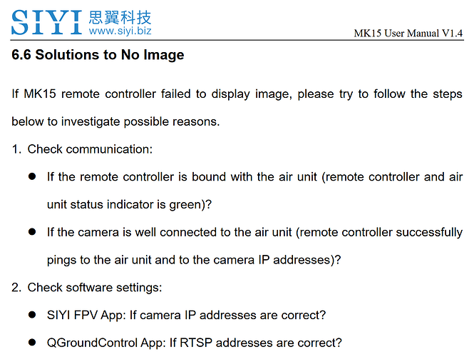

@SIYI can i get old firmware for zr30 gimble camera because after update the firmware i didn’t get feed in mk15 tx
Please confirm if you successfully flashed all three firmware by following the video below.
If you have changed the IP addresses before flashing, the new firmware will reset the IP addresses to 192.168.144.25
Hey, all the three firmwares have been flashed as shown in the video. The IP address is also 192.168.144.25
The link status in tx is showing connected. Bit i am still not able to receive the feed from the camera
I am attaching the required photos and videos of the same.
Thanks
https://drive.google.com/drive/folders/1OKqZFQO8yTIBhAf_7p6TKuJAyQReKDix?usp=sharing
  1. Please update the SIYI FPV app
  2. Please check the IP addresses settings in SIYI FPV app
  3. Please follow this part in the MK15 user manual
The camera is disconnected on SIYI FPV app although the status indicator on air unit is solid green. The Camera IP addresses are also correct.
Then please check the Etherent switch on MK15 by following the manual chapter 6.6.
Checked the ethernet connection as well. The Siyi FPV still shows disconnected.
Please check the video attached.
