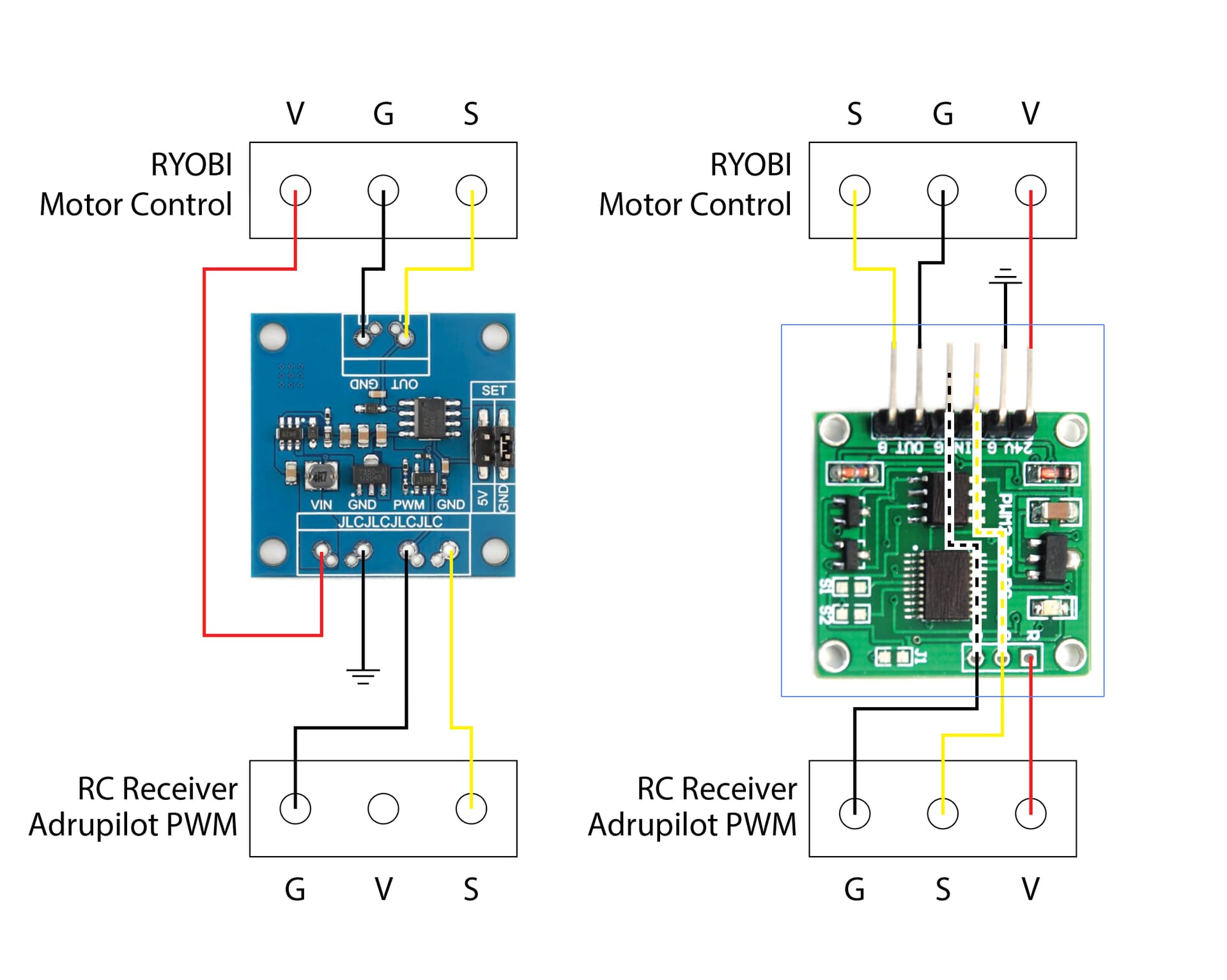

If you wanted to go with an actual RC PWM to voltage converter they are out there.
I would worry a bit about tying this to the motor ESC (they are noisy and might fry the PWM to voltage converter). It would give you a lot more linear response and full range of voltage). A low pass filter will be more damage resistant or even the potentiometer- servo setup. No spurious voltage spikes can get back into the flight controller on the potentiometer-servo setup.

With the servo adaptor, I was going to see about attaching it to actual Ryobi hall effect sensors. This way I would not have to worry about tying anything in. Just a bypass switch to go between the hall effect sensors on the mower’s control arms and the external hall effect sensors for the Adrupilot.

Most of those PWM to voltage converters you listed are not for the right frequency. They have to say for RC use which makes them work at 60 Hz.
Thanks, I was able to cancel them. Kept one, stated it had a input signal frequency: 22Hz- 20kHz. Something to play with…
I ordered two types of RC low pass filter, one you suggested and one that I found that was in the 60Hz rang. Not quite sure about the wiring. Here is a diagram of both modules with what I think is correct.
Any suggestions/corrections would be greatly appreciated.
The wiring looks fine to me, as far as I understand things. Those are true digital PWM voltage converters (at least the one on the right is and it should have a linear output curve). The other one is a motor controller that should work in the frequency range you need. It might have a linear output. I am not sure if the output being linear matters that much.

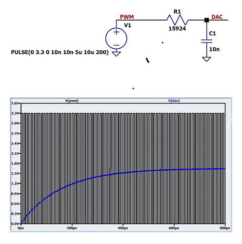

A simple RC low pass filter looks as follows:
It just a resistor and capacitor.
@Kevin_OBrien had mentioned he was going to try an LC low pass filter on his Ryobi interface. I would be curious to know how that worked. I think a low pass filter made of a resistor, inductor, and a capacitor would make a better filter.
Some info:
https://www.allaboutcircuits.com/technical-articles/low-pass-filter-a-pwm-signal-into-an-analog-voltage/

I don’t believe any of those adapters will convert an RC PWM signal. RC pwm is a pulse between 1 and 2ms every 50ms so its only effectively changing by 2% you would need something to read it as a protocol not duty cycle.
I would believe @geofrancis. In the article mentioned, all the examples are at much higher frequencies. That is all industrial motor control stuff. That digital 60hz PWM to voltage converter should work just fine though, it was designed for RC control stuff.
