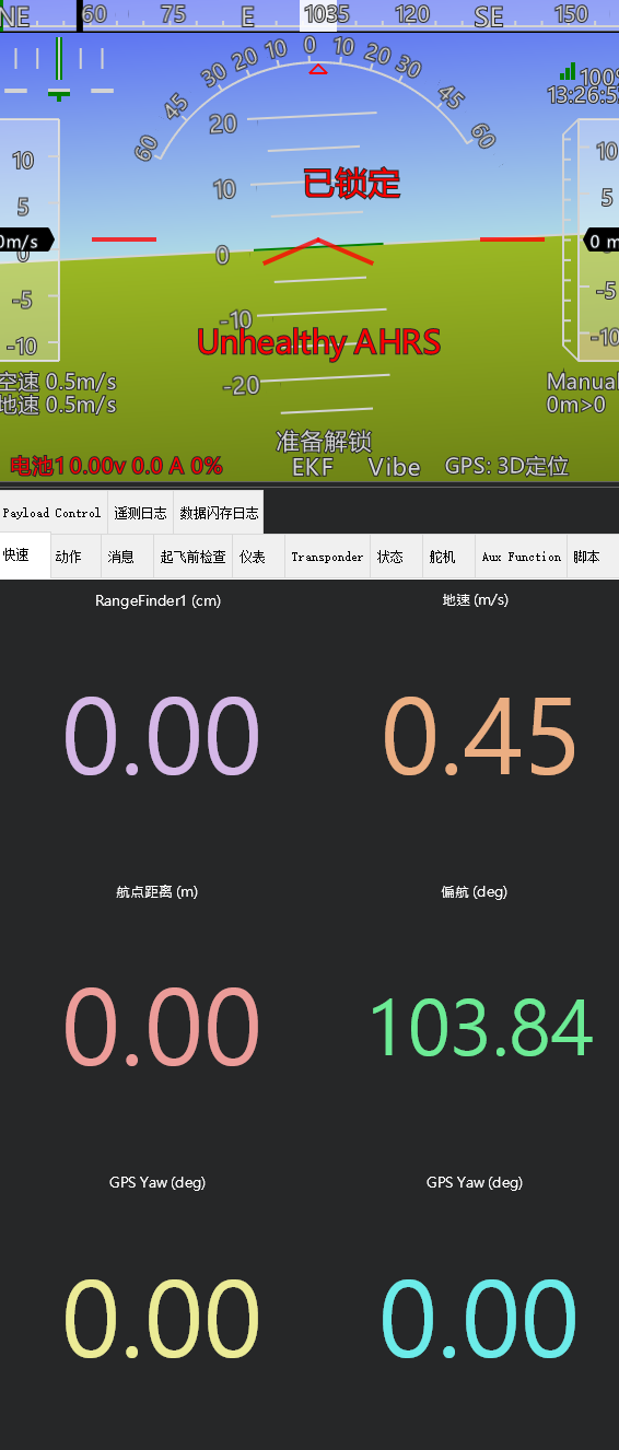

In the past few months, we have been trying to make a USV, but the compass often be disturbed in the water, so we bought a 2HP RTK instead of the M8N。I think I’ve encountered a difficult problem! We assembled a rover, Ardurover v4.5.7, using C-RTK 2HP and PIX. Of course, FIX 3D was quickly implemented. But GPSYAW has always been 0 or 655.35, and I am using the CAN interface dronecan solution.GPS_TYPE=9 CAN_PQ_DRIVER=1 gps_AUTO_CONFIG=2 ahrs_EKF_TYPE=3 EK3_ENABLE=1,But GPSYAW still shows 0 Unhealth AHRS
3.6.param (15.8 KB)

Your post has nothing to do with this topic - next time make a new topic.
Set the following:
SERIAL3_PROTOCOL,-1
And then ensure that your measurements for the GPS_MB* parameters are correct.
Ensure that the vehicle is outside with a clear view of the sky when testing.

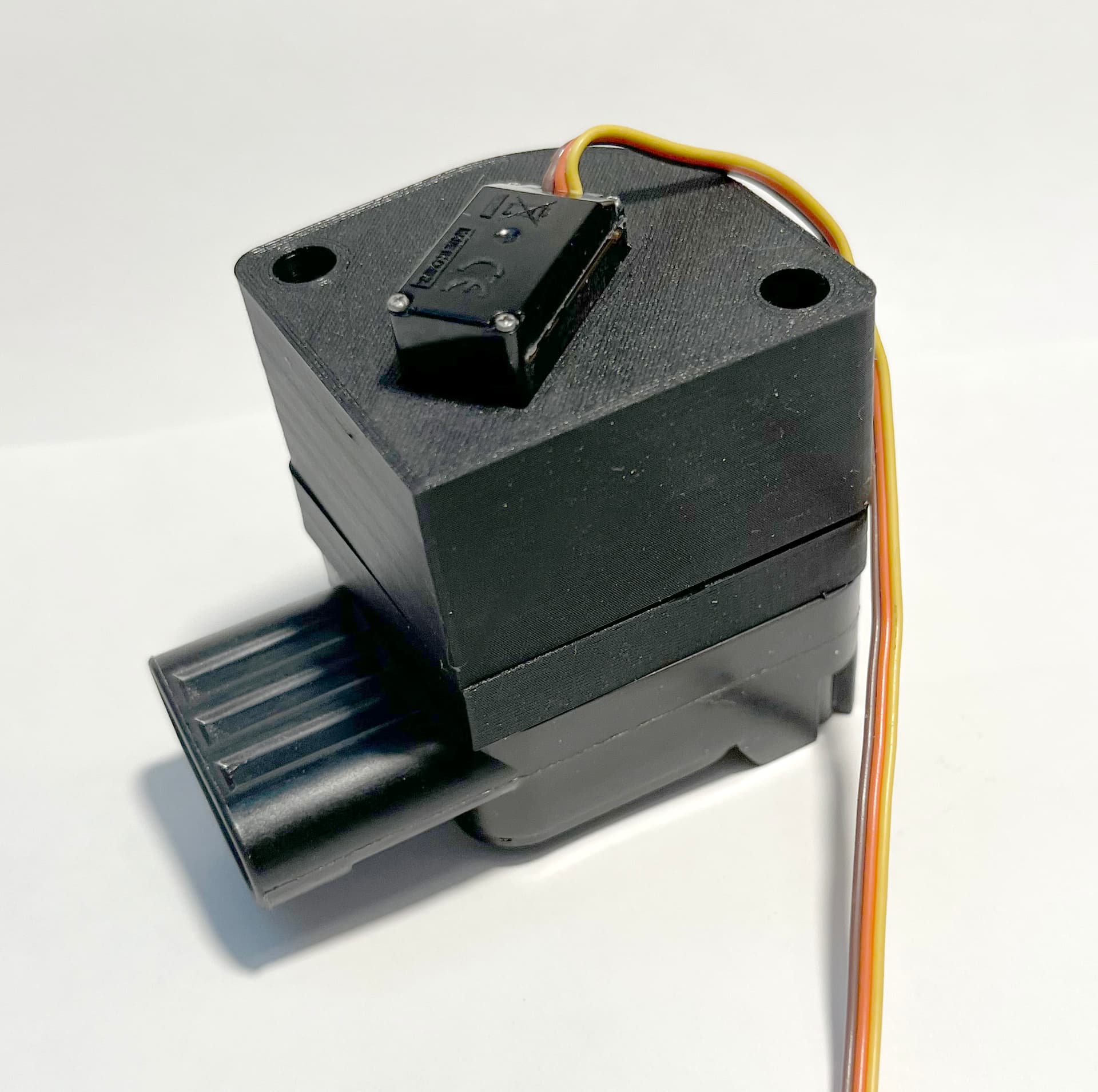

I bought a throttle position sensor, which looks like it and the plug, but it is a potentiometer and not hall effect. I did play and created an adaptor to attach a servo to it, see attached image.

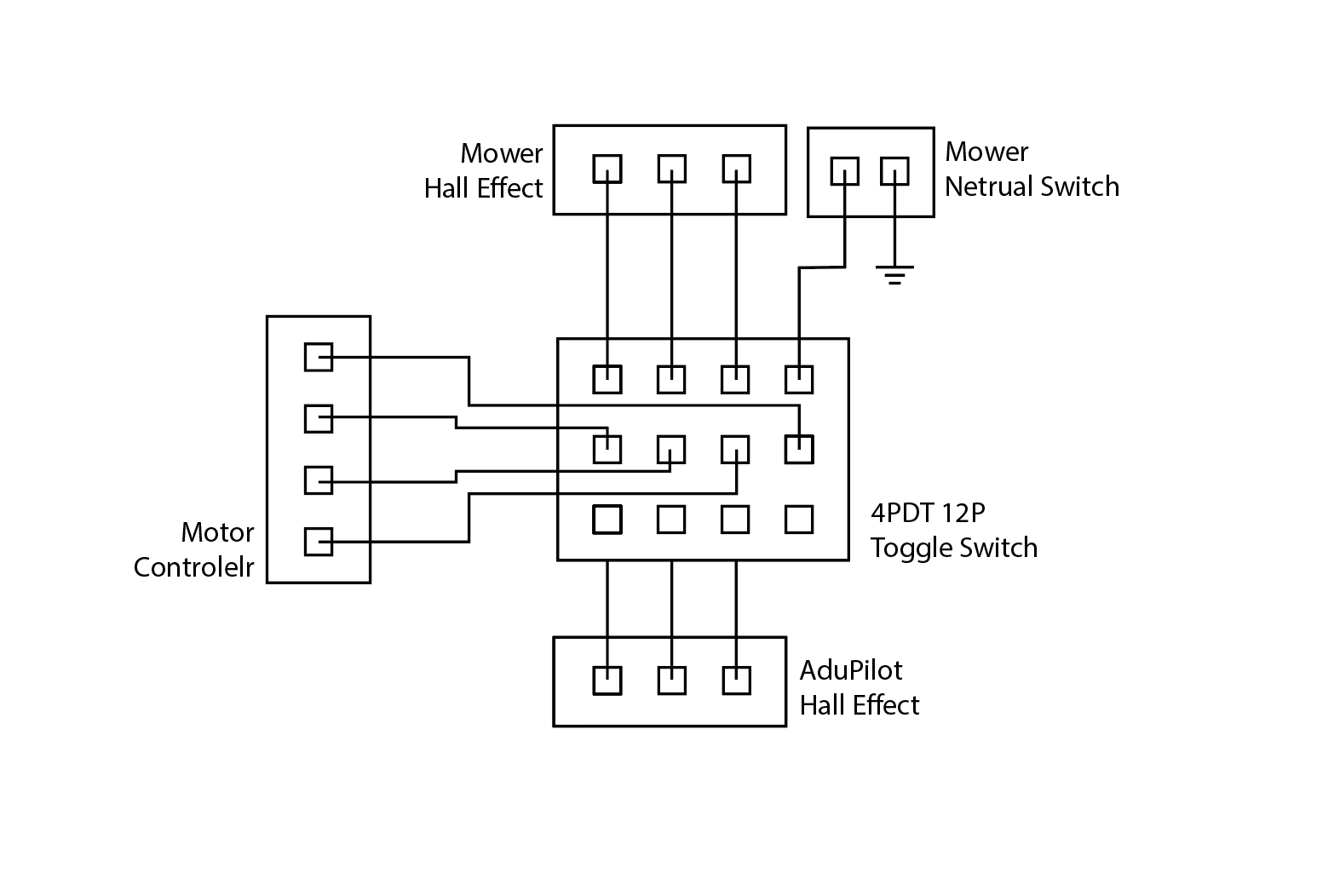

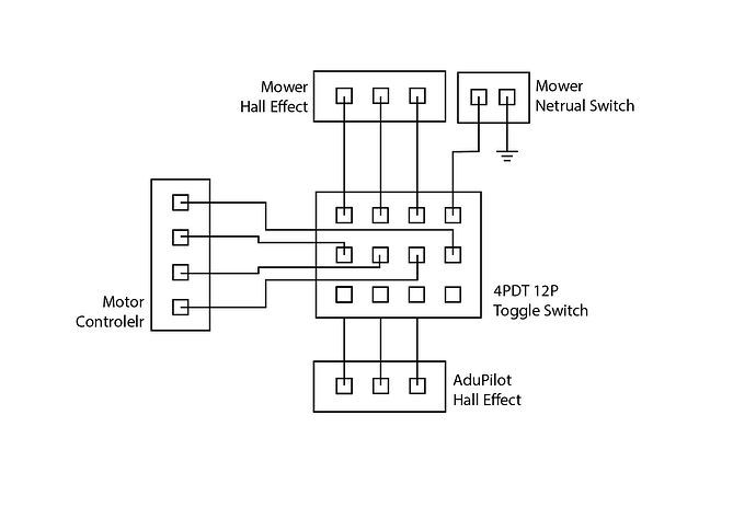

My plan is to use a 2 x 4PDT 2 Position toggle switches to switch between the Ryobi control arms and remote ones, see attached image/diagram.

Did the original low pass filter approach to convert the PWM output from Ardupilot to a variable voltage not work out? It just seemed like a logical and much easier way to do the conversion. In this approach it just seems awkward to control a servo that is used to turn a potentiometer to put out a variable voltage. Was the voltage to low from the low pass filter?
Just got the Ryobi, battery conversion done, and still trying to figure out my process to move forward. Looking into the low pas filter, and how to make it work.
