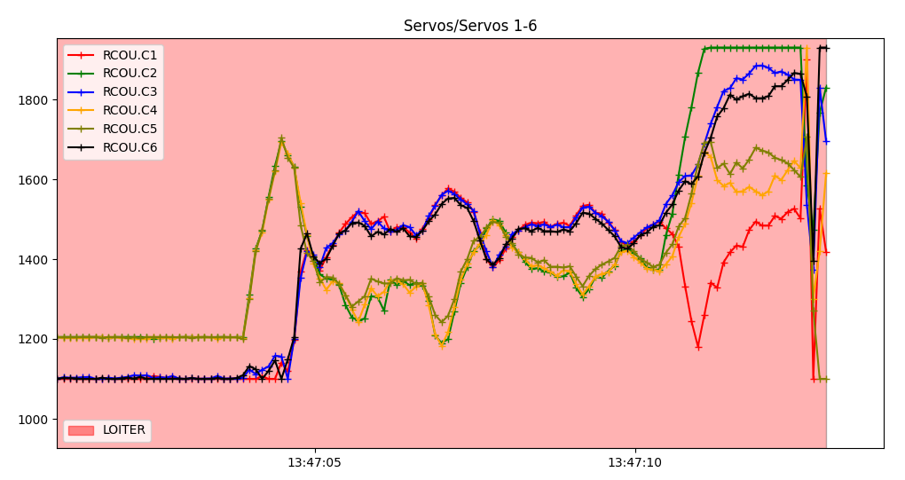

Just looking at the motor outputs I see two problems:
There is a very large spread between the CW motors (1,3,6) and the CCW motors (2,4,5) This is usually because of a frame alignment or motor twist issue.

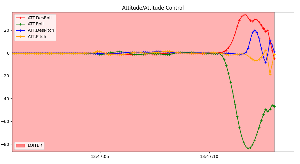

The crash looks like a failure in motor/esc/prop 2. It’s gone to full, while the opposite arm (motor 1) is trying to lower to balance out. You can see it rolled to the left (towards the failed motor 2), but the FC was commanding right
No ESC data so can’t really go past motor/esc. There was a big momentary spike in current before the roll so I’d look for something that looks like it let out it’s magic smoke.
