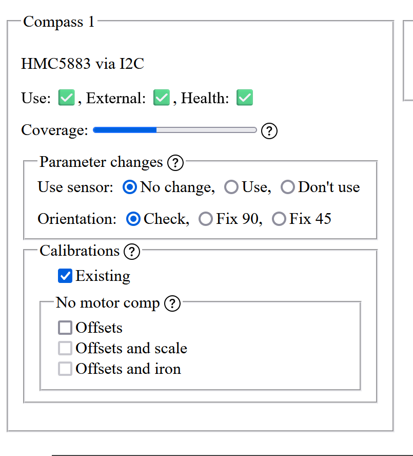

These are the six methods:
  1. No motor comp Offsets
  2. Offsets and scale
  3. Offsets and iron
  4. Battery 1 current Offsets
  5. Offsets and scale
  6. Offsets and iron
They are clearly visible on the webtool
Again, most tools are clear for few.
Ah, I see :slight_smile:
But I still don’t have clear idea about what detailed info of each methods. Is there any link available for me to read?
Hover the mouse over the ? and you’ll get some information. In really simple terms, look at the orange graph that is right above the parameters. Pick the option with the best (lowest) results.
On this quad I see there is no current monitoring because it isn’t giving you option for “Battery Current”, therefor the COMPASS_MOTx values. Too bad because I find that is often the best result for compass calibration.

So I run MAGFit like that:
One more, fly, dance or whatever with your drone to get “Coverage” marker as long as possible. It’s important that MAGFit has a significant amount of data.
Do not check all 3 methods, just check the best one.
It doesn’t matter at all. Last clicked will be used for file. I read it somewhere, but it was not clearly stated as usual. No, it was in the video to which I provided the link above.
MagFit’s Logic: MagFit analyzes your flight log to determine the best calibration based on the quality and coverage of the data. When you enable all three options, MagFit prioritizes the most detailed and accurate calibration it can compute, which is Offsets and Iron.
Coluld be it’s not worth to use all three as the difference is so small, so better to leave zeros in fields for faster calculations.
