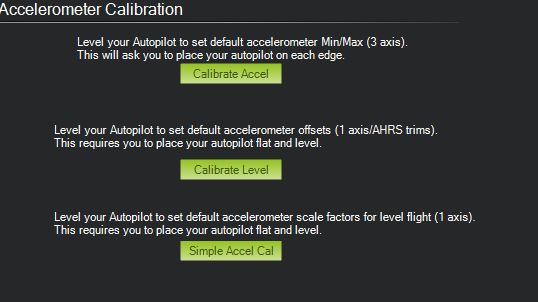

Okay, so I just powered up my laptop and helicopter so I could look at the three buttons so I wasn’t going from memory, and now I understand the difference. So my bad for not comprehending this when I first posted my question.
MissionPlanner_AccelCalibration
However, now I have a new question(s). So the middle button says 1 axis/AHRS trims. So which axis does it adjust? Can you select a different axis? Then same questions for the bottom button.
Thanks guys.
It’s a little misleading I suppose. “Calibrate Level” is a single orientation that calibrates pitch/roll offsets. Unlike the top button, which requires you to rotate the vehicle through 6 orientations to fully calibrate the accelerometers (or the bottom button, which is a sort of shortcut for the top one if you can’t rotate the vehicle).
If you have already done the step for the top or bottom button, the center one allows you to adjust the level roll/pitch attitude with a set of offsets (like trim, but for accelerometer calibration), which seems to be the feature you are after.
This link that applies to other AP variants may help (and applies almost equally to Heli except for the discussion of fixed wing trim, but apparently the Heli section of the wiki differs in more than just that portion):
https://ardupilot.org/plane/docs/common-accelerometer-calibration.html
@Yuri_Rage , thank you for clearing this up. My understanding now is the center button is basically the ‘Level Horizon’ button as mentioned in the wiki. That works for me. Hopefully I can give this a try tomorrow.
I appreciate your help. Thank you and have a great night.
The top button set’s the scale factor and the offset for the accels. The middle button set’s the offsets only. The bottom button set’s the scale factors to default (1) and the offsets based on one position. In any case as @Yuri_Rage says you will finally push the middle button. Today the “Copter” Wiki would be most descriptive even with a Heli.
