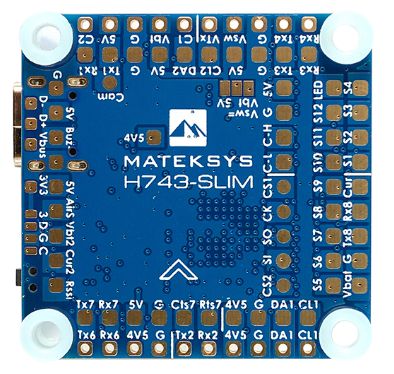

I have a Matek H743 FC slim along with a JHEMCU BS 40A BLHeli_S 2-6S ESC. The wiring I have seen shows the TX on the FC connected to the ESC. What is this wire for? I know that this ESC supports Dshor along wiht PWM and also supplies telemetry. So I would expect two wires, one from the FC to the ESC, and another from the ESC to the FC. However there is no signal to the FC since the wiring diagram shows the FC Rx pad empty. Coujld someone explain what is going on here. What wires do what and is the wiring diageam I have shown correct?
Matek H743 slim

I am still trying to get an answer about the single wire. NORMALLY, the Tx pad of a FC means the transmit signal. The TX normally connects to a Rx on the receiving end. So in the case I have here, refer to the wiring diagrams, There is a wire between the Tx8 and the ESC. Does this mean the FC is transmitting something to the ESC? If so what? Normally, as far as I know, serial connections using usarts have one wire sending data in one diorection and the other wir receiving the data. In my case, I am wondering if the single wire is connected to the wrong pin?
Shawn, It makes sense that the telemetry goes from the ESC to the FC.
However, the wire connects to the TX (Tx8) pad on the FC. I would think that the Tx8 pad would send data TO the ESC??? Is the wiring diagram wrong??

The telemetry data is sent from the ESC to the Flight Controller. Whether it uses the Rx or Tx pin on the Flight Controller depends on the Flight Controller. There are parameters that determine this. Some Flight Controllers can swap these, some can’t. Some only have a Tx or Rx available.

I have done the google thing. I did not know that the FC can switch the Tx and Rx lines. If this is the case, then I guess connecting the ESC to the Tx8 pad will be ok. In any event, normally if the Tx and Rx lines are wrong nothing smokes there is usually just no communication.

Do you have that ESC? If you do there is no telemetry pin, so no telemetry.
I have a “BS 40A BLHeli_S” I don’t know what the wire on Tx8 is for. I do not think anyone here knows. I cannot find a good pinout of this ESC.
My basic question is very simple. What is the wire connected to the Tx8 pad on the FC used for.?
