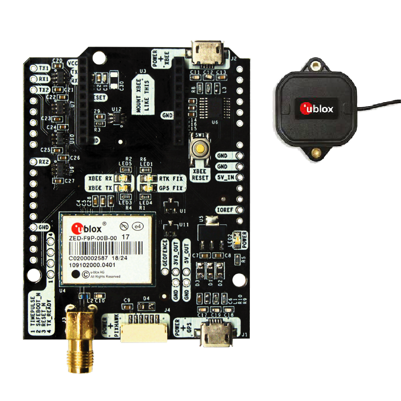

I have a question: I noticed that almost all the GPS hardware based on F9P do not have integrated compass. Then does it mean I need to connect another external compass with the Pixhawk ?
No, it has not an integrated compass (magnetometer).
If two simpleRTK2Blite are combined (or one simpleRTK2B+simpleRTK2Blite), you can get extremely accurate heading based on a moving base configuration.
As far as I know, the parser for the specific message containing this information is not yet implemented in Ardupilot software.
Thank you for your help.
But I’m not quite understand the moving base configuration ? Does it mean the combined GPS board (Ardusimple + Ardusimplelite) all installed on the vehicle ? Or one of them still need to be set on a specific location on the ground as static base ?
With the moving base configuration, both simpleRTK2B+simpleRTK2Blite are installed in the vehicle.
With this units, you will get high accuracy heading without the need of a static base station or NTRIP corrections (the longer the distance between the antennas the higher the accuracy).
If you also want to have cm level position, you can either:
Thank you Josep, can I use the moving base configuration with Pixhawk ? Also since the two antennas will be installed on the vehicle, so the distance between them cannot be very far. How accurate it will be if two antennas are very close with each other (around 300mm ) ?
Right now and as far as I know, Pixhawk doesn’t support the moving baseline functionality, although is relatively easy to implement for the developers.
The heading accuracy can be defined as:
heading_accuracy = atan(2/distance), where distance is the distance between antennas in cm.
30cm: 3.8deg
1m: 1.14deg
10m: 0.11deg
This is an approximation, but the final numbers should be the same order of magnitude.
simpleRTK2Blite will support standalone operation + RTCM corrections.
SSR corrections will be supported in a future firmware release by u-blox (no dates available yet).
