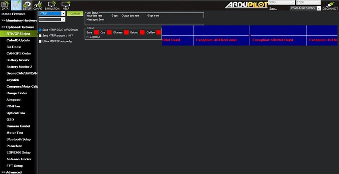

I am trying to get an NTRIP server running on Mission Planner. My hardware is a Matek H743 Slim connected to a Sparkfun NEO-M8P-2 GPS. When I attempt to connect to the NTRIP server under the RTK/GPS Inject page, the connection doesn’t return any errors, but no data is displayed or outputted. What could be the issue?

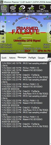

I should mention that the log shows something along the lines of “GPS 1: detected as u-blox at 230400 baud ntrip”.
Whats the url you are using to connect ?
are you wanting corrections from the M8P, if so how is it connected to mission planner ?
