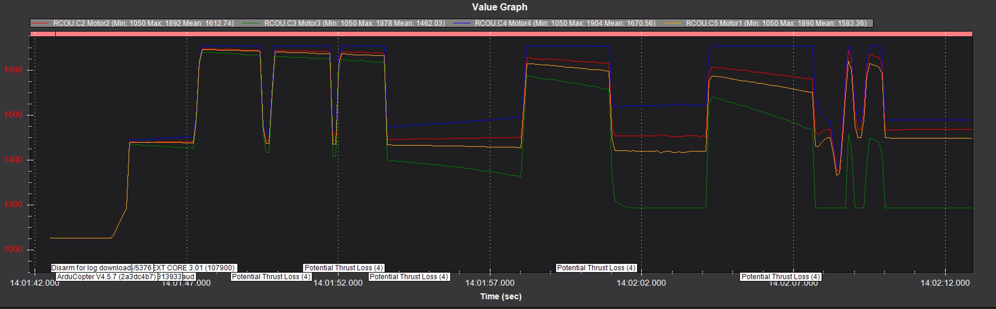

I don’t see how at 12kg. This is what you have now on your 6S power at full throttle, as expected:
Maxed out outputs and it’s going nowhere.
You need battery current logging.

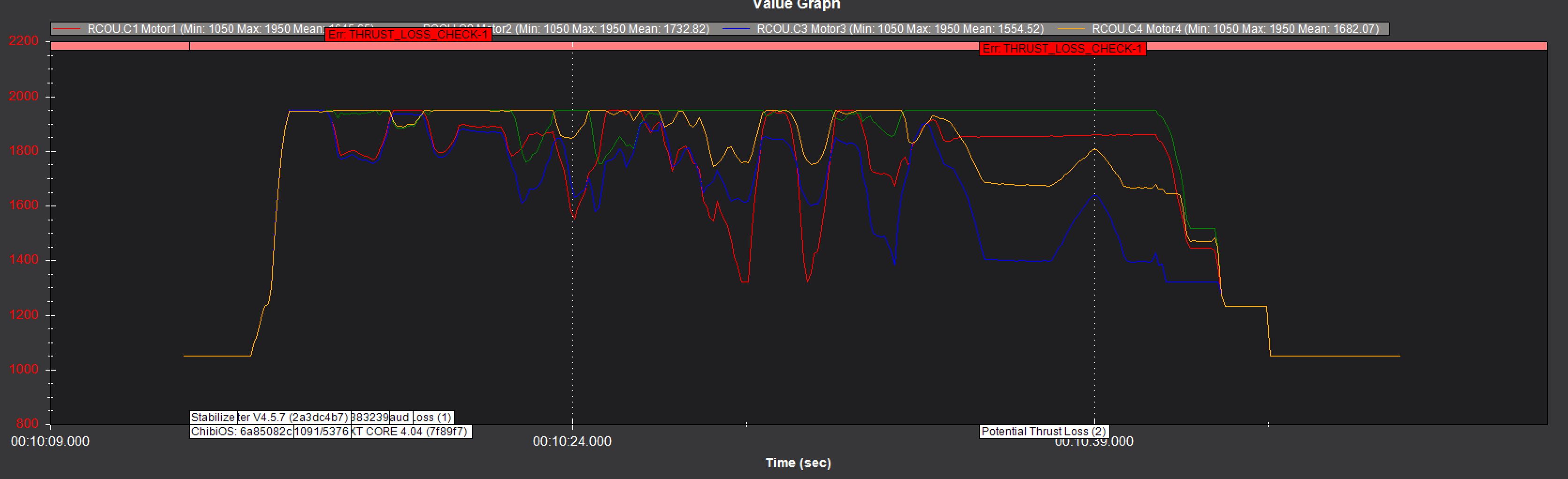

hi threre, so i rebuild my drone using holybro px4. and did test flight all was good next day, it was today i was try to flight and got thrust loss errros, can you please check my log? thanks in advance
2025-04-08 21-01-42.zip (447.0 KB)
It would be more useful to post the log of the test flight where you say all was good. Because this just shows max outputs and as before it’s going nowhere.
