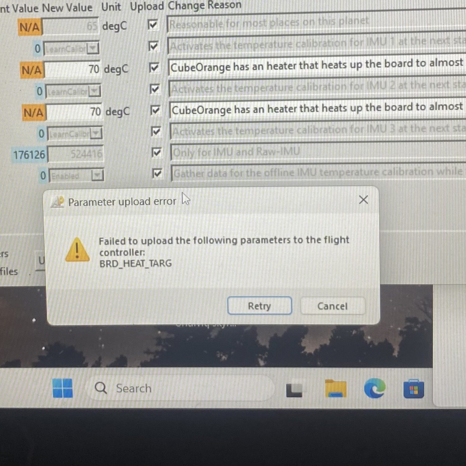

I’m trying to configure PX4 using the ArduPilot method, and I already have an error in the first step: brd_heat_targ.”
That could be because the Pixhawk 4 doesn’t have an IMU heater :wink:
@karolis3000 when you find warnings, errors or problems: ask here.
That is a warning, that you can ignore by pressing cancel.
Just like @dkemxr said those parameters are not available on that particular flight controller (as seen in the orange N/A text on their value) and you can delete them using the Del button next to their name.
