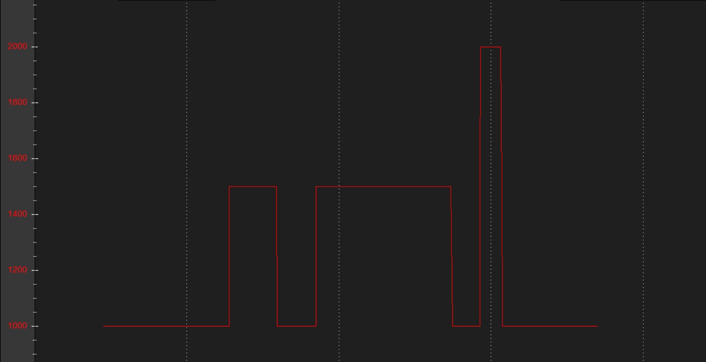

I’ve been developing a Quadcopter and when flying, I can’t seem to switch modes in the air. I had set Stabilise, AltHold and Loiter as the flight modes, but when flicking the switch for the assigned flight mode switch it just stays in Stabilise. I’ve attached a log for it. I understand arming checks are switched off and GPS is turned off because the GPS wasn’t working on the day and I just wanted to get a bit of manual PID tuning done. Regardless, I’m pretty sure AltHold doesn’t require GPS, and even on the ground when I switch flight modes with the GPS turned on yesterday, the HUD doesn’t show any changes it is still in Stabilise. I don’t have a log for that because I was on the ground.
Can anyone help? Thanks!!!
The flight logs show a change in PWM so the switch should be working, but it just stays in Stabilise…

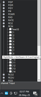

Sure. You have 2 functions configured on RC7. Flight Mode and Arm/Disarm. You also have Arm/Disarm configured on RC5 which is the default Mode channel.
This misconfiguration could have ended badly.
Oh wow okay, I didn’t know you could configure 2 things like that on one channel? Do you know what I need to do so that it is just the flight mode selected on Channel 7? I knew it wasn’t the transmitter at fault here and I couldn’t tell what the issue was
You must have configured this so disable it (set to 0)
RC7

BTW-The dead giveaway here can be found in the log RCIN field. Mouse over the channels and what’s configured will pop up. You can see the problem here:
