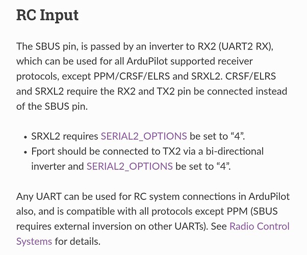

It’s right in the Doc’s Speedybee F405 wing
Ohh,bro, That is the wing version of speedybee, haha, I am using the speedybeeF405mini, which comes for a drone, and on the ardupilot page, it does not mention that PPM is incompatible!! :man_shrugging:t2:,
The topic is addressed as incomplete in that topic,
its on the ardupilot page as compatible with ppm, I suspect that image has just been copied over without looking at all the components.
as far as i know ppm is only supported on ardupilot controllers that use an RCIN pin instead of a UART port like that does.
Oh Bro! Try that Google search for F405 Mini
Any UART can be used for RC system connections in ArduPilot also, and is compatible with all protocols except PPM
finally someone is going my way, that’s my doubt!! What is the RCin entry on that board, to which the firmware modification was made, And I attest that it works, but I was left with that doubt, because what they specify well is that the UART inputs detect almost all Receiver protocols, except PPM but they do not say that PPM is incompatible,What would be the input RCin?
that board doesnt have a RCIN pin so it doesnt support PPM with ardupilot as it uses a UART port for RC that doesnt support PPM. betalfight can do it because they remap the pins essentially substituting one for another. ardupilot does not support hardware remapping, neither does Inav, its a betaflight only function.
