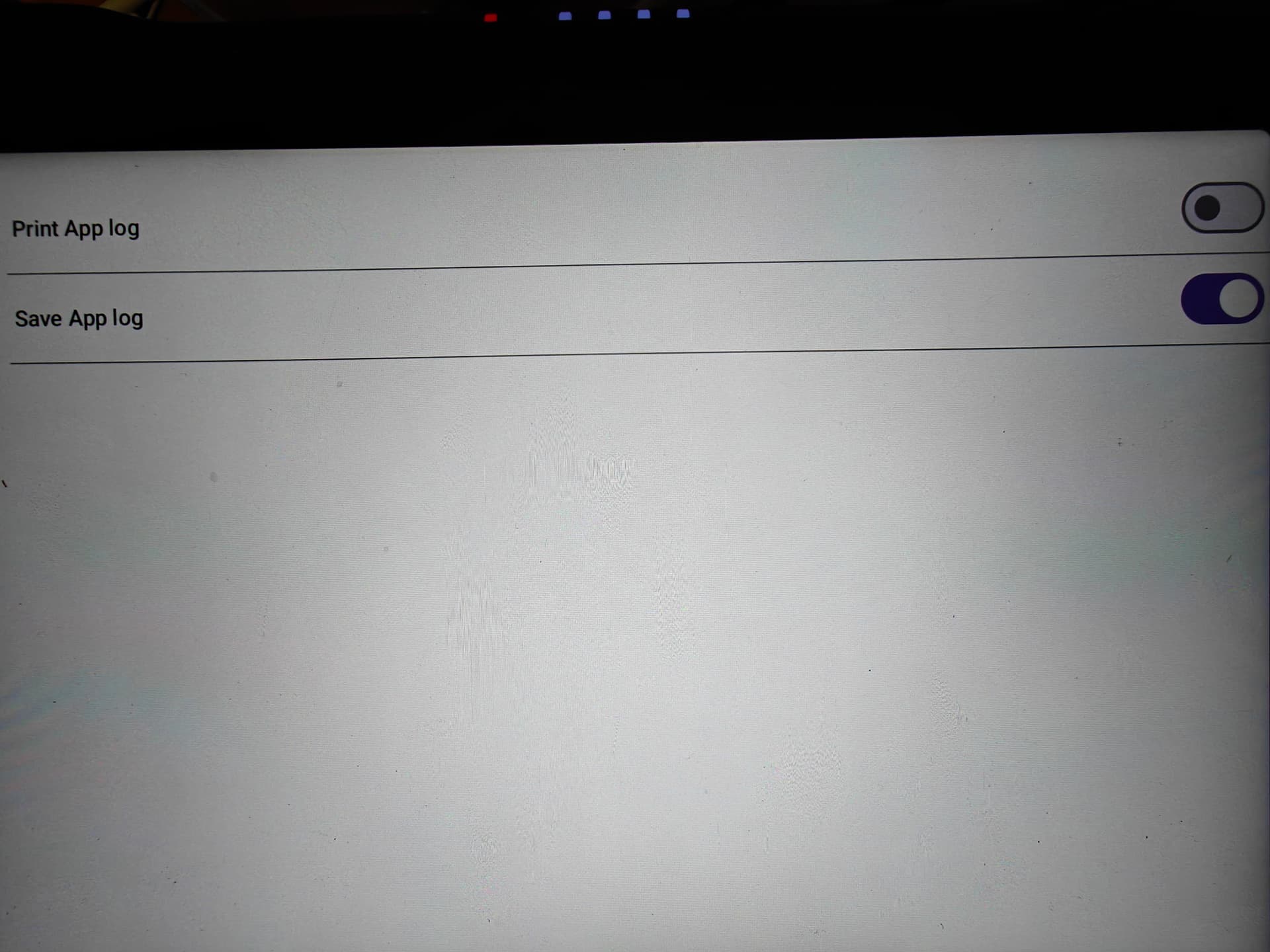

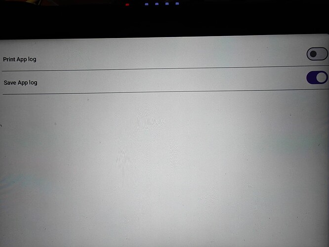

Not here. After opening the log menu, there are two folders on the far left: Software and Debug log. Select Debug log, only one switch displays as “保存日志” in Chinese. Open this log.

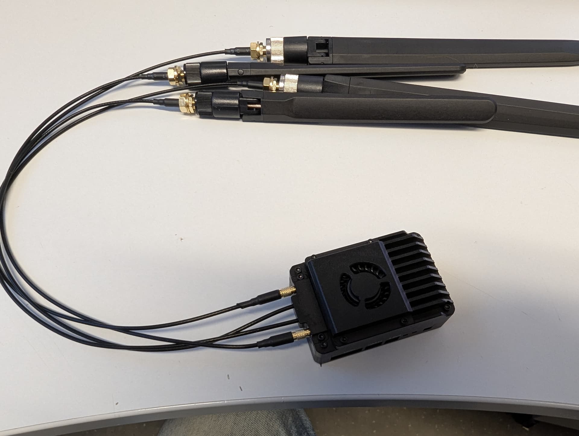

The below is from last weekend and part of an email to 3DXR, where the system was bought. I will like to present it here also in the light of a similar incident mentioned a few posts back:
After changing over from the Siyi MK32 system to the Siyi UniRC7 system we experienced a severe failure. This luckily happened om the ground prior to first test flight. Before this everything had worked flawlessly during setup and ground testing. The failure did not happen when powering up, but a few minutes into the session. The drone (a S1000 converted to Ardupilot) has successfully flown several times before this on the old MK32 system. Everything was set up with the original cables delivered with the UniRC7, and the air-unit was powered directly on 6s.
Upon closer inspection it looks like the air-unit has failed. There are no external signs of damage, but it smells strongly of burned electronics. We took the air-unit out of the drone and tried to power it up (nothing else connected to it) using a “smoke stopper”, but it immediately triggered the “smoke stopper”, acting like it has shorted out. We have not opened the air unit to verify this.
So far it looks like the rest of the systems in the drone is ok. It powers up without the air-unit (using an Agilent lab power supply, with current limit to trigger, if shorts are detected), but further inspection will tell if something else has failed
