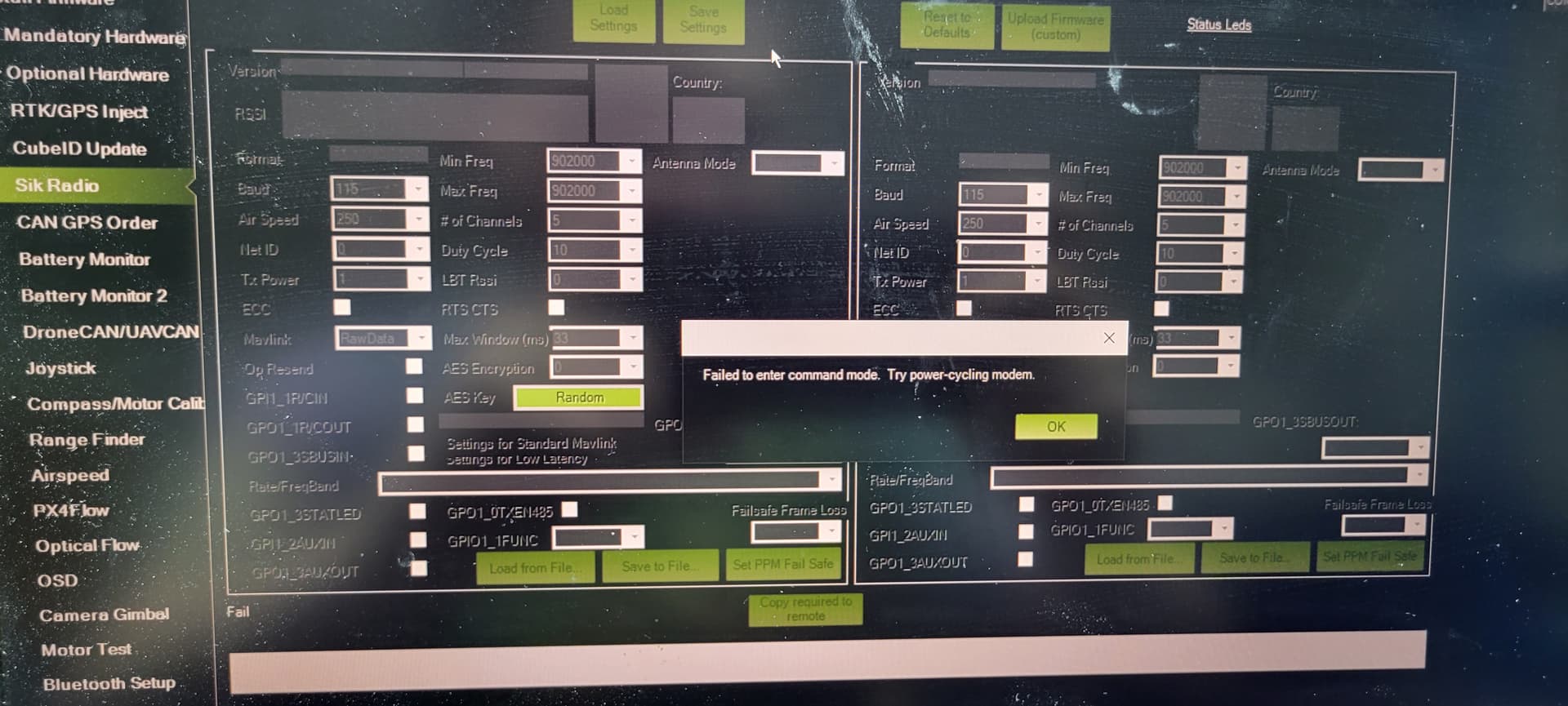

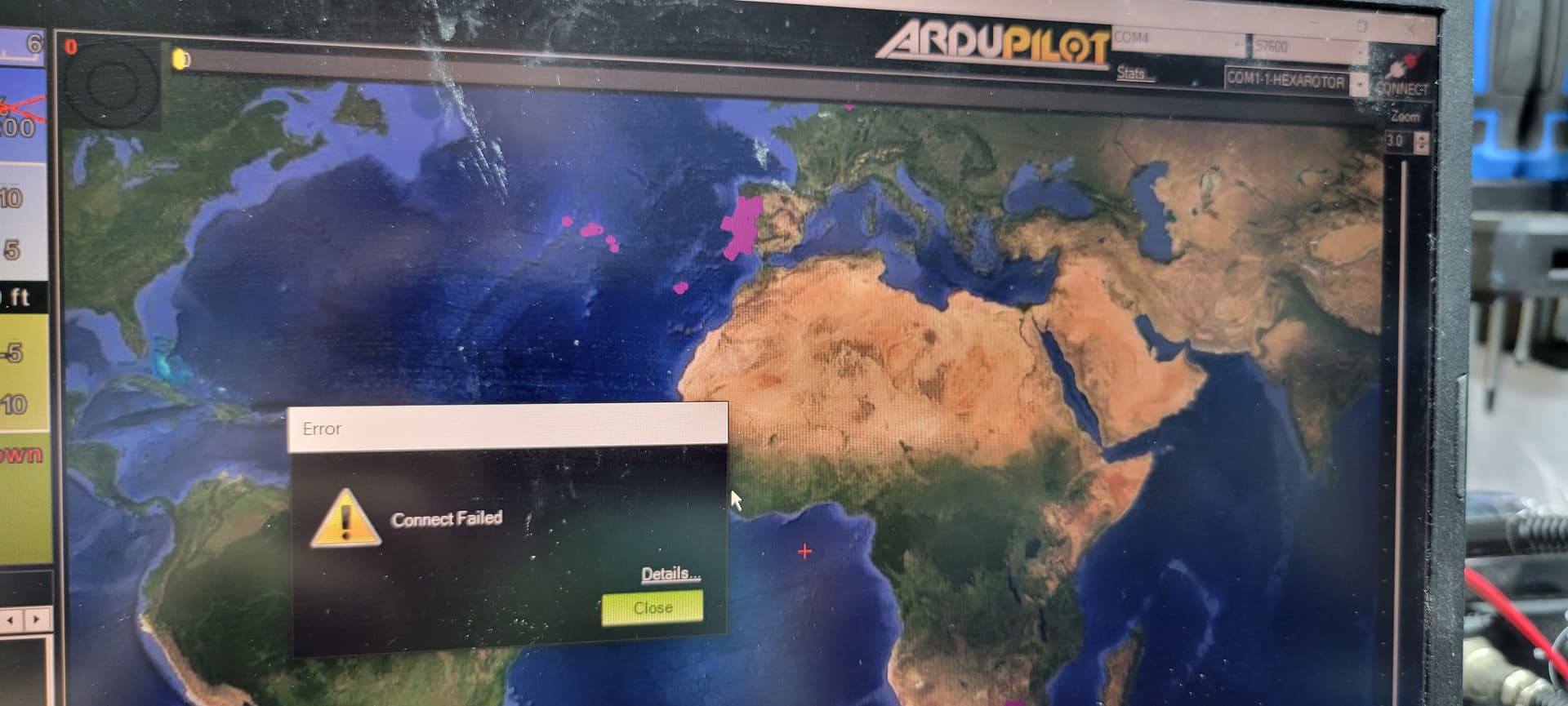

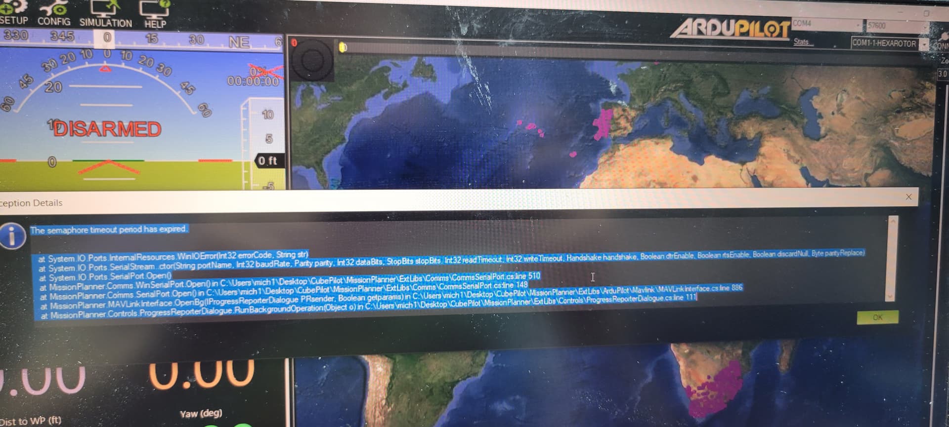

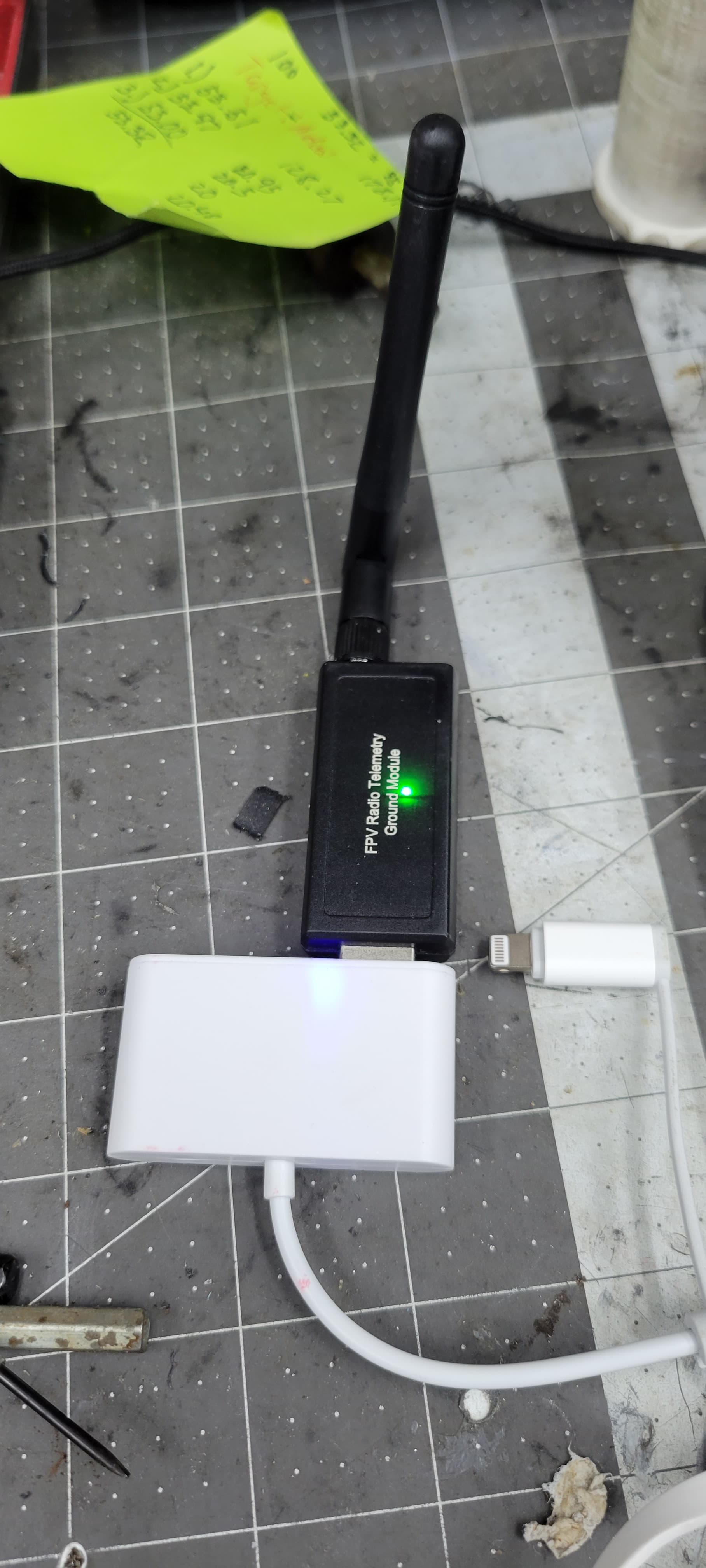

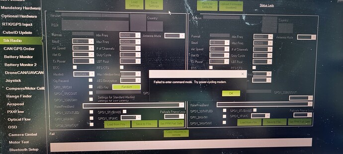

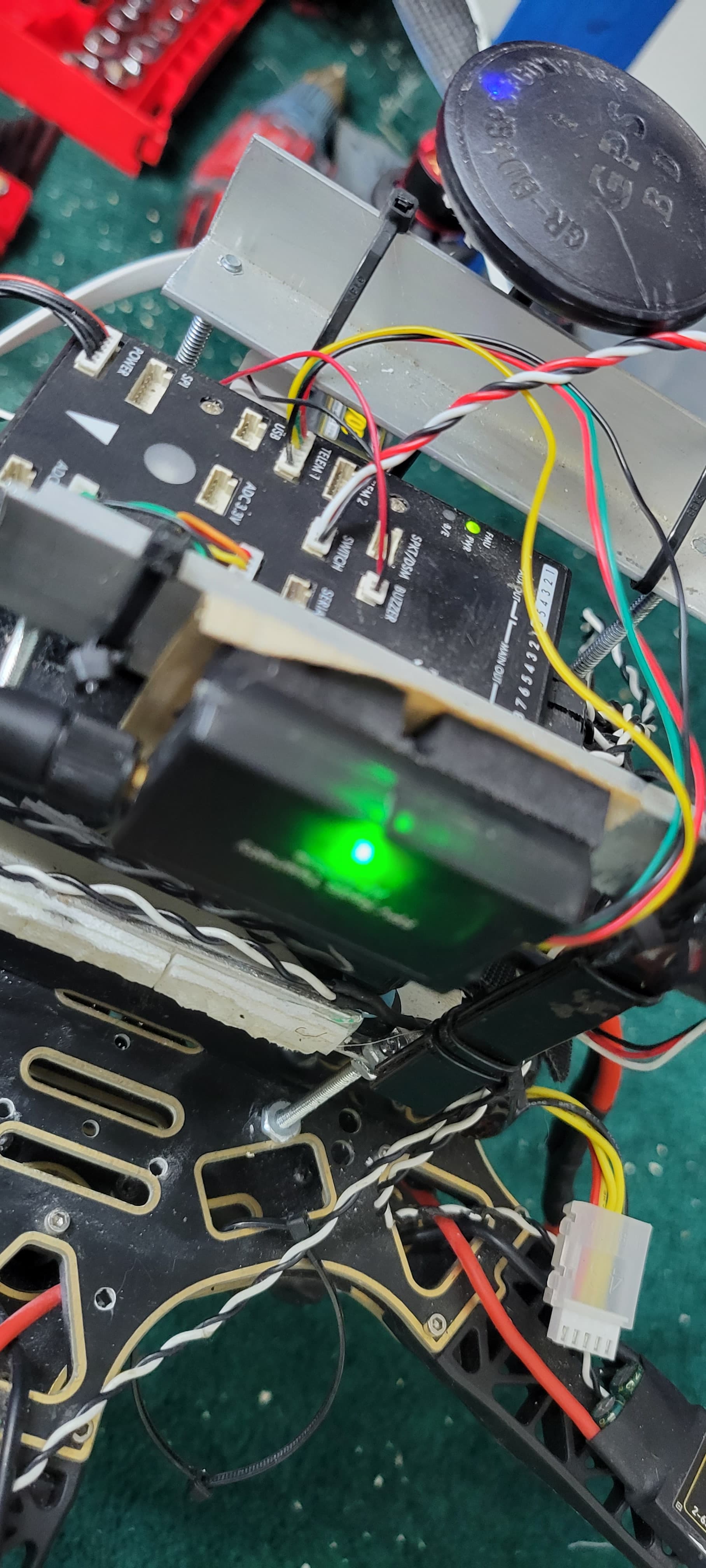

Greetings all. I am requesting assistance trying to config some autonomouse flight/ joystick flight. When connected, the usb connection turns to a solid greene as does the one connected to the pixhawk. Boad rate set to 57600 and the proper com port is selected. Once connecting within the matter of 5 seconds i get the connection failed notification.

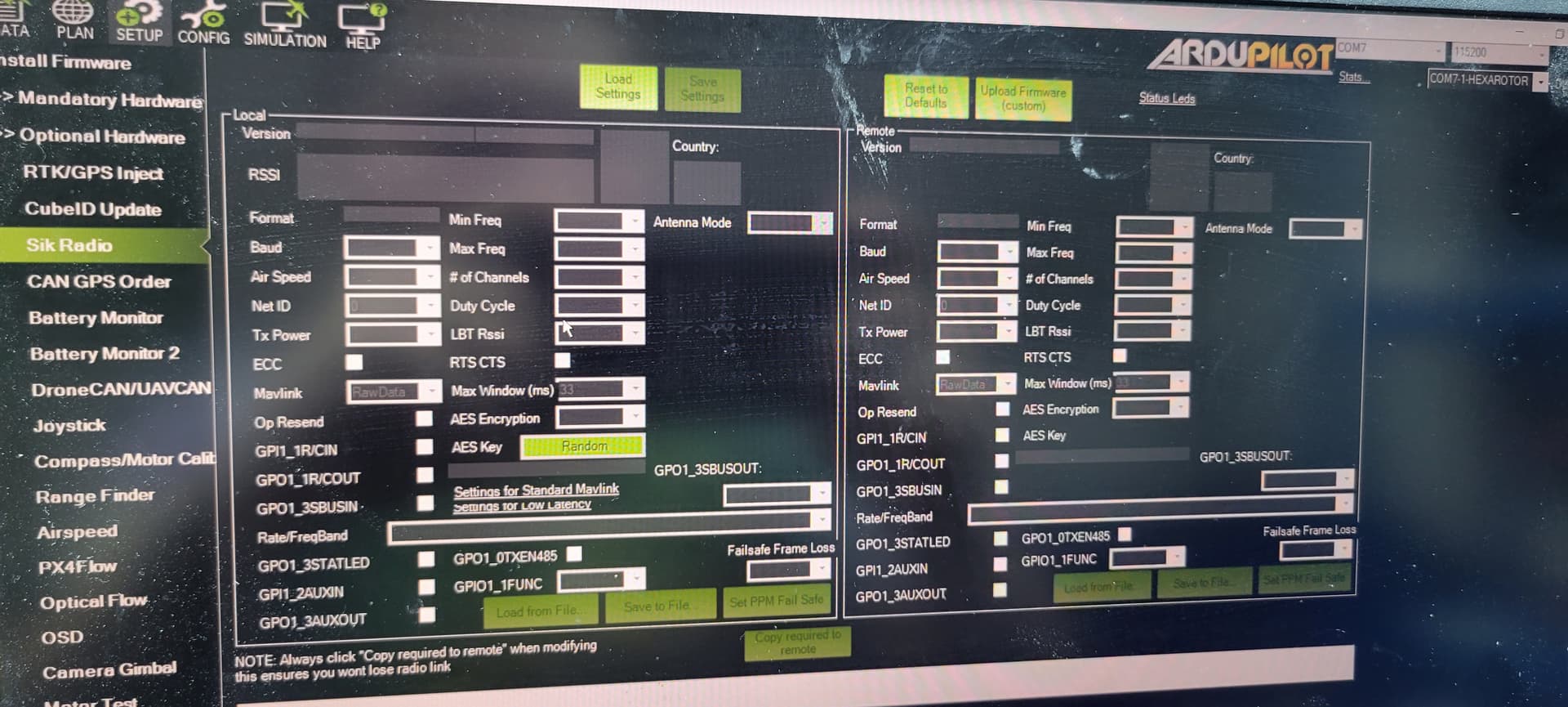

I can connect via usb cable no problem. So i attempted to connect that way and maybe config or view sik radio settings withing the optional hardware, but no options appear. I then tried to “load settings” and i get a “failed to enter command mode. Try power-cycleing modem”. I try to power-cycle and keep ketting same issues.
Ive attached some pictures i took with my phone. To try to help explain my frustrations haha. I appreciate any help i can get.
A little background to my build is, i had a raspberry pi running uavcast connected to my pixhawk for 4glte flight. I left home for a little while and just got back a few weeks ago so my data plan and uav cast membership expired. So my thing is, i would like to atleast be able to fly it for the time being until i get a new sim card and data plan/ uavcast membership activated. I have a joystick set up that i plan to use for flight from my laptop.
another update* so the error i was running into was that the drivers i was using were not working. after resetting the parameters and updating the drivers for the telemetry usb and a restart on the pixhawk i was able to get it to connect and function now. hope this helps someone in the future!
