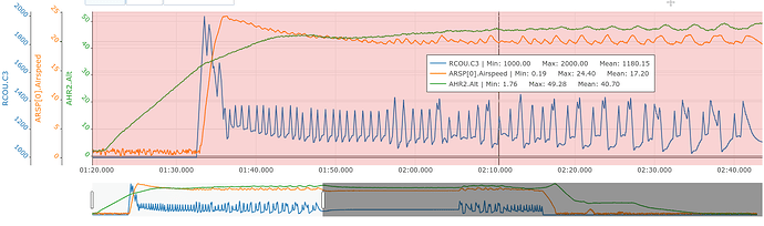

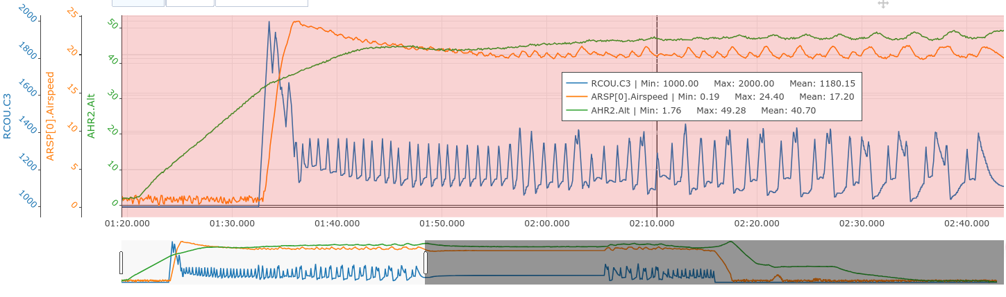

Hi everyone!
Recently, while using the plane_ship_landing.lua script, we observed abnormal throttle behavior during the fixed-wing phase of flight, and the same issue were able to reproduce during in SITL. Our ArduPlane version is 4.5.6.
Has anyone else encountered this issue? Any suggestions or solutions would be greatly appreciated. Thank you!
Something in TECS->attitude cascade is badly tuned. Post a log.
Of course, please check thisship_land_test
We are using the default parameters and have not made any modifications to the firmware on SITL. Any suggestions would be very helpful.Thank you!
