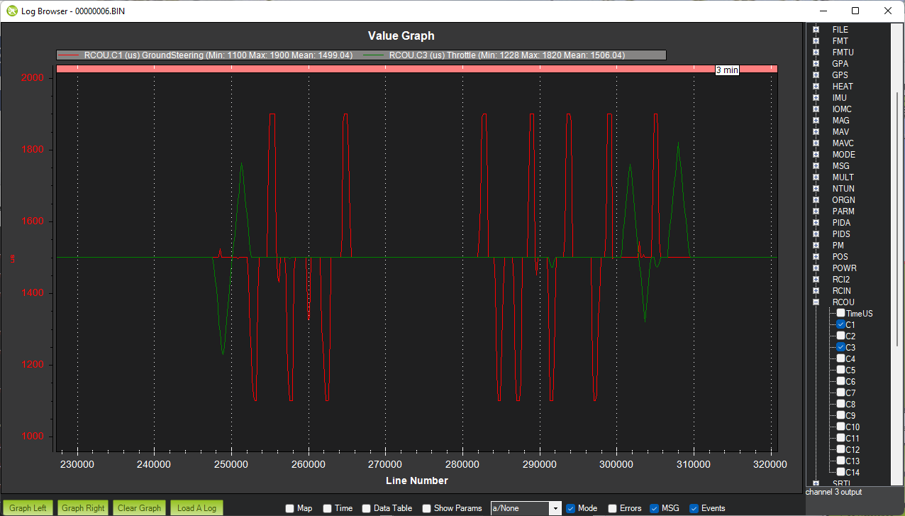

we are very new to this. we are configuring a new boat with the cube orange autopilot. we are struggling to get it to steer and throttle up. we have configured the accelerometer, compass, calibrated receiver virtually all that was required prior to setting up motors and servos. we are using a minnkota motor with a servo to steer the motor. we have comfirmed the motor works with the ESC software. not sure what to do to get these functions to work.

Yes it arms. We look at the logs Ch1 & Ch3 and the receiver is sending. Could it be our PWM setting could be out?
It’s probably best to post an onboard log. As we often say, “it’s all guesswork without a log”.
bin log file

Things look ok on the autopilot side. I guess the servo is moving OK?
If the servo is moving OK then I think the problem is the motor control hardware (aka ESC). I guess you’re following the instructions here on the wiki? In which case I can randomly guess that the RoboClaw ESC hasn’t been setup quite right. Perhaps it’s not accept PWM input (which is what the autopilot is outputting) or perhaps it is expecting the range of the pwm input to be something different than what the autopilot is outputting (the autopilot outputs 1000 to go backwards at 100%, 1500 to not turn, 2000 to go forward at 100%). Below is a graph of the PWM output from the autopilot so the steering servo should certainly be moving. The motor should be turning on/off as well.
BTW the steering RC input (e.g. from the transmitter) seems to be off by about 100pwm. It’s natural resting position appears to be 1600pwm. The RC calibration matches (e.g. RC1_TRIM = 1600) so it’s no problem but at some point it might be good to fix the transmitter trims and re-do the RC calibration.
