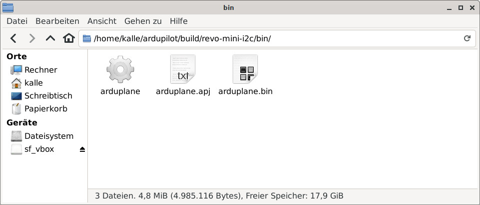

Thinking it over again, I suppose, I have to compile an adapted firmware myself. I am here on Debian and compiled software, which is not in the Debian sources or EdgeTX from sources. Normally no problem, But AP is a really big chunk. And at the moment I have no idea, what compile options have to be set, to enable SD card logging from the oplink port.
We’ll see …
Compiling the firmware seems to be working.
But what I got now, is ‘master’, I guess v4.1.7? with revo-mini-i2 settings. I am seeking to get the SD card on oplink port working here.
Any hint, what the next steps would be please …
Think I got it working… :wink:
