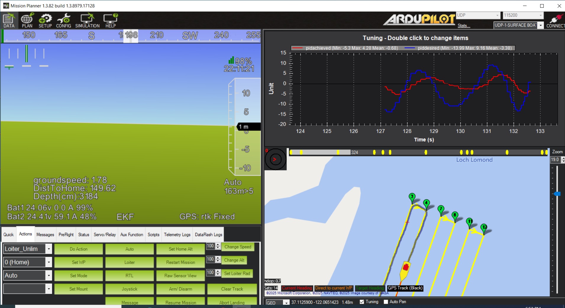

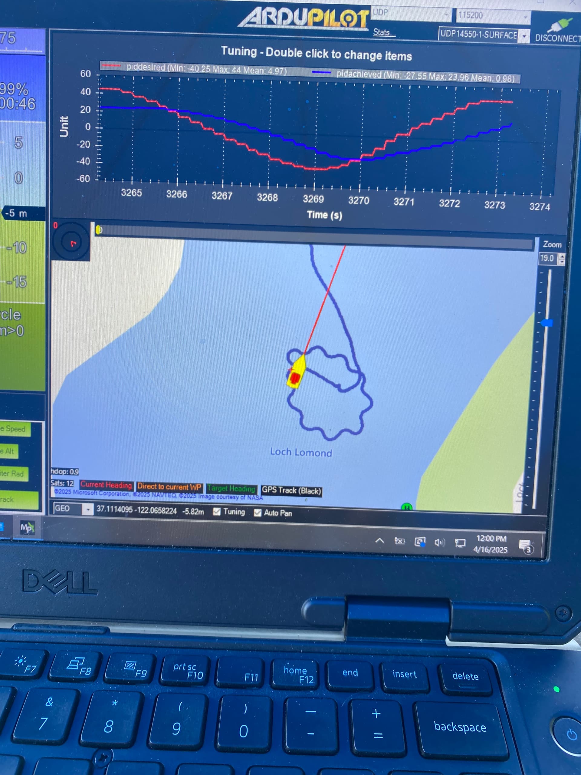

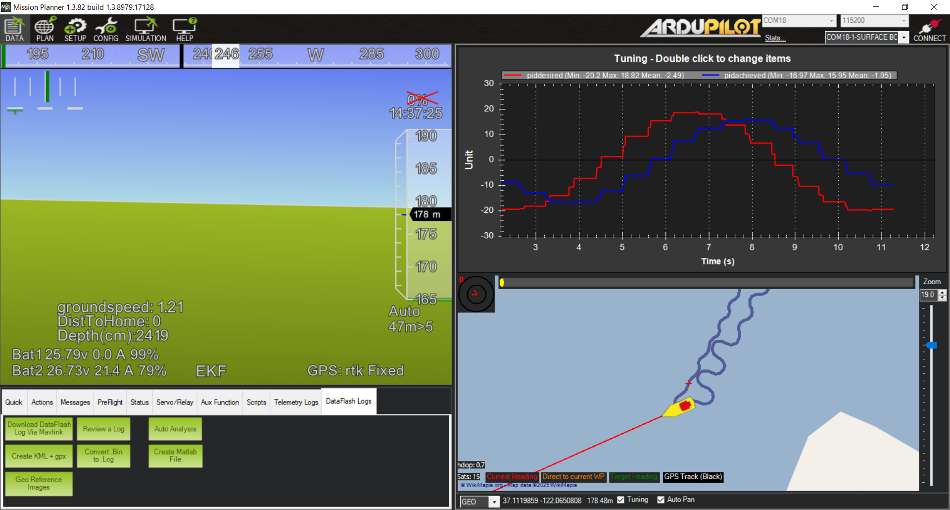

In manual or acro the boat can be driven well. It is very maneuverable and tracks straight but in circle mode, drive to here, or survey in auto it fishtails as seen in the screen grabs below - the first one demonstrates where I modified FF while underway where the fishtail amplitude was much higher. For scale the line spacing shown is 10 meters and the circle radius is 20 meters.

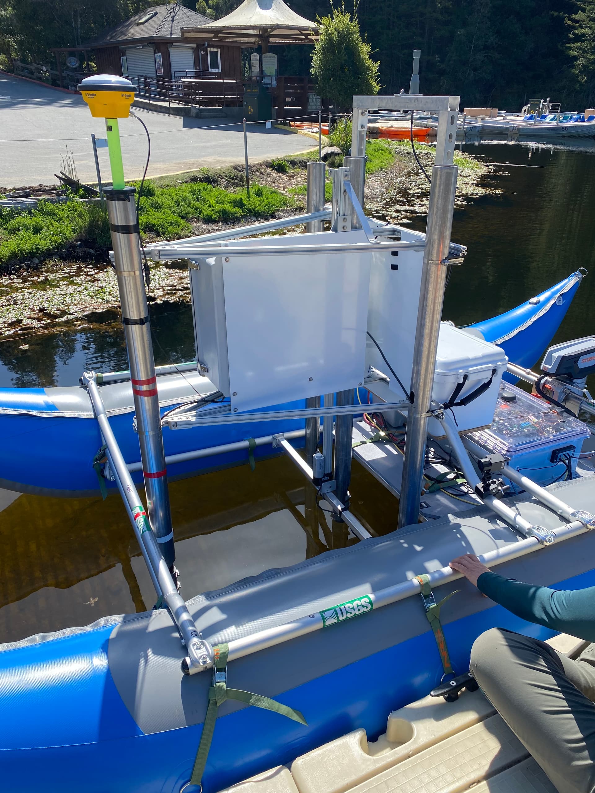

Note that the yellow & white Trimble GNSS antenna shown on the front of the boat is Not the one used by the autopilot. There is a smaller dedicated antenna on top of the white Yeti cooler about 0.5m directly in front of the cube orange which located inside the electronics box with the transparent lid. The antenna a high quality talllysman 33-7972-00 GNSS antenna but has a mag mount so I couldn’t place it directly above the cube orange without the compass being bothered.
The frame on the front gets lowered to the position seen in the video once the vehicle is away from shore so the tubes are submerged ~0.5 meters below the water surface during normal operation/survey. I did all of the testing/tuning with the tubes deployed but did try with them up out of the water to see if there was much of a difference and the answer was no.

Custom steering mechanism using Pololu Tic 36v4 stepper motor driver to power a high torque Stepper connected with a modified rack-and-pinion steering system operated as a steering servo.

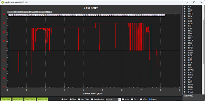

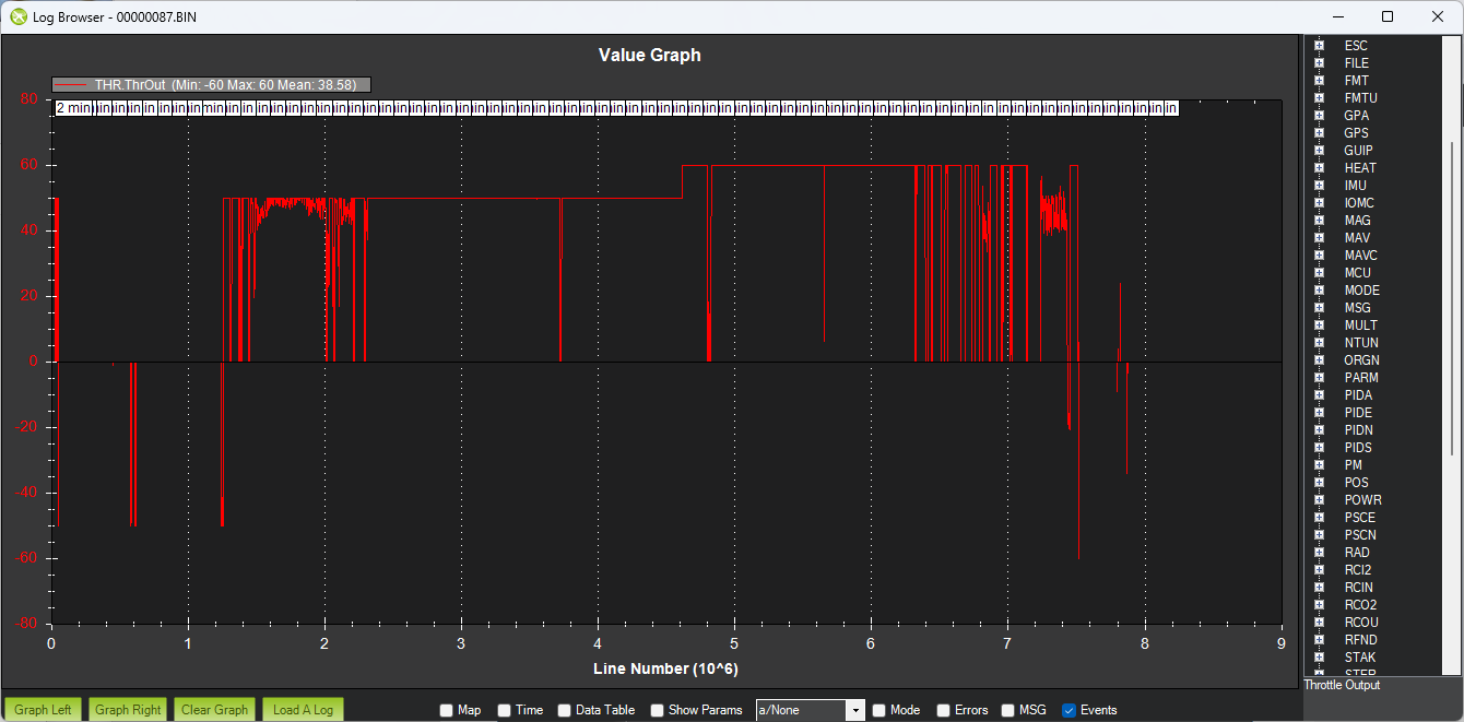

If possible I think it would also be good to remove the limit on the throttle. MOT_THST_MAX is currently set to 60 and we see that the motor is very regularly hitting this limit.
Because of the turning, it’s difficult to tell if the CRUISE_THROTTLE and CRUISE_SPEED are set correctly. At the moment CRUISE_THROTTLE=21 and CRUISE_SPEED=0.78 which implies a top speed of about 3.7m/s (at 100% throttle) which seems reasonable actually. BTW, the wiki says to put the throttle at 50% to 80% but I often just use full throttle. I’ll update the wiki to reflect this.

The boat hull speed is slow, ~3.7 m/s is achieved with about 50-60% throttle and 100% only gets to about 4.0 m/s with a bunch more water churning around and much faster battery depletion. But I’ll give it a go without limits.
When I look at pidrequested vs pidachived, pidachived is always lagging but the amplitude looks decent. I wonder is there a parameter I’m missing that slows down how fast pidrequested changes so that the boat could better keep up?

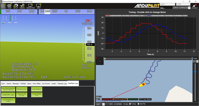

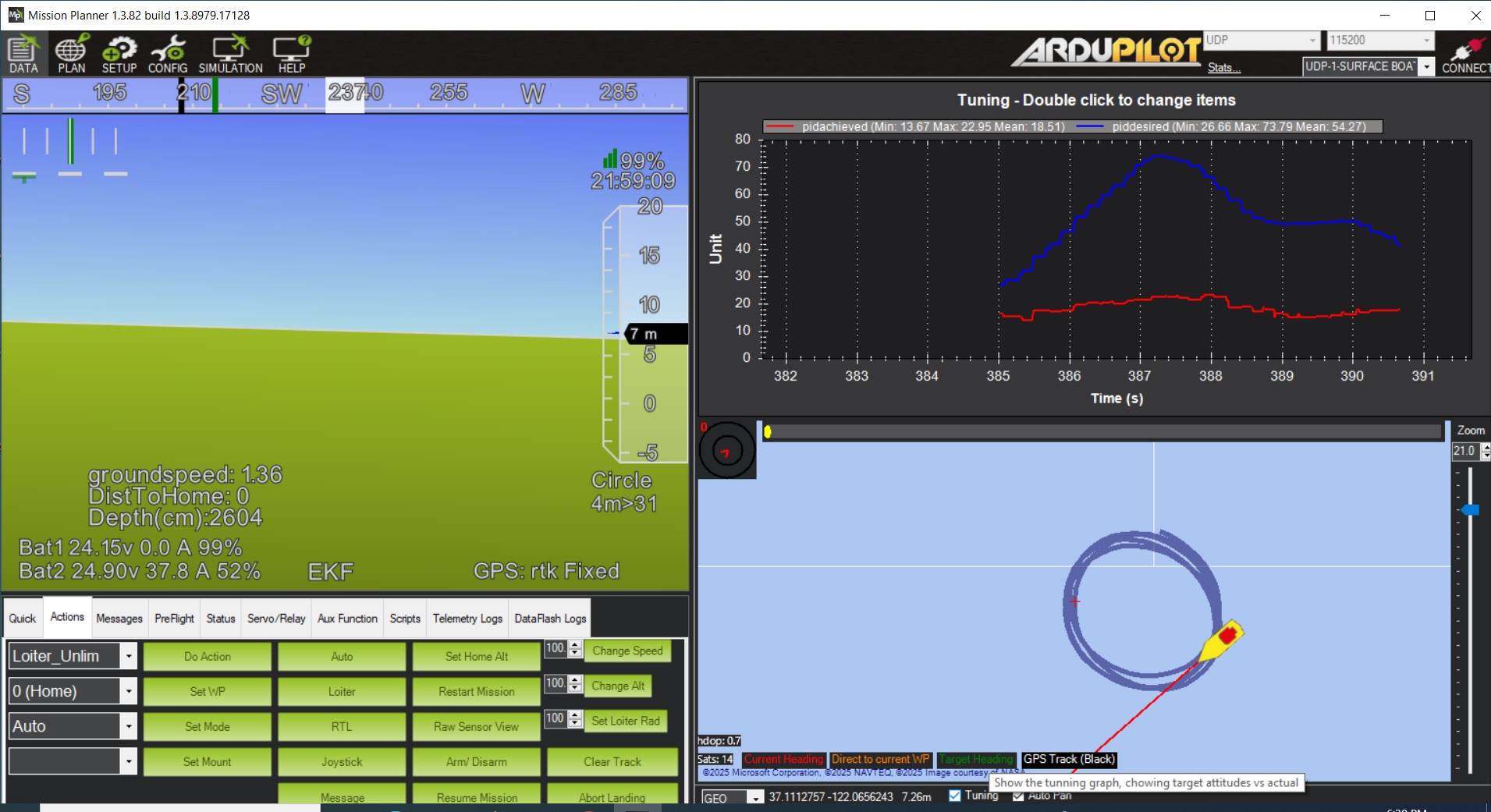

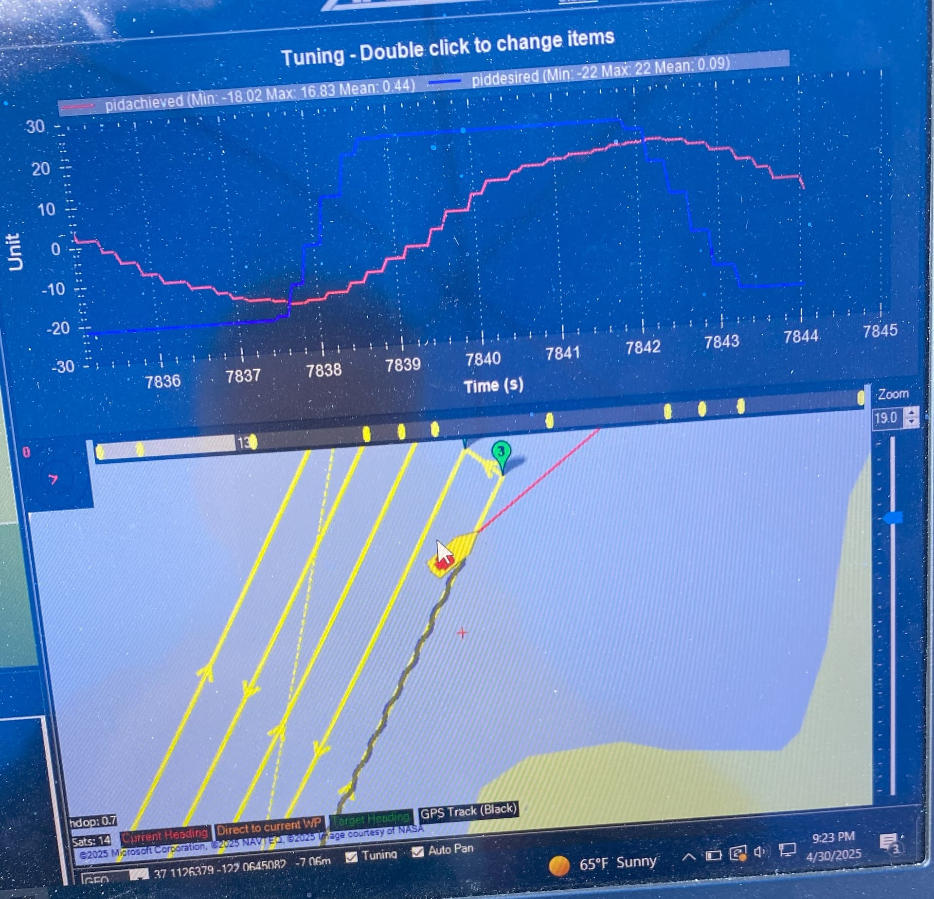

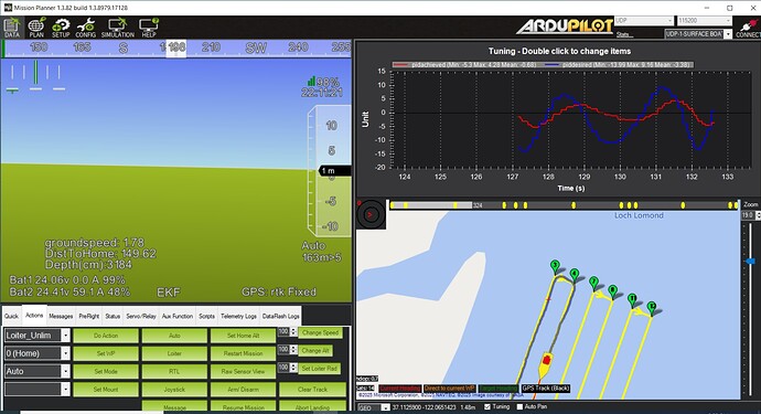

1, I was successful in getting the vehicle to autonomously navigate acceptably straight survey lines and do nice circles, screen grabs attached. However, I arrived at the tuning parameters via trial and error and don’t have confidence that they’re done correctly and thus robust for most/all weather and current conditions. I did find that setting GPS_POS1_X =-0.77 helped. I since the antenna is in-front of the cube orange I thought this should be a positive number but that made weaving return.
2, Quicktune.lua did not generate good values for this vehicle. It ran successfully and finished without error, but the vehicle still weaved unacceptably after the values were saved. - I’ve included link to a data flash log where I ran it twice in a row in case that is of interest to you.
3, I also saved a data flash log where I ran the vehicle in ACRO at two speeds as you requested. link below.
So, as I mention in 1 I’m not confident I have good numbers primarily because the pidrequested and pidachieved don’t track each other well even when line following is good. During operation I’ve got a live video stream through the herelink control from a camera pointed at the motor, and I can see that the steering motion of the motor is nice and smooth - no crazy oscillation or jerking of concern.

Start of day with weaving
After trial-and-error tune
Circle Mode
Auto LineFollowing
