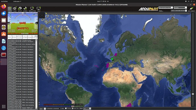

My RC is now working in ardupilot, but I don’t receive throttle output signals, and I have a lot of “failsafe warning” when disarmed, would you be able to help me for this problem?
Post the warnings you are seeing from Mission Planners messages screen.
Here screenshots of my Mission Planner screen :
None of these pictures shows the messages screen and none of them shows the failsafe warnings you were talking about earlier.
We can help you if you don’t tell us which warnings you get.
sorry ,
Those are all prearm warnings, not failsafe warnings.
Do you have a hardware safety switch on your drone?
If yes, the warning should go away when you press it.
If not, set BRD_SAFETY_DEFLT = 0
I don’t have a hardware safety switch, so I set BRD_SAFETY_DEFLT = 0, but always exactly the same message…
when I armed, this appears :
