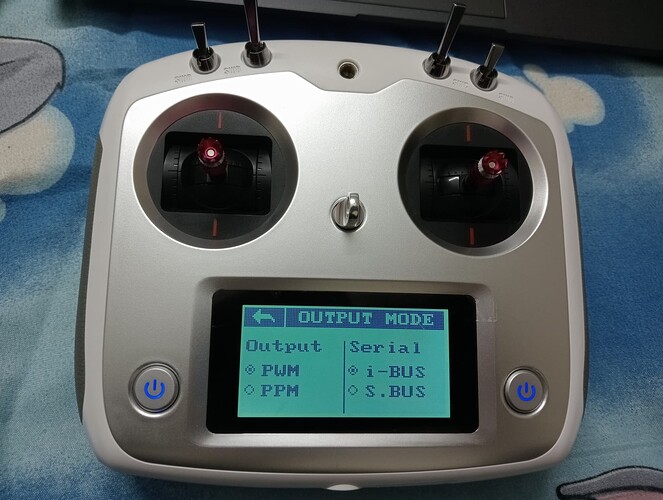

Yes I have set output to I-BUS in transmitter.as shown in attached file
but no change as shown image below
the receiver show strong red led light .shown in attached image

When there are no green bars at all in MissionPlanner radio calibration screen, then the receiver is not putting out anything at all, like it’s not even there.
You’ll have to put that setting back to S.BUS
